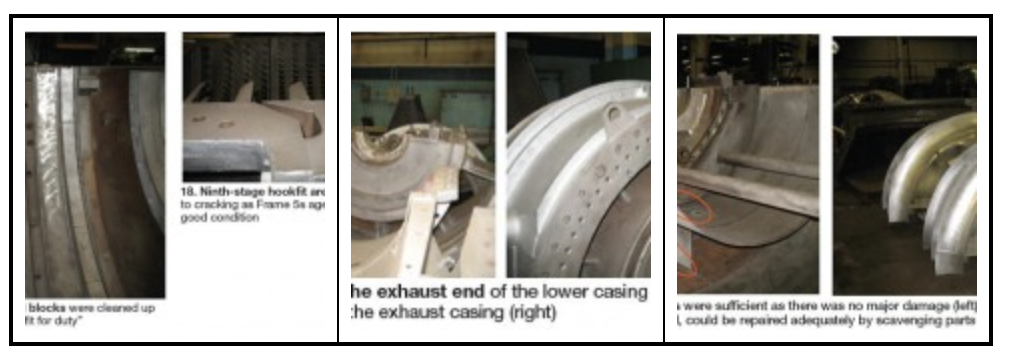

With the buckets out of the wheel, fir trees were grit blasted and inspected; no cracks were found. The second-stage turbine section, including blades, was cleaned up as-received (Figs 15, 16). The work scope was designed to accommodate the planned operating regimen (a nominal 30 annual starts and 60 run hours) at optimal cost; there would have been no commercial advantage gained by removing the R2 buckets and cleaning the fir trees as was done for R1.On the turbine end, the first-stage buckets were removed and sent to Genex for reconditioning, including repair of angel wings. Genex also repaired other hot-section parts—including liners, cans, transition pieces, first- and second-stage nozzles, second-stage diaphragms, etc.
The rabbet-fit area and faces were dressed while light machining maintained concentricity at the marriage joint to assure a proper interference fit with liquid nitrogen used to shrink the turbine end. After the reconditioned R1 buckets were installed in the wheel with new seal pins and rock was verified within OEM specs, the turbine was balanced at low speed. The turbine and compressor sections then were rejoined and, after checking runout, the complete rotor was balanced at low speed.
Turbine nozzles were in reasonably good condition; only a grit blast was necessary. Shroud blocks were removed and inspected for cracking. The blocks on the replacement engine were in much better shape than the original Ascutney machine (Fig 17). After cleaning up some dents and dings, shroud blocks were cleared for duty. The ninth-stage hook-fit area, which is prone to cracking as Frame 5s age, was in good condition (Fig 18).
General condition of the exhaust end of the unit was fair (Figs 19, 20). Several small patchwork-type repairs were required on the exhaust housing, as one would likely expect (Fig 21). A segment of the exhaust diffuser was damaged and it was repaired with a section from the original turbine (Fig 22). Journal and thrust bearings were rebabbitted and seals replaced. Shaft journals just required polishing.

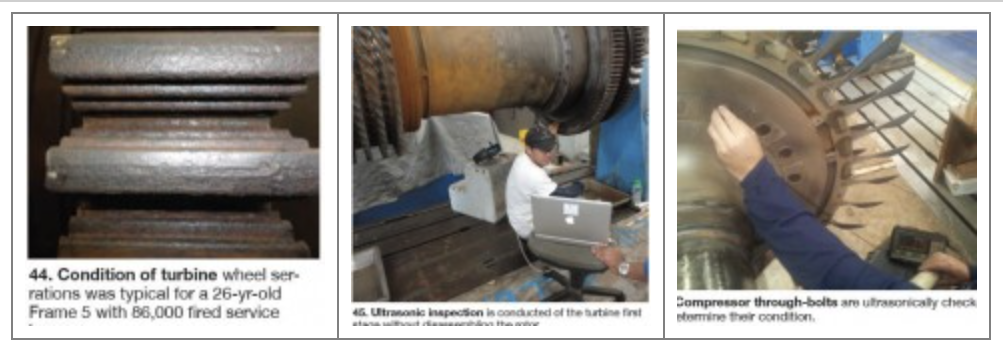

The “traveling seal” problem dictated a shop visit for this rotor, where severe rusting made removal of buckets from the wheels particularly difficult. Fleck explained that the Unionville peakers operate in a high-humidity environment and that about half of their lifetime starts had been for reliability testing.
Company procedures called for a one-hour test, mindful of fuel cost, emissions concerns, cost of personnel to conduct the tests, etc. However, an hour was not sufficient to heat-soak turbine components and the resulting moisture took its toll over the years. New procedures call for cranking each engine once in the first and third calendar quarters, and starting each once in the second and fourth quarters and running for three hours each time.

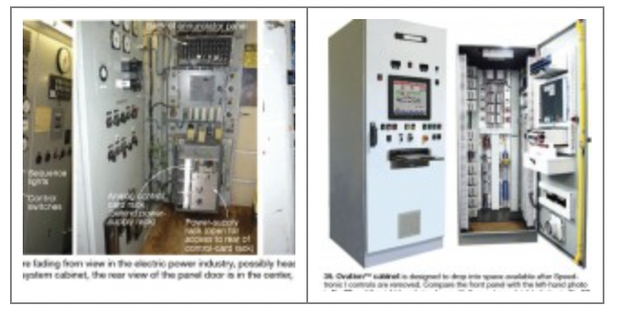

Most Frame 5s earn their keep providing black-start, emergency capacity, peaking power, and other ancillary services. One look at the heat rates associated with the various models of the MS5001 (last column in Table 1), and the fact that many of these engines built before the mid-1970s are oil only, tells you most users are not competitively bidding kilowatt-hours.
In the market segments typically served, reliability is of greatest importance and controls upgrades are viewed positively—even by parsimonious owners. They know that once in a while you have to spend a buck to assure a revenue stream. Those users interested in performance upgrades are referred to GER-4196, “Performance and Reliability Improvements for MS5001 Gas Turbines” and similar documents, available on the Web. There are far too many performance-improvement opportunities offered by the OEM to do the subject justice here.
There’s usually good reason to consider a controls replacement on virtually any “Five” that is 30 or more years old (Fig 38). It can be tough getting parts/service for fuel regulator and Speedtronic I and II systems. When the financials support a controls upgrade for your units, there are two basic options: a PLC-based system or a DCS.
After speaking with several owners, the editors learned that with control-system cost pretty much a tossup among third-party suppliers, selection comes down to schedule, the capabilities of plant personnel, and spare parts. The supervisor of a municipal plant said his city’s power and water departments shared personnel and the water infrastructure was controlled by Rockwell Automation/Allen-Bradley PLCs. With a knowledgeable labor pool already available, a DCS didn’t get serious consideration.
Another owner with several generating plants controlled by Emerson Process Management’s Ovation™ said savings in spare parts, plus having experienced technicians available on-call to service the Frame 5 peakers, supported the decision for a DCS. Yet another user told the editors that opting for a DCS provided schedule benefits.
Patrick Nolan, Emerson’s director of gas-turbine solutions and an expert with 25 years of experience in managing businesses dedicated to engineering, installing, and commissioning both PLC- and DCS-based controls upgrade solutions, told the editors the two types of systems can be installed in about the same amount of time because as much as about 90% of each application is “standard.” The remaining 10% has to do with customer preferences.
Nolan said, “Users can ensure a successful controls retrofit with relatively little upfront work at the procurement stage. Specs are relatively standard from user to user and best achieve their goals by being functionally descriptive rather than hardware-centric.” To keep the project affordable, he recommended that users resist the temptation to specify a unique solution. He advised procuring such projects on a turnkey basis to hold down costs.
