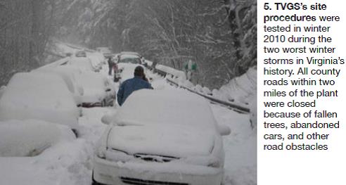

Nothing enhances employee and community relations as much as superior performance. TVGS has been challenged in recent years by brutal winter storms (Fig 5). Cold-weather preparation has therefore become part of continuous improvement. Volunteers remain onsite during bad weather events.
Staff monitors the weather and radar maps to stay ahead of an approaching storm. Food is purchased in advance and cots and bedding are stowed for emergencies. Heat tracing is monitored continuously, and the plant has added heated sheds around critical equipment exposed to freeze conditions. Staff uses the fall outage to prepare and train for winter operations. Finally, TVGS reviews all corporate fleet lessons learned, best practices, and event reports for winterization. CCJ
