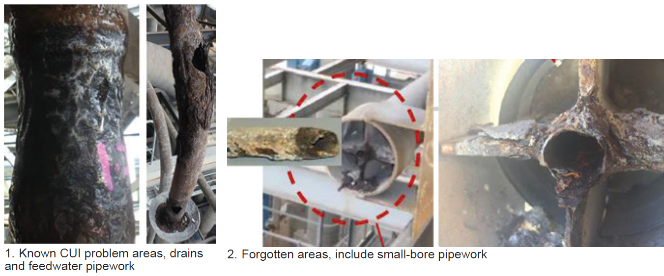

Where to look. Known problem areas are drains and feedwater pipework. Small-bore pipework was covered as a lesser-known but important area (Figs 1 and 2). Common prevention strategies include these:
