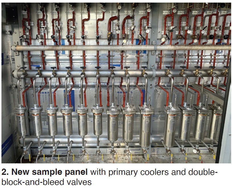

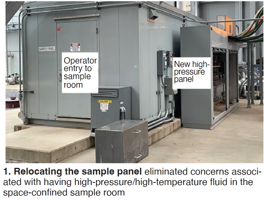

Solution. After talking through options with the sampling-panel manufacturer, it was decided to use an external panel to house the primary coolers and include a set of double-block-and-bleed isolation valves on each incoming sample line.
Moving this hazard to a remote panel located just outside the sample room (Fig 1) would eliminate the need to bring high-pressure/high-temperature fluid into the congested sampling room.
The insulated enclosure was equipped with two roll-up access doors and an electric heater for freeze protection. This option allowed locating the new panel close to the existing sample-line penetrations through the fixed enclosure, making for a quick and easy transition and allow the job scope to fit within the allotted outage window.
Results. With the primary coolers now located outside the sampling room, the temperature and pressure of samples entering the original enclosure are greatly reduced, thereby minimizing the risk to the technicians who routinely perform maintenance and take chemistry samples. The noticeably lower ambient temperature inside the enclosure provides a more favorable environment for the analyzers with the added benefit of reducing the burden on the HVAC system and giving the system a larger design margin.
The space freed-up by relocating the primary coolers has provided a much safer access to the secondary coolers and inline filters still located inside the original sample enclosure, lessening the potential for hands to get trapped and minimizing pinch points. Access to the double-block-and-bleed isolation valves in the external panel (Fig 2) has made isolating the system for repairs much safer and less time-consuming, resulting in less down time for the plant and minimizing the number of man hours involved in the LOTO process, without sacrificing the safety of technicians.

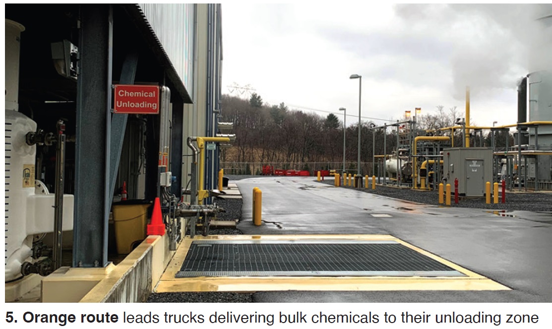

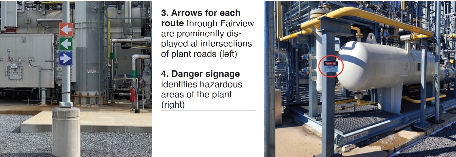

Solution. Several factors were considered when developing routes around the plant, such as which visitors most often needed guidance, and what locations were most frequented or most difficult to direct someone to. After deliberation, three of the most common routes were mapped out in color-coded fashion: Green arrows direct traffic to the main administration building’s visitor parking lot, blue arrows direct contractors to a designated contractor parking area, and orange arrows direct chemical deliveries to the chemical unloading area (Fig 3).
Additionally, areas presenting a flammable hazard are identified to warn drivers against prolonged engine idling and prohibit contractors from performing any type of hot work without a permit (Fig 4).
Results. Directional arrows and signs for each route’s destination were procured and installed along the plant’s roads (Fig 5). The signs chosen are of high-quality aluminum with a reflective surface suitable for roadway use, and visible at night. Existing lighting poles and structural columns were used as the mounting point for most signs to avoid additional posts and to maintain a cleaner look. All signs were positioned at a height which would easily be visible to drivers in personal and commercial vehicles.
This project has been an excellent aid to the CRO when giving directions to visitors at the main entrance. By instructing each visitor to simply follow the green, orange, or blue arrows to their respective destinations, the time devoted to gate communication has been greatly reduced. The well-marked and simplified routes make it easier for drivers to locate different areas of the plant, prevent miscommunication over the intercom, and negate the need to remember any potentially confusing directions after entering the plant.
