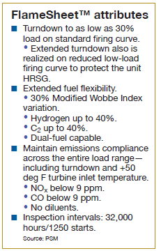

Lawrenceburg Power entered into a long-term service agreement (LTSA) with PSM in fall 2017. In March 2018, Power Block 1 was shut down to implement the first two PSM FlameTop upgrades for addressing the plant’s operational challenges. FlameTop combines PSM’s FlameSheet™ combustion system (sidebar) and GTOP3.1 (Gas Turbine Optimization Package).
Converting the block’s gas turbines from DLN2.6 to FlameSheet combustion systems increased the allowable variation in the fuel’s Modified Wobbe Index (MWI) from 10% to 30%.
The GTOP3.1 package, which includes upgraded hardware to increase compressor flow and reduce combustor pressure drop as well as the amount of turbine cooling and leakage air required, was installed on each GT to improve performance.
FlameTop mode switching logic and AutoTune also were incorporated so the plant could both maximize peak-fire capability and achieve the desired 32,000-hr maintenance interval. PSM AutoTune provides real-time tuning of the gas turbine fuel splits to maintain stable combustion dynamics while managing gas turbine NOx production throughout the plant’s dynamic Ohio River Valley weather patterns.
