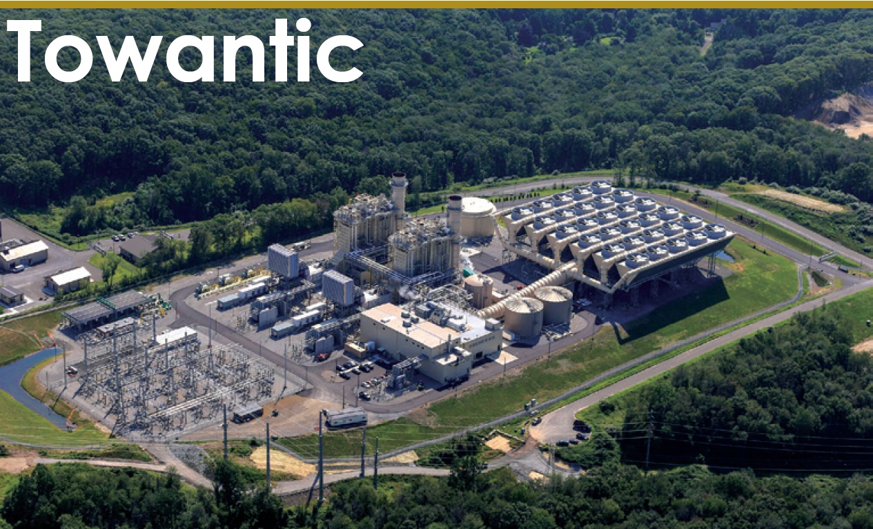

CPV Towantic Energy Center
Owned by Competitive Power Ventures
805-MW, gas-fired 2 × 1 7HA.01-powered combined cycle is equipped with DLN2.6+ AFS combustion systems, located in Oxford, Conn.

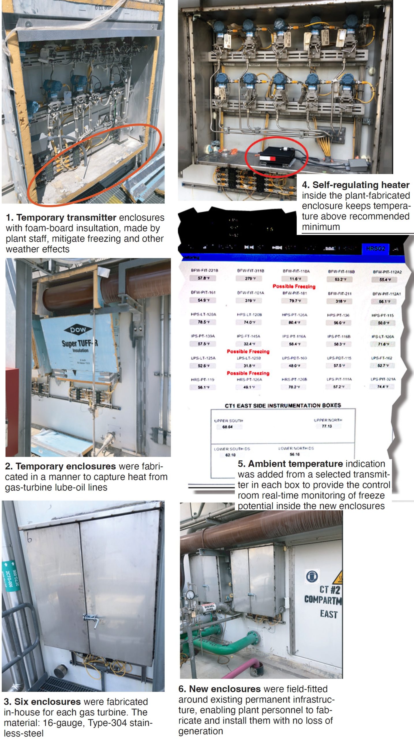

Challenge. The OEM-supplied turbine enclosures at this outdoor facility left critical gas-turbine transmitters exposed to ambient conditions without heat tracing, weather guarding, or insulation.
Towantic experienced trips attributed to instrumentation freeze-up and quickly put in place a foam-board insulation “stop gap” to help protect the transmitters (Fig 1). Temporary heat tracing also was installed as part of this impromptu freeze-protection effort. Insulation and heat tracing addressed most concerns, but equipment still was susceptible to the colder “polar vortex” days that the site might experience.
Several other improvements also were proposed and implemented to mitigate the effects of cold weather—such as capturing heat radiated from gas-turbine lube-oil lines (Fig 2).
Solution. Plant personnel wanted a more-permanent freeze-protection solution and invited several vendors to walk down the gas-turbine enclosures and share their expertise. But staff soon realized that an ideal solution was not available on the market, or at least for reasonable cost. Internal discussions resulted in a custom-designed, fabricated, and installed set of enclosures proposed by Plant Mechanic Brian Kennedy.
Having previously completed similar projects, Kennedy explained his design and provided a list of materials and tools needed to complete the project. The three-sided enclosures installed are of a shelled design consisting of 16-gauge, Type-304 stainless-steel inner and outer shell walls with a high-temperature polyisocyanurate insulation embedded between them (Fig 3).
The stainless-steel walls were bent using purchased tooling and insulation was placed between the walls and stitch-welded along the seam to create an effective weather-tight barrier. The new enclosures also feature weather-sealed double doors of the same design for access to the transmitters and self-regulated heaters (Fig 4) specified and installed by IC&E Technician Matthew Trafficante. This design also allowed field fabrication for bulkhead penetrations and installation to be done without interrupting generation. The enclosures require no painting or maintenance.
Finally, the ambient indications available on the transmitters protected by these new enclosures were added to the DCS screens in the control room, thereby allowing remote monitoring (Fig 5). An alarm alerts the CRO when further attention is needed—such as when a heater fails.
Results. Towantic has eliminated, or severely reduced, the possibility of lost generation and equipment damage caused by transmitter freeze-up and other weather-related complications. Enclosures were installed for the cost of materials only (Fig 6) while the units were online (no downtime required). This amounts to a six-figure saving compared to the alternative of contracting out the project to a third party.

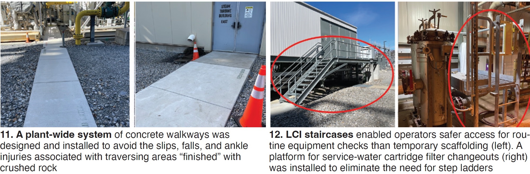

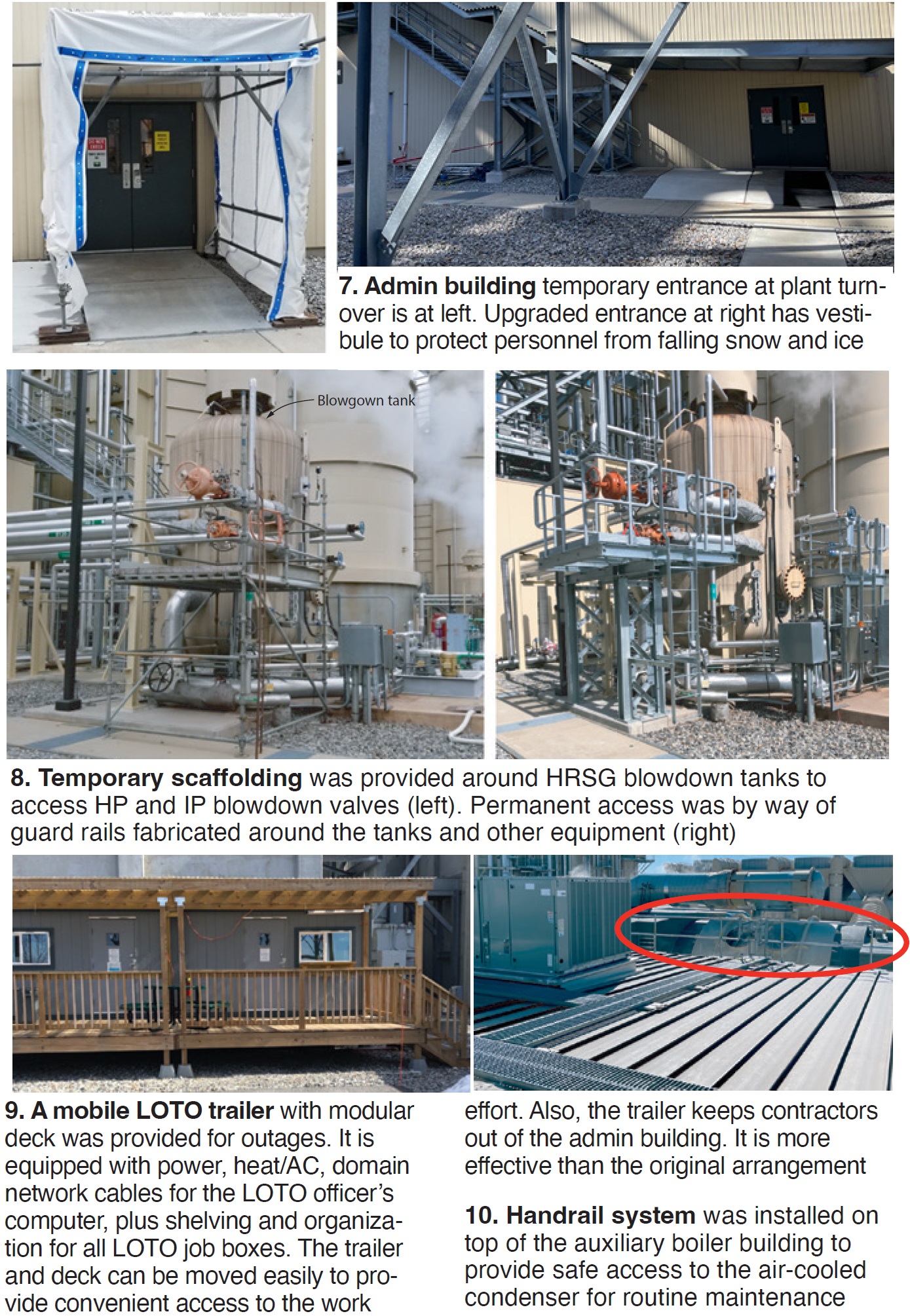

Challenge. Final plant design/construction upon turnover to the Towantic O&M team lacked capital infrastructure platforms, ladders, enclosures, etc. This required the erection of scaffolding to serve as “temporary” enclosures and platforms to perform routine plant operations.
While not ideal with respect to performance and safety, scaffolding also is costly to retain onsite and maintain its certification. Plant personnel have been very careful working around the temporary scaffolding and there have been no injuries or OSHA recordables since commissioning. However, the possibility remains.
Solution. Plant management and Towantic’s owners developed a prioritized capital improvements list to address the lack of infrastructure and the safety/operational concerns it creates. Owners have set aside money for capital investments every year since commissioning to complete permanent projects for safer and more reliable operations. Management works through the agreed upon capital-improvements list, completing projects through a prioritized and fiscally responsible program annually.
This list includes 27 identified areas that could benefit from capital improvements; the list is a living document undergoing continual updating both by the owners and plant management. To date, a dozen of the 27 areas identified for capital investments have been addressed.
Thumbnails of several projects completed through calendar year 2022 are described in Figs 7-12.
Results. CPV Towantic has eliminated safety concerns through engineering and installation of permanent structures, while simultaneously improving O&M reliability. This initiative continues as areas recommended for improvement are identified.
