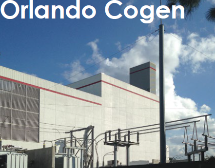

Orlando Cogeneration Ltd
Owned by Northern Star Generation Services
120-MW, dual-fuel, 1 × 1 combined-cycle cogeneration facility located in Orlando, Fla.
Plant manager: Jim Murray
