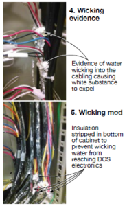

Preventive damage measures for water-wicking cables
Best Practices Award
Challenge. Plant’s underground conduit is in continuous contact with water because the plant is only 75-ft above sea level. With rainfall averaging more than 40 in. annually, the conduit remains submerged.
While investigating a faulty transmitter, the 4-20-mA terminal block (HART) cover was removed and several tablespoons of water came out of the terminal housing. The terminal block was shorted out and destroyed because of the standing water inside the transmitter cover. Staff tried to find the source of the water intrusion. It was thought rainwater might be getting into the conduit. That was ruled out by completely sealing the conduit and the transmitter housing.
The issue recurred on occasion, each time the 4-20-mA terminal block shorted out or the housing held water. There was no source for the water intrusion other than the cable itself.
It was decided to open up the closest conduit cover to the transmitter and cut a piece of the insulation back; water came out of the insulation proving that we had a wicking issue. Also witnessed was cable wicking in a few of the DCS system cabinets. The cabling in the cabinets seeped out a sticky white residue which covered the cables and the surrounding area (Fig 4).
Realizing this issue could eventually create a reliability problem, a proactive approach was employed to address conduit runs with known water intrusion. Drawings were used to research potential risk areas. In doing so we found several transmitters having the same wicking issue. Some of them had damaged terminal boards.
Solution. The solution led to removing the cable from the conduit at the transmitter and stripping back a six-in. section of the cable insulation a few feet from the transmitter. The cable end leading to the transmitter also was taped securely to prevent any further wicking (Fig 5). The cable was then placed back into the conduit. Where locations would allow, the conduits were modified with drains to protect against standing water.
The same cable procedure was used on the DCS system cabinets to prevent the sticky seepage from covering or damaging equipment. The cables were stripped of the insulation inside of the cabinet at floor level allowing the seepage to occur below the termination points and modules.
Results. Being proactive has prevented damage to the terminal boards on the transmitters leading to increased reliability. This measure has also prevented damage from occurring on the DCS system cabinet and modules.
