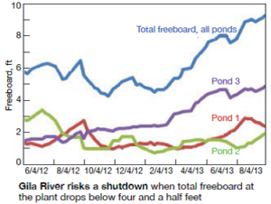

When the ZLD plant is offline, process water is discharged directly to the evaporation ponds. In 2012, the amount of water discharged to the ponds was so high that there were periods when there was less than 4.5 ft of vertical space available to hold water (so-called freeboard). Without adequate space to discharge the water during a ZLD upset or maintenance, the facility risked a forced shutdown (figure).

Results. The various projects greatly improved the facility’s ability to manage its water. The positive results are reflected by the dramatic increase in freeboard during 2013 as shown in the chart. Here’s what was achieved:
