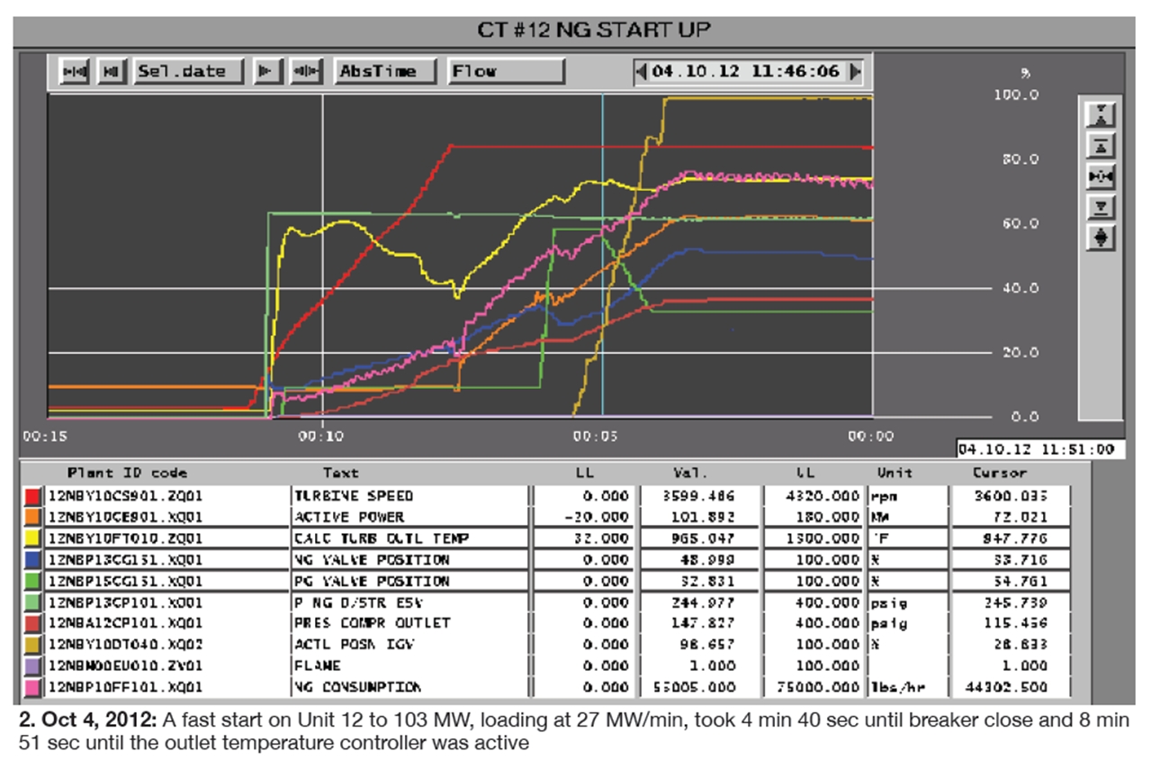

Results. Before the fast-start modification, the Holden units were AECI’s fastest starting units at 15 minutes from beginning of start to full load. Full-load start time was reduced by an average of 6 minutes to an approximate 9-min full-load start time. More specifically:
Unit 11: 8 min 59 sec (6 min 17 sec improvement).
Unit 12: 8 min 51 sec (5 min 3 sec improvement). See Figs 1, 2.
Unit 13: 9 min 19 sec (6 min 45 sec improvement).

• Base load for fast-start testing was 103 MW; normal ramp rate was 10 MW/min, fast-start rate 27 MW/min. The ramp rate is selectable by system operators via the RTU interface.
• The fast-ramp rate applies only to fuel-gas starts; ramp rate on fuel oil remains unchanged at 10 MW/min.
• Faster start times were achieved only through logic and tuning changes. There were no physical modifications to the equipment.
