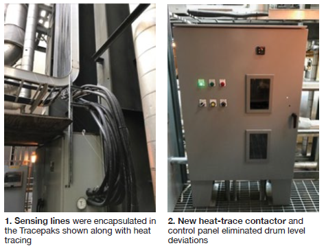

Drums for the HRSGs are located 100 ft above the level transmitters; sensing lines run down the boilers into heated cabinets where nine drum-level transmitters are located. Because of the length of the sensing lines and change in water density, any difference in temperature between a variable leg and reference leg causes an inaccurate drum-level reading.
The sensing lines were run in Tracepaks—the product name for an insulated, weatherproof jacket offered by one manufacturer—with their heat tracing controlled by resistance temperature detectors (Fig 1). The RTDs provided input to a heat-trace panel that would turn the Tracepak bundles on and off. If the RTD did not turn off the reference and variable legs of each transmitter at exactly the same time, drum levels would deviate because of the temperature difference.

Plant personnel believed the drum-level heat-trace system had become too complicated. They decided to simplify it by using a single contactor operating by ambient temperature via the plant’s DCS (Fig 2) to ensure all drum-level heat tracing was turned on and off at exactly the same moment, thereby eliminating temperature deviations among the sensor lines.
Using the DCS allowed staff to build logic into the control system that would factor in run status and ambient temperature. The solution ensures that the heat tracing operates only when necessary and also alerts operators with an alarm if the contactor is not energized when the heat tracing should be in operation.
Success! The heat-tracing contactor and control logic were installed in October 2015. Since then, the plant, owned by Talen Energy and operated by NAES Corp, has experienced no unscheduled call-ins, de-rates, or forced outages related to drum-level heat tracing. Plus, drum levels across all units—whether running or shut down—are consistent.

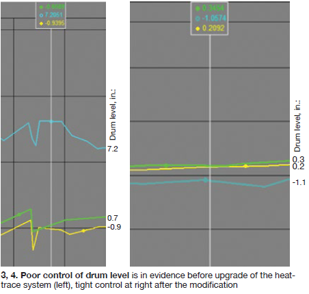

Fig 3 shows drum-level deviation before the new system was installed. One channel indicates 7.2 in., the other two approximately minus 1 in. Ambient temperature was about 30F. As shown in Fig 4, drum levels following system reconfiguration ranged from plus 1 to minus 1 in. at an ambient temperature of about 25F. CCJ
