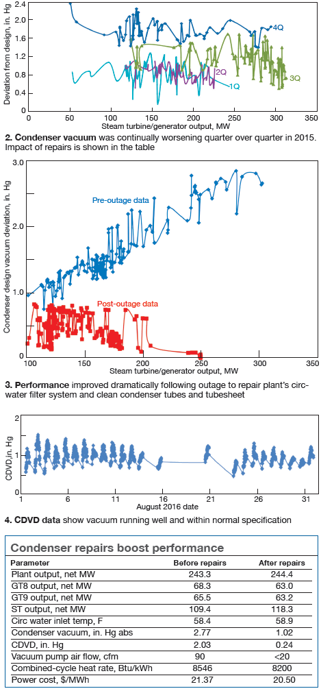

The condenser heat duty presented on the abscissa of the design curves is proportional to steam turbine/generator (ST) output. The performance improvement team’s first step in developing a practical operational metric was to convert the heat duty on the x-axis to applicable ST output values in megawatts. The curves then were converted to mathematical formulas that could be programmed into the plant’s distributed control system (DCS).
The DCS can interpolate between the discrete curves to allow analysis at any CW inlet temperature. By inputting the actual ST output and CW inlet temperature into the appropriate formula, an as-designed condenser vacuum can be calculated. This then can be compared to the actual vacuum.
The difference from actual to design is called the condenser design vacuum deviation (CDVD). As a DCS-generated value, CDVD can be used by operators to gauge condenser efficiency in real time during both steady-state and transient operations.
In addition, the CDVD can be logged in the plant data historian to trend condenser performance. This can be used by maintenance team members to determine loss of condenser performance, or restoration of performance post-maintenance.
The performance-improvement team cited several instances of CDVD being used for determining vacuum leakage problems. They are:
Case 1. During 2015, condenser vacuum continually deteriorated. Given the long timeframe, cycling operation, and varying CW temperatures, the deviation was suspected, but not verified. When CDVD was graphed on a quarterly basis, the movement away from design was easy to see (Fig 2). Corrective action was taken and performance improved dramatically (table).
Case 2. Prior to the fall 2016 outage, the plant’s CW filtering system failed. The decision was made to continue operating until the scheduled outage. During the outage, significant resources were expended to restore the CW filtration system to good condition, as well as to clean the condenser tubes and tubesheet. Before and after CDVD values are shown in Fig 3.
Case 3. During a summer run, operations staff thought condenser vacuum was running high. An analysis of CDVD data showed vacuum was running well within normal specification and there was no increase in CDVD (Fig 4). This precluded chasing a non-existent vacuum issue.
