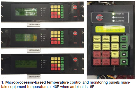

Heat tracing was designed to maintain an equipment temperature of 40F at an ambient of -8F. The heat-trace supplier implemented the use of microprocessor-based temperature control and monitoring panels (Fig 1) which required other new equipment—including various temperature sensors, new alarm capability, DCS integration, self-testing circuit cards, and programmable RTD outputs.
The lack of qualified oversite from the heat-trace designer during equipment installation and in preparing documentation of as-built conditions proved challenging for the plant operator once it took possession of the facility.
First step in fixing the problem was to bring back the original heat-trace designer to audit the entire system and identify and correct any deficiencies. This required all 612 individual circuits to be reviewed to ensure the correct materials were used along with the correct installation practices. Next, all the documentation was updated to reflect as-built conditions. This information and a thorough review ensured the system was designed and installed as originally intended.
With the proper installation and operational techniques identified for the new technology, the plant operator developed a heat-trace guide to provide a laymen’s approach to better understanding of equipment and operational requirements. In the guide, details which had been segregated because of scope breaks are included in one location, eliminating the need for multiple sources of documentation. The guide is written in plain language and includes pictures of installed equipment to better acclimate the reader and facilitate troubleshooting.

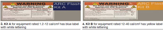

The first step in reducing the confusion regarding the hazard ratings was to ensure the site arc-flash safety procedure included easily understood PPE classifications. Following NFPA 70E-2015, site personnel aligned the plant’s arc-flash PPE with these three incident-energy levels: 0-1.2, 1.2-12, and 12-40 cal/cm2. For the 0-1.2 cal/cm2 range the company determined arc-rated uniforms and arc-rated face shield (as necessary) would be required and made them available.
For the higher incident-energy levels, separate kits were created for each arc-flash level and included all of the properly rated PPE in sizes large and extra-large. The kits are contained in a clear storage bin stored in a designated location at the site and are labeled to reflect the arc flash rating and designation by color and letter (Fig 2). The color code and letter designation labels also are applied to each piece of power distribution equipment adjacent the NFPA 70e label. Specifically:
  • Equipment rated <1.2 cal/cm2 is identified with a green label having white lettering stating, “Arc Rated Uniform.”
  • Equipment rated 1.2-12 cal/cm2 has a blue label with white lettering (Fig 3) stating, “Arc Flash Kit A.”
  • Equipment rated 12-40 cal/cm2 has a yellow label with white lettering (Fig 4) stating, “Arc Flash Kit B.”
These same labels then were placed on the outside of the clear storage bins containing the corresponding PPE. Note: Equipment rated >40 cal/cm2 has a red label with white lettering stating, “No Energized Work Permitted.”
Safety made easy. Site personnel now can walk up to a piece of power distribution equipment and easily identify the hazards and proper PPE required to perform energized work, greatly reducing the risk of incorrectly determining the required PPE. In addition to significant increases in arc-flash safety, this best practice has reduced the time required to evaluate energized work requirements—from hours to minutes. Man-hour reductions could save $150,000 over the life of the facility.

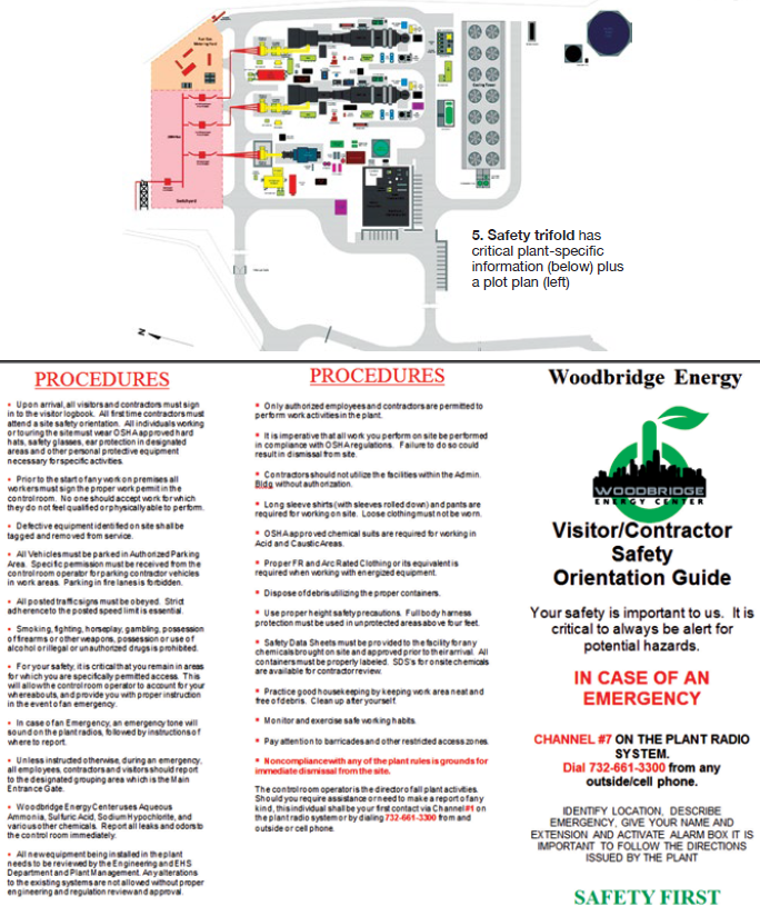

Combined-cycle outages require a large skilled workforce to complete a substantial amount of work in a short period of time. It is not uncommon to have over 150 contractor personnel working during a major outage, increasing the risk of a safety or environmental incident.
To mitigate this risk, all contractors are required to participate in an onsite safety orientation prior to beginning work.
This orientation covers the site safety and environmental requirements and procedures along with all of the applicable plant policies. Most contractors participate in dozens of site-specific orientations per year so keeping track of which policy/procedure applies to the current worksite is nearly impossible. Additionally, contractors may have little knowledge of the equipment and processes they are working on, and may be expected to carry out tasks that are not routine for them.
After the relatively short orientation, contractors are expected to recall vital safety information including evacuation locations, emergency contacts, locations of equipment, and hazards. Tall order.
So Woodbridge personnel developed a contractor safety orientation trifold pamphlet (Fig 5). Upon completion of orientation, each contractor receives a hard-hat sticker and a copy of the pamphlet, which they are required to have on their person when onsite. The sticker tells plant personnel who should have copy of the trifold.
The trifold, printed on durable cardstock material, includes critical plant-specific information—including emergency phone contacts, plant radio system channel, what to do in the event an emergency, summary of safety policies and procedures, and a plant plot plan that identifies contractor parking, smoking areas, restrooms, and the evacuation muster point, plus major plant equipment.
The safety trifold was inexpensive (less than $350) and has provided immediate results in improved awareness and safety culture. To date, the plant has not experienced a safety or environmental incident attributable to contractor personnel. The trifold makes critical safety information presented during contractor orientation accessible at all times. CCJ
