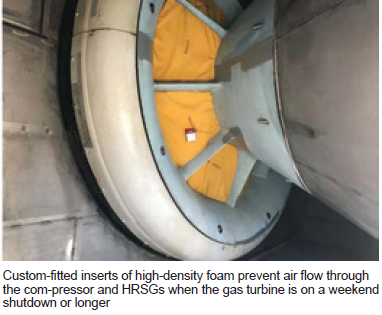

Foam inserts prevent air flow through offline gas turbines
When gas turbines (GT) are shut down for extended periods in Georgia, the high humidity and natural draft through the HRSGs creates problematic condensation on tube fins. Rusting occurs, especially when water is still present in the tubes. Ultimately, excessive tube fin rust creates a resistance to exhaust flow through the HRSG and GT back pressure increases, reducing turbine output.
The staff at Effingham County Power, a 2 × 1 F-class combined cycle managed by Nick Bohl, investigated adding stack dampers, duct balloons, and compressor inlet foam inserts to minimize air flow through the HRSGs. The most effective option would have been stack dampers, but their upfront and ongoing maintenance costs were significantly higher than those for the alternatives. The duct balloon was an interesting and feasible option; however, the time and manpower required for balloon deployment and removal militated against its selection here.
The most economical and effective solution for Effingham, which is owned by The Carlyle Group and operated by Cogentrix: High-density, custom-fitted foam inserts (photo), which prevent air flow through the compressors and HRSGs. Cost of the inserts for both turbines was under $9000; no maintenance is associated with this application.
The inserts were labelled for each unit for inventory purposes. A LOTO is placed on the unit when the inserts are installed to ensure accountability. Once the inserts are removed and counted, a shift supervisor performs a close-out inspection of the GT inlet.
Results from using the inserts are impressive: GT wheel-space temperatures remain above 150F 90% longer using the inserts versus not installing them for a weekend shutdown. Also, HRSG internal temperatures remain above 100F 40% longer with the inserts.
The trapped heat helps minimize condensation on HRSG piping and components. Once the HRSG temperatures are low enough and a dispatch is not expected, the HRSGs are drained. This practice is expected to help reduce corrosion and minimize performance issues.
Installing inserts on Friday following a shutdown saves fuel and increases revenue by allowing faster ramping when the units are restarted on Monday. This is based on less time needed to warm components and quicker steam formation because HRSG drums and piping retain heat longer.
