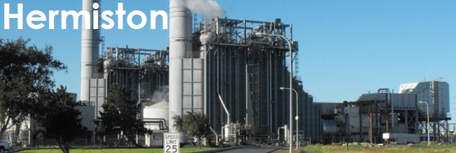

Strategic independent power producers (IPPs), such as Hermiston Generating Plant (HGP)—a 2 × 1 F-class combined cycle owned by Perennial Power Holdings and PacifiCorp—want to strike a balance between short-term return and long-term sustainability, while keeping critical infrastructure in a healthy condition. Given parent company support, the greatest impact on returns managed at the plant level is major maintenance. Developing a major maintenance strategy that positively impacted fixed costs was the challenge at HGP.
Shortly after the plant’s LTSA expired with the OEM in 2016, the plant experienced a combustion issue in one of its two gas turbines. A borescope inspection revealed damaged diffusers on several fuel nozzles. The plant management team, led by PM Brad Knight contracted a third-party technical advisor (TA) to assess the issue. Because of time constraints, management decided to “self-perform” the outage. Nine fuel-nozzle assemblies were replaced in three shifts using four O&M technicians under the guidance of a TA.

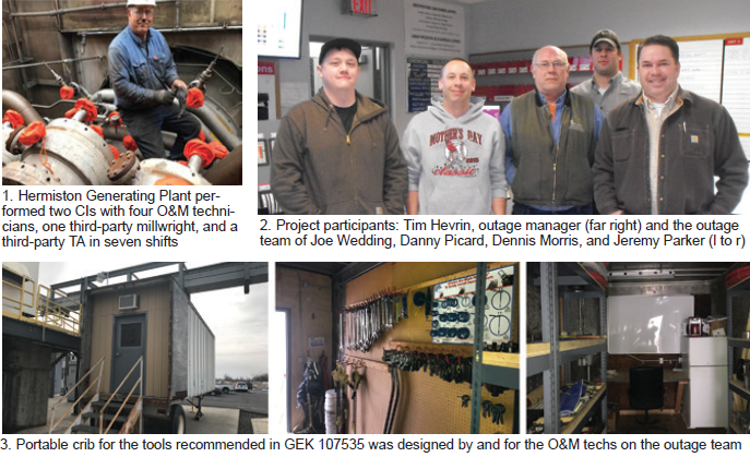

Cost. Combustion-inspection costs vary among vendors—ranging from about $140k to $170k each (not including the cost of hardware, consumables, or parts refurbishment). Note that no crane costs are incurred at HGP because the plant was constructed with overhead cranes. HGP performed two CIs with four O&M technicians, one third-party millwright, and a third-party TA in seven shifts at a cost of $51k per CI (Fig 1). Plant realized a median cost saving of $114k per CI.

Experience. HGP has a tenured staff with very little turnover. Combustion inspections are performed every 8000 to 8800 operating hours. During outages, all O&M technicians are assigned to the maintenance department (with the exception of two control room operators). A select group of O&M techs were permanently assigned to the outage team, which meets regularly to discuss ways to mitigate risk and improve overall outage performance (Fig 2).

Tooling. HGP constructed a portable crib for the tools recommended in GEK 107535 . The trailer, designed by and for the O&M techs on the outage team, is equipped with tooling, consumable parts, office space, and break amenities (Fig 3). It is staged adjacent to the turbine compartment during outages.
