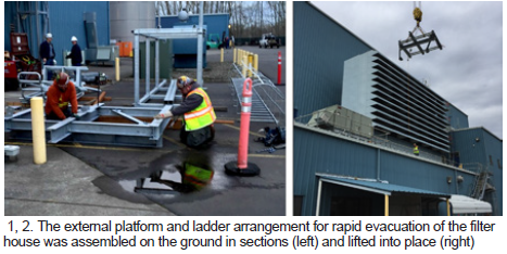

The challenge was to determine the best method of egress, taking into consideration the limitations presented by the existing structure—including office space directly below the filter house. The entire RRGP team was involved in brainstorming sessions. Some ideas were rejected outright because of code or practicality considerations—including emergency zip lines and doorways on each platform with access to a “fire pole”.

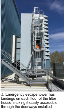

The decision was made to proceed with a project that included cutting doorways at each level, plus an external platform and ladder arrangement in combination with an intumescent coating on the interior wall and doors of the filter house. The challenge was designing and building a structure to suit the plant’s safety needs while designing around existing structures below the filter house (Figs 1 and 2).
Following an extensive fire safety code and structural engineering analysis, a custom emergency egress was designed, pre-fabricated, assembled, and installed (Fig 3). This reduced the personnel concern regarding rapid egress. The retrofit external platform and ladder assembly eliminated the safety hazard of the internal “trap door and ladder” access system supplied with the original filter house.
