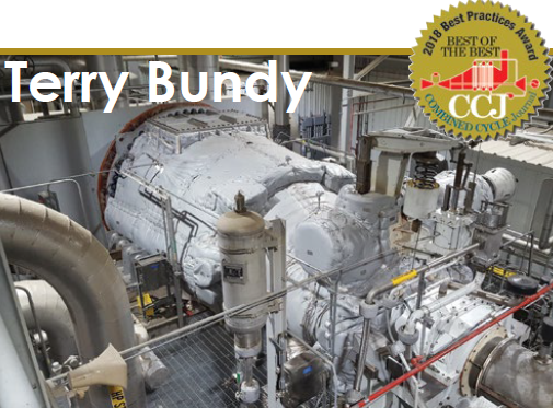

Project scope covered the evaluation of mechanical modifications to the turbine rotor and installing a turbine rotor/case heating system to allow the unit to remain in hot standby mode for multiple days after coming offline. The overall goal was to improve unit operating economics and reduce the equivalent operating hours associated with cold starts, thereby cutting maintenance costs by extending the interval between major inspections. Rotor mods reduced the original cold-start EOH penalty from 530 to 235 EOH.
The turbine modifications included machining the rotor ends to increase case clearance, modifying the blade root configuration, changing the geometry of the thermal relief groove, and installing upgraded blades. The heating system maintains the steam-chest temperature at 650F, further reducing the EOH penalty for a start to 36 EOH.
A key requirement of the project was designing a monitoring system to estimate rotor temperature. The main challenge here was that the dual-case design of the turbine made it difficult to accurately measure turbine temperature. Working with the turbine OEM, seven additional thermocouples were installed in the turbine-case HP and IP sections, including one which extended into an HP inner-case structure.
This allowed the system to assign the correct EOH factor for hot (644F and above), warm (266F to 644F), and cold starts (less than 266F) based on actual rotor condition. The original EOH factor system used the amount of time since shutdown to determine which factor to apply to the next start.
The heating system, designed to bring the turbine from a cold condition to 260F using approximately 2067 kWh of energy, consists of 19 heating-blanket zones that are sequenced on and off depending on measured case/rotor temperature and time since the unit was taken offline.
The zones are sequenced to maintain the turbine at 675F from the time the steam turbine is taken offline until 96 hours have passed. It then lowers the maintenance temperature to 575F for the next 72 hours. Finally, the system holds the turbine at 375F for 48 hours before allowing the temperature to decay to ambient.
