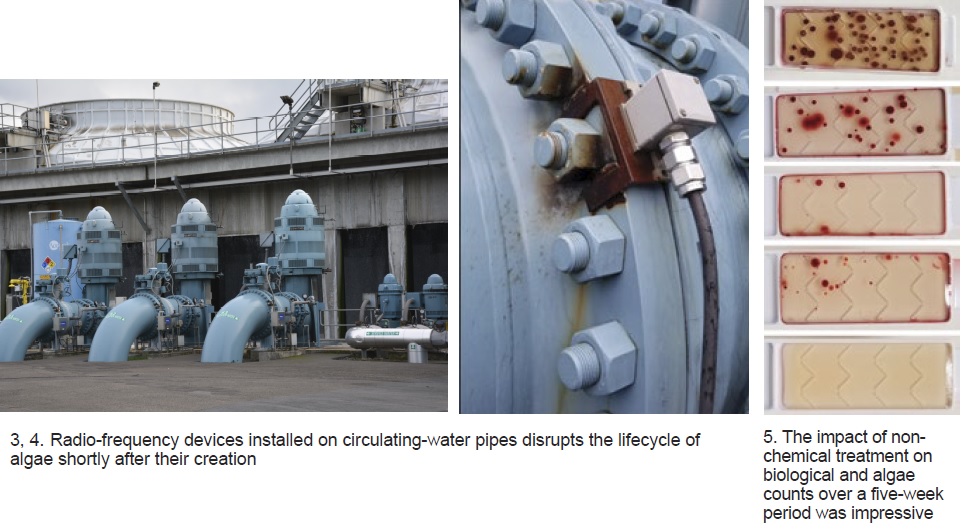

During the search for a solution, staff located a company, Flow-Tech Industrial Water Treatment Systems, Milwaukee, Wis, that had developed a product used in small-to-medium size HVAC applications for many years, with well-documented success.
The vendor proposed creating and using its patented non-chemical devices on an industrial scale at River Road. The relatively small components are mounted on circulating- and service-water system pipe flanges in strategic locations (Figs 4, 5). Each unit transmits AM radio frequency into the water systems and cooling tower basin.
The theory of design is that the radio frequency disrupts the lifecycle of the algae in its single-cell haploidic form and kills it, before it forms viable colonies. Plant personnel worked with the vendor to develop and implement an industrial-scale test plan for the devices at River Road.
Use of the new devices has measurably reduced the plant’s biological and algae count within the cooling tower (Fig 6). Chemical treatment has been reduced to an algaecide injection once every three weeks rather than every other day. Plant Manager Robert Mash identified the following benefits of the new program:

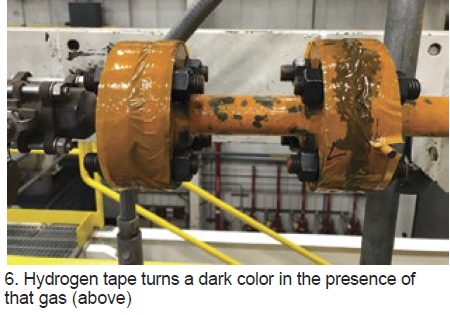

Hydrogen-detection flange tape promotes safety, facilitates leak detection at River Road
Following each generator maintenance activity at Clark Public Utilities’ River Road Generating Plant, the system supplying the machine with hydrogen for cooling was restored and leak-checked using a soapy water product that bubbled or foamed if a leak existed.
A plant employee who attended the 2019 conference of the 7F Users Group saw a demonstration by Nitto Inc, Teaneck, NJ, promoting a pipe flange tape that changes color in the presence of hydrogen. Thus, it provides a visual indication of a leak because it will not return to its original color once hydrogen gas flow is stopped. Even though a soap test indicated no leaks, the staff thought it would be a good practice to use the color-changing tape.
The team member presented this idea as a proactive safety practice to the safety committee. The tape was purchased and installed on every hydrogen flange (Fig 6). Leaks were found, notes Plant Manager Robert Mash.
Thirty-eight flanges were taped. All had been soap-checked prior to using the tape. Once installed, four flanges changed color within two days. Where leaks were indicated, tape was removed from the flanges, and the joints were soap-checked again. Only one of the leaks was large enough to cause bubbling visible to the eye.
The hydrogen-detection flange tape worked well as a pre-emptive safety check and has stimulated proactive thinking about previously unrecognized problems. This fits in well with the long-established plant safety culture at this VPP Star site. Use of the tape is now part of the hydrogen-system restoration procedure.
