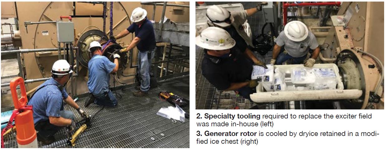

Upon reviewing the Kato documentation, drawings, and specialty tooling requirements, GCE’s maintenance, IC&E, and operations teams were confident this was a task they could perform onsite. After careful review with plant management, the owners (J-Power USA), and the NAES engineering department, GCE opted to manufacture its own specialty tooling for exciter-field removal and installation. This in-house-produced tooling (Fig 2), together with unique work processes, allowed plant personnel to remove the rotating field in less time than possible with a vendor-supported effort.

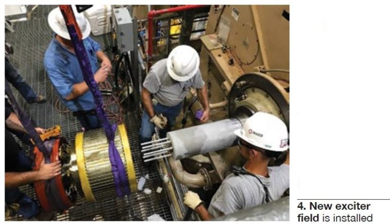

Upon receiving the new exciter from the partnering facility, technicians verified its fit to the generator rotor and devised a system to shrink the rotor while expanding the exciter field. This enabled an appropriate “slip-fit” of the exciter field on the generator rotor.
Technicians retrofitted a very large ice chest to hold both the generator rotor end and dry ice to facilitate fit-up (Fig 3). The rotor was left on ice for around six hours. During rotor icing, the exciter field was heated with an external source. Technicians finalized the fabrication of an installation plate and extended deep sockets needed for the all-thread that was used for pressing the exciter field onto generator rotor.
Results. A successful exciter-field replacement (Fig 4) was performed completely in-house in a relatively short period of time. In-house technical skills together with support from owner J-Power USA, operator NAES, and GCE management enabled timely project completion. The GCE team came together with a “We’ve got this” attitude and was able to gather the information needed through manuals, drawings, and collaboration with other facilities to fabricate everything required to remove and reinstall the exciter field.

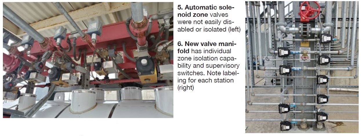

While addition of CO2 fire suppression in the exciter and load compartments provided needed protection against fire, bringing the extinguishing systems up to NFPA 12-2018 standards required manual isolation valves with supervisory indication for each zone. These valves were not installed at GCE because system isolation was not standard practice except in times of unit outages and individual zone isolation was not something that could be done easily (Fig 5).

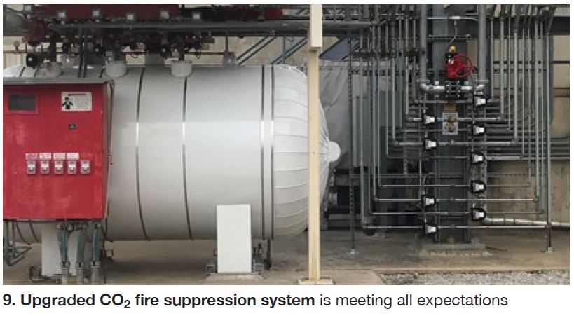

Solution. In 2019, GCE completed all GT CO2 fire suppression upgrades. The upgrades consist of CO2 manifolds with manual isolation valves for both initial and extended discharges to each zone (Fig 6). Valve supervisory switches also are used for remote valve position indication. Addition of manual isolation valves and supervisory switches, brought GCE’s CO2 fire suppression system up to current NFPA standards.
Labeling was added to the valves and piping to ensure correct zone isolation when used. Technicians can now easily isolate one zone (five total) without sacrificing the protection to other critical gas-turbine areas. Although not required by NFPA on systems with audible/visual alarms, odorizers were used in the high-exposure areas of the exciter and load compartments (Fig 7). Signage also was upgraded to current NFPA standards (Fig 8).
In addition to the equipment upgrades, a standard operating procedure was developed for all employees. The SOP does not replace tasks that would require a LOTO, but covers entries for readings and inspection. The procedure includes control room notification for isolation, restoration, and logging requirements.
Results. The system and procedure have only been in place a short time but are working extremely well (Fig 9). The valve manifold allows for effective and easy isolation of fire protection zones. Technicians are now safely entering exciter compartments daily for readings and inspections. Although used daily for exciter compartments, this same process allows for quick access to accessory modules and gas compartments.
