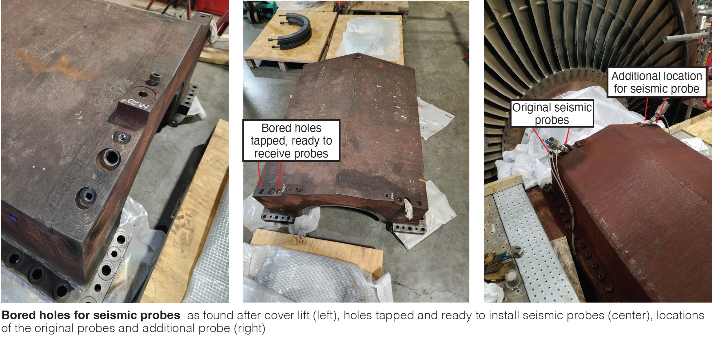

Challenge. New Athens Generating has had issues in the past with vibration readings on the steam turbine’s (ST) MAD11 bearing. The seismic probes on MAD11 are under the turbine’s cover, so the only way to access them is to do a complete cover lift and change out the probes, which is neither quick nor easy; not to mention the down time costs and cost of repair.
Solution. During a major overhaul of the Unit 3 E steamer (a/k/a Siemens/Westinghouse IP/LP turbine), Athens personnel investigated the location of the seismic probes and noticed bored holes next to the existing probes. Staff decided to tap the existing bored holes and order four new seismic probes—two to replace the run-time probes and two to install in the bored holes once they were tapped.
The plan was reflected in a Management of Change (MOC) documentation and reviewed and approved accordingly. The MOC was to be implemented on ST1, which was next in line for a major overhaul.
The new probes were installed during the major overhaul on Unit 1 in accordance with the plan. The additional probes were wired to the Bently rack with the use of an additional 42M card, and the Bently was programmed to accept the new points. In the logic for the ST, the additional probes’ feedback will only be used as a readout, and not in the trip schematic. The probes are used strictly as a backup in case a sensor fails; the logic remained that two seismic exceedances will cause a trip.
Results. By installing the new probes, Athens removed a single-point-of-failure concern and the risk of having to force points if a probe goes erratic from a faulty signal. Plan is to implement the same solution on Units 2 and 3 the next time there is a cover-lift/major-interval opportunity.
