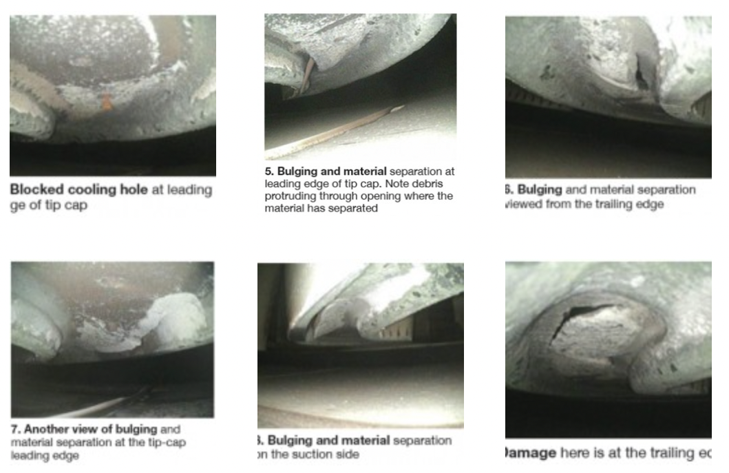

Shortly after the 7EA User Group meeting at the end of October, Hoogsteden reported that Advanced Turbine Support had perfected a specialized method for inspecting, without turbine disassembly, 7FA first-stage buckets for tip-cap damage or loss (Fig 1). This is important because such damage is conducive to a reduction in airfoil cooling. When that occurs, the expected end result can be a loss of coating on the leading edge of the affected bucket (Fig 2), or in extreme cases, the loss of the entire leading edge (Fig 3).
Advanced Turbine Support technicians inspected all 92 first-stage tip caps on each of six engines in the early fall. Four units were fine, two had buckets with damaged tip caps. Checking first-stage tip caps adds about four hours, depending on findings, to a typical 10- to 12-hr engine inspection. Hoogsteden said bulging and material separation of the tip cap, and plugged cooling holes, are likely precursors of eventual failure.
It’s unlikely that damage to a particular tip cap would be reason to remove the GT from service, but the findings serve as an alert and enable users to better schedule an outage for repairs. Figs 4-9 illustrate the damage found in six different buckets in the two affected machines.
