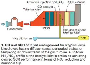

Combined- and simple-cycle gas turbine (GT) systems typically rely on oxidation and SCR catalysts to reduce CO and NOx emissions, respectively. In a combined cycle, GT exhaust gas usually flows through one or more HRSG tube banks before entering the CO catalyst (Fig 1). Ammonia, a reagent, is injected downstream of the CO catalyst and ahead of the SCR catalyst, where it combines with oxides of nitrogen in the exhaust gas to form nitrogen and water vapor.

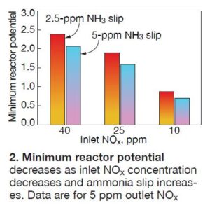

Reactor potential. Although catalyst activity is important, the key parameter for determining SCR performance is the reactor potential, RP—basically, the activity multiplied by the total catalyst surface area per unit of exhaust gas. Given an initial NOx level, required level of NOx reduction, and limit on NH3 slip, one can calculate the minimum RP that a reactor needs to achieve this given performance goal. This is expressed mathematically as:
RPmin = K ÷ Av = f(NOx-inlet, ΔNOx, and NH3 slip)
Fig 2 shows how the minimum RP varies for two levels of required NH3 slip and varying inlet NOx, assuming an outlet NOx level of 5 ppm must be achieved. RP is important because it reflects the effects of both catalyst activity and area velocity. Several factors can influence area velocity calculations. For example, insulation accumulation on the catalyst surface will reduce the available catalyst surface area and, consequently, RP.
Variations in GT exhaust-gas flow also can increase or decrease RP. Thus, from an overall operating perspective, the RP determines SCR performance—not just catalyst activity. Ultimately, SCR catalyst management entails (1) knowing the minimum RP needed to achieve the necessary performance, and (2) monitoring the RP over time. Other factors, such as the NH3/NOx distribution entering the catalyst are also important. Access background material via this link: SCR PERFORMANCE MANAGEMENT: AIG tuning, catalyst for life forecasting.

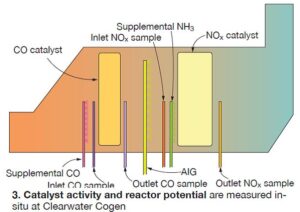

Fig 3 provides an overview of the CatalysTraK approach for gas-fired turbine applications. Similar to the laboratory approach for SCR catalyst, NOx reduction is measured across a small cross section (“test section”) of the catalyst bed. A small supplemental ammonia injection grid (AIG) is permanently mounted upstream of the test section (Fig 4).

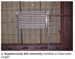

Additionally, an inlet gas sampling probe is installed directly upstream of the AIG, and an outlet gas sampling probe is installed immediately downstream of the catalyst bed at the test section. The supplemental AIG is used to increase the NH3/NOx level and provide excess ammonia across the catalyst test section. The RP calculation then is based on the maximum NOx reduction measured across this catalyst test section.

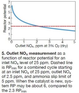

One issue related to the application of CatalysTraK to a GT SCR is that these systems have a single layer of catalyst and it contains all of the reactor’s RP. Thus, when catalyst is relatively new, the measured NOx reduction across a layer of GT catalyst at NH3/NOx > 1 can be greater than 99%.
This can make difficult to accurately determine the RP. For instance, with an inlet NOx level of 25 ppm, Fig 5 shows the expected measurement of the outlet NOx as a function of the RP. The dashed line in the illustration is RPmin (2.3) for a combined cycle starting at an inlet NOx of 25 ppm with an outlet NOx of 2.5 ppm and an ammonia slip limit of 5 ppm.
When the catalyst is new, the RP for the system may be about 6, significantly higher than the 2.3 minimum. For the “new” condition, the outlet NOx measured with the CatalysTraK system can be less than 0.2 ppm. However, Fig 5 shows that as the catalyst ages and RPmin is approached, the CatalysTraK measurement will exceed 2 ppm—a level that is easily measured. The bottom line: Early in a catalyst’s life, the CatalysTraK measurement may have a higher degree of uncertainty associated with RP, but at that point in a catalyst’s lifecycle it is not critical that the RP be precise.

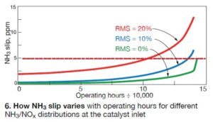

Typically a good NH3/NOx distribution for a gas turbine SCR system would be characterized by an RMS < 10%. When the Clearwater Cogeneration AIG was recently tuned, the RMS was about 20%. Fig 6 shows how ammonia slip varies with operating hours (zero being when the CatalysTraK measurements were made) for different NH3/NOx distributions entering the catalyst. The distributions assume 90% NOx reduction from an inlet NOx level of 25 ppm). Specifically:
• RMS = 0%: At 143,000 hours, RP reaches the minimum of 2.3. Here, the NH3 slip increases to the 5-ppm limit. Beyond this point there is insufficient activity to reach 2.5 ppm of NOx.
• RMS = 20%: Slip of 5 ppm is reached at 100,000 hours of operation (RP = 2.3). This NH3/NOx maldistribution significantly reduces catalyst life.

Why use a laboratory to make this measurement? Why not just measure the oxidation across the actual CO catalyst bed while it is operating? This also was done during the recent Clearwater Cogeneration tests. An inlet and outlet probe pair was located across a local region of the CO catalyst and the amount of CO oxidation was measured.
Four sets of CO measurements were made across the catalyst. These results, presented in Table 3, show the oxidation of CO across the CO catalyst at the test location was quite high, averaging 96.7%.
