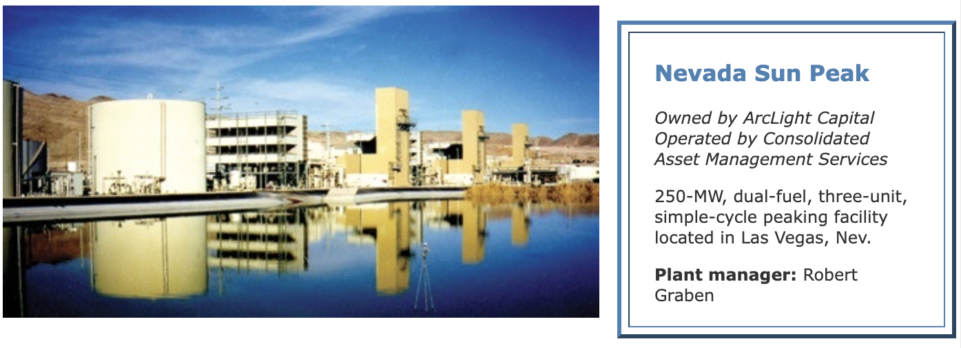

Plant relocates evap-cooler pumps to improve safety, system reliability
