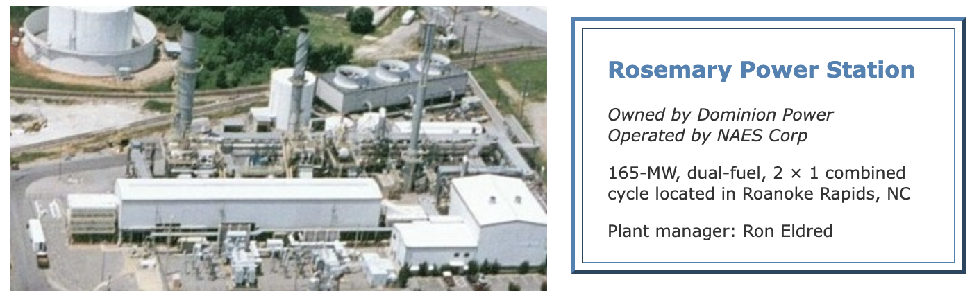

Rosemary Power Station is a unique 2 × 1 combined cycle, being equipped with one GE 7EA and one GE 6B gas turbine. The plant began commercial operation in December 1990. Average capacity factor for 2006 through 2012 was 8.3%. Rosemary currently operates under environmental restrictions that limit its capacity factor to about 10%. Owner Dominion Energy uses most of the plant’s available capacity during summer peaks.
