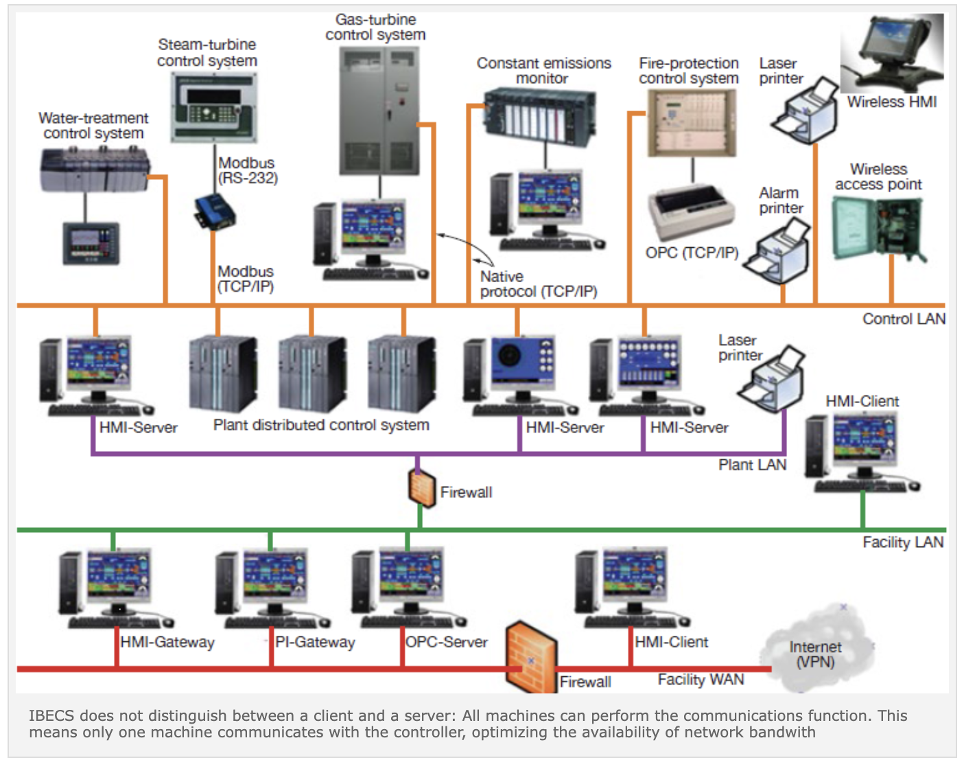

IBECS does not distinguish between a client and a server: All machines can perform the communications function. This means only one machine communicates with the controller, optimizing the availability of network bandwith

Finally, the architecture for achieving redundancy is a distinguishing feature of IBECS (diagram). The industry standard for redundancy is multiple communication servers which also function as the data servers to the various clients, such as between a field controller and an HMI workstation. IBECS does not distinguish between a client and a server. All machines can perform the communications function. This means only one machine is actually doing the communication to the controller, which helps optimize the availability of bandwidth on the network. In addition, any IBEC machine can back up the other. CCJ
