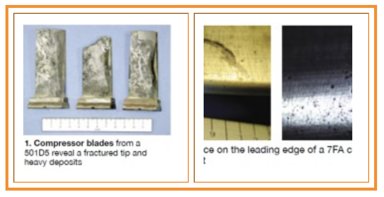

Gas-turbine owner/operators are well aware that airborne contaminants foul compressor blades and vanes, reducing efficiency. But they may not know that contaminants also can serve as nucleation sites for under-deposit corrosion cells, which can have dramatic implications for component life, including increased risk of catastrophic failure (Fig 1).

M&M Engineering engineers and metallurgists include a combination of leading-edge erosion and pitting in the first few compressor stages of some machines. While erosion is most often the result of online water washing, it also can be caused by ineffective filtration of inlet air attributed to poor filter selection, poor condition of filter media, and/or bypassing of filter elements. Important to note is that an eroded leading edge is an ideal location for compressor deposits to become deeply embedded.High-strength precipitation-hardening (PH) stainless-steel blades and vanes suffer a particularly high loss in fatigue threshold properties from pitting. They are more prone than some alternative materials to suffer airfoil liberation caused by cracking nucleated at pitting.
Given the drop in compressor efficiency, the irreversible damage caused by erosion and corrosion pitting (Figs 2 and 3), and the risk of catastrophic damage from fracture initiation at corrosion pits, it is in your best interest to have a mitigation strategy for compressor deposit accumulation. Moreover, the strategy selected should consider a scenario where some accumulation is unavoidable and how to reduce the activation of these deposits.
Finally, particular attention should be paid to units with a history of blade failures attributed to a design limitation that makes them more susceptible to corrosion fatigue cracking. Such units would have a very low tolerance to the presence of corrosion pitting.

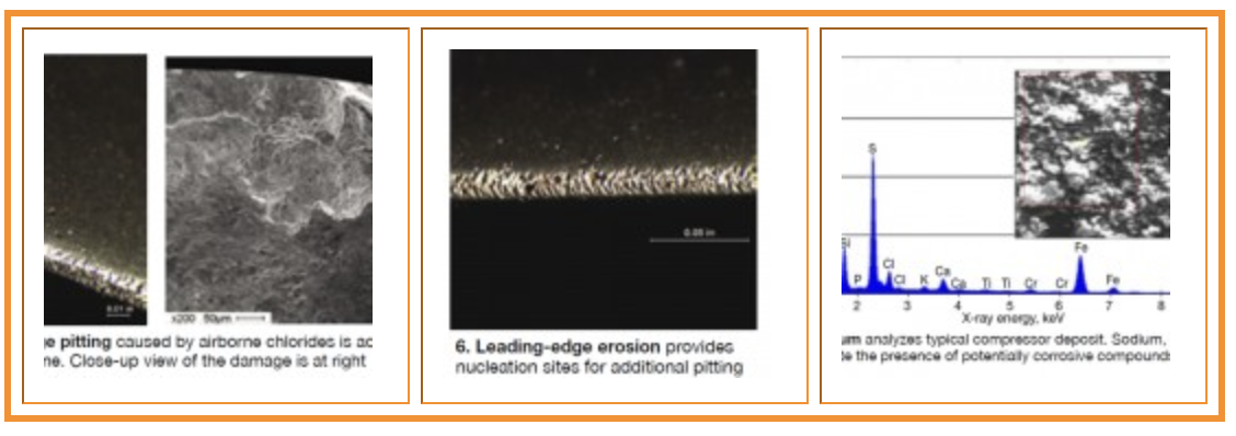

Chlorides in salts will rapidly corrode (pit) all of the stainless steels used in GT compressors (Figs 4 and 5). The only class of materials reasonably immune to chloride or under-deposit corrosion is the titanium alloy blades and vanes used in flight turbines and possibly some land-based aeroderivative units. Sulfur-containing compounds are commonly found on compressor airfoils, but also have been identified in larger quantities in cracks on Inconel 706 turbine wheels used on F-class units.

Energy dispersive spectroscopy (EDS) provides qualitative elemental analysis of materials under scanning electron microscope (SEM) examination based on the characteristic energies of x-rays produced by the electron beam striking the sample (Fig 7). The relative concentrations of the identified elements are determined using semi-quantitative, standardless quantification (SQ) software.

Most OEMs and some independent service providers perform replications of leading-edge erosion and pitting. Users should be aware that given the typical undercut pitting morphology observed on most blade pits, a large portion of the pit will not be captured in a replication.
This method of examination and evaluation accurately reflects broad surface pitting, but not undercut pits. Reason: Impression media typically does not flow into undercut pits. Even if it did, it likely would break off and remain in the pit when the impression media is peeled from the blade airfoil surface.
Moreover, pits often are packed full with compressor deposits and corrosion byproducts, again resulting in vastly underestimated pit depth. Finally, an indication replicated by a mold will not be able to differentiate between pits caused by corrosion (deep and undercut) and those from foreign object damage (small particles that leave divots on the leading edge of the blade). This requires a trained eye during a visual inspection. The result of the foregoing is that the depth of attack will be underestimated.
A better method is simply magnified photographic documentation where the “black dots” on the blades are confirmed to be pits. A safe assumption is that the pit is at least as deep as it is wide.
Pitting
Pitting of compressor blades and vanes always is caused by under-deposit corrosion aggravated by the presence of corrosive species in the deposit. The corrosive species most often are sulfur- and chlorine-containing compounds, but pitting also can occur simply from the presence of oxygen under the deposit. Pitting is proof of corrosive deposits; trace amounts of corrosive species identified by EDS at the bottom of the pits identifies the active corrodents. Such examination allows fine tuning of treatment for that species (Sidebar).
