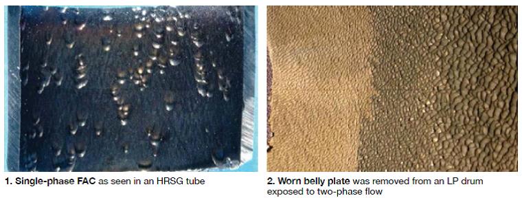

Recall that FAC involves the accelerated dissolution of the protective magnetite layer that forms naturally when carbon steel is oxidized in water or in a two-phase water/steam mixture. While extensive research over the last four decades has led to a good overall understanding of the essential damage mechanism—that is, dissolution rate depends on local water chemistry, temperature, and fluid velocity—work continues on understanding the relative importance of the individual parameters on wear rates and on improving the accuracy of predictions.
FAC can occur in both single- and two-phase flow conditions. The latter can accelerate FAC progression, principally by increasing the flow rate of water near the metal surface. It is possible in some cases to differentiate between the surface appearance of a pipe or tube subjected to single-phase FAC and one experiencing two-phase FAC.
Surfaces exposed to single-phase FAC are usually ascribed an “orange peel” appearance, with pits resembling many horseshoe prints, all oriented in the same direction (Fig 1). Surfaces exposed to two-phase FAC can have a wider range of appearances—from the so-called “tiger stripe” pattern to a black and shiny scoured surface to an “orange-peel” pattern very similar to single-phase FAC (Fig 2).

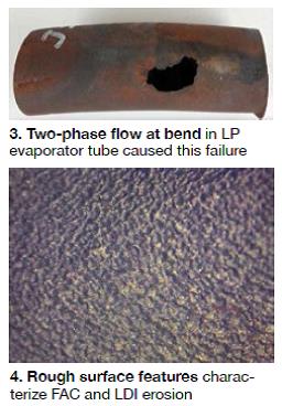

Damage caused by LDI is characterized by a rough surface, similar to cavitation pits, with little or no surface oxide. The wear rate attributed to LDI in a given material depends on several factors, including these:

The notion that FAC and LDI could act in a complementary fashion is fittingly described by the term erosion/corrosion, which had been used to describe the range of flow-related mechanisms that could cause pipe thinning.
FAC, LDI in LP evaporators. FAC, and to a lesser degree LDI corrosion, is known to occur in HRSG LP evaporator circuits, at times requiring extensive repairs and even full-module replacements. Single-phase FAC can occur in any area where there are high local flow velocities exist—such as tube bends at the lower header and feeders, and connecting piping between header and downcomer. There is a noticeably higher amount of thinning of the tube walls at locations just above the feeder pipes entering the header.
Two-phase FAC has been observed in tube bends at the upper header (Fig 3), the inside surface of the upper header, risers and drum internals such as separator plates. LDI wear is potentially possible in the same areas if flow velocities are high enough (Fig 4).
Tubes near the edge of the bundle adjoining the casing or center baffles may show accelerated thinning because of higher local gas temperatures which increase boiling rates, and hence local flow rates. The higher temperatures occur when hot gas bypasses upstream tubes along channels, such as the one formed by the gap between the casing wall and the edge tube.

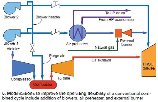

Michael Radovich of URS, Princeton, NJ, described in his presentation, “Agile HRSG” (POWER2013-98255), a design enhancement for conventional reheat heat-recovery steam generators intended to enable faster startups. The modification might also be suitable for existing HRSGs. The operational flexibility provided by Radovich’s design could help a plant improve its dispatch position and revenue stream, particularly where a grid operator is looking for reliable generation to back up must-take intermittent renewables.
The mod also would allow a combined-cycle plant to operate its HRSGs as standalone auxiliary boilers, and its gas turbines in the simple-cycle mode without the need for bypass stacks. The only additional equipment required to make such operational improvements a reality, according to Radovich, are external blowers, a preheater, and a burner connected to each boiler’s diffuser (the transition piece connecting the GT exhaust duct to the HRSG). The preheater uses water from the HRSG’s HP economizer to raise the temperature of ambient air prior to combustion (Fig 5).
When GTs are shut down, this auxiliary equipment is placed in service; it provides enough flue gas to allow the HRSGs to operate as small auxiliary boilers. The steam produced pressurizes the drum, heats the steam lines, provides sealing steam for the steam turbine, and allows a vacuum to be maintained in the condenser. Sufficient steam would be available to synchronize the steam turbine, Radovich said.
The external burner system also can be used as a duct burner. During hot weather, it can provide the HRSG with additional heat to increase steam production.
When inspection and/or maintenance of Rankine cycle equipment is required, the plant can be lined up this way for simple-cycle operation: The HRSG, condenser, circulating-water system and steam turbine are shut down, and the boiler is drained. The blowers then are turned on and inject tempering air into the GT exhaust stream. Ambient air reduces the exhaust temperature to that required by the SCR for optimal NOx control. Important to note is that the temperature of the ambient air/flue gas mixture does not cause distress to the uncooled HRSG heat-transfer surfaces.
Equipment specs. The two blowers incorporated into each GT/HRSG string should be sized to temper the diluted exhaust stream to about 780F; Radovich considers this the ideal temperature for good SCR performance. The combustor, he says, should be able to heat air flow from one of the blowers to about 900F, which is consistent with the desire to operate the steam turbine at low load.
A work in progress. Radovich acknowledged that his proposed cycle enhancement might be difficult to retrofit on some existing combined cycles because of the space required to install the external burners and heat-exchanger skids. Other possible sticking points that should be considered, he said, are listed below. All suggest the need for engineering analysis.
- HRSG drums might not be suitable for the low-pressure steam flows produced by the external combustion system.
- Low stack temperatures may cause ammonium bisulfate to deposit on preheater heat-transfer surfaces.
- The HRSG may not be able to handle the additional tempering-air flow.
- The steam turbine may not be capable of operating for extended periods at the low steam flows and pressures associated with the external combustion system.
In wrapping up his presentation, Radovich said the design described in his paper probably could be improved. For example, it may be more economical to fire an external duct burner with one of three 33% tempering air fans rather than one of two 50% fans.
A rigorous economic analysis also is necessary. The work presented at the ASME Power meeting did not address costs and auxiliary loads required by the modifications. A candid Radovich also revealed that “at this stage, we have not identified a vendor willing to bid the external heat exchanger/duct burner and blower modification. As we have also not identified the pressure drop through the heat exchangers and dust burner, we are not able to size the fans, except for mass flow.”
To dig deeper, review the paper. It includes relevant Markov diagrams—graphical representations of all states and transitions that an individual train (one GT and its dedicated HRSG) can experience—as well as heat balances simulating normal operation in the design condition and auxiliary boiler operation in the off-design condition.

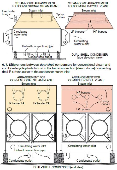

- A dual-shell unit consists of two identical shells operating at the same pressure; the hotwells and the steam domes of the two shells are connected (Figs 6, 7).

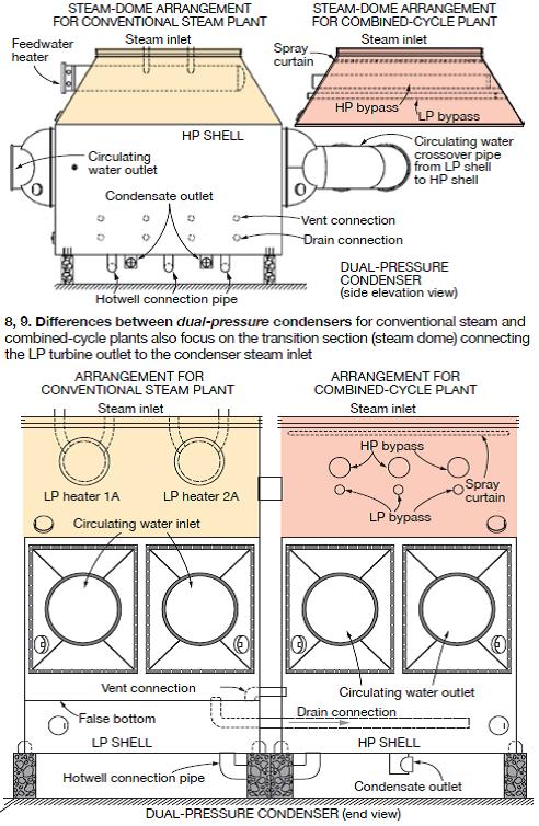

- In a dual-pressure condenser, the two shells operate at different pressures (Figs 8, 9). Circulating water enters the LP shell and, upon exiting, enters the HP shell. Cycle efficiency is improved by partially heating the condensate from the LP shell in the hotwell of the HP shell.

Design features particular to dual-pressure condensers
A false hotwell bottom is installed in the LP shell about 18 to 24 in. below the lower-most tube. It is not designed to handle the shell-side design pressure or the loads encountered during a shell-side hydro. The welds between the false bottom and the shell walls, and those between the false bottom and the hotwell support pipes, must be carefully examined for cracks. Failure to find and repair cracks can lead to performance loss as leaks tend to equalize the pressure between the two shells.
After completing the mods necessary to repurpose an existing condenser for combined-cycle service, conduct a shell-side hydro. Because the false bottom is not designed to withstand the pressures associated with a hydro, install manways to permit the free flow of water in the spaces above and below the false bottom.
Draining condensate from the LP to HP shells. Condensate collected in the space above the false bottom in the LP shell is drained into the hotwell of the HP shell, as shown in Fig 9. Because the LP shell operates at a lower pressure than the HP shell, provide sufficient head in the drain pipe to permit positive flow under all operating conditions.
Insufficient head can cause condensate to back up in the LP shell above the false bottom, submerging tubes and leading to an increase in LP-shell pressure. Condensate from the LP shell should be drained into the HP shell at a minimum of three to four locations along the length of the shell.
Venting considerations. Vent the steam space below the false bottom in the LP shell to the HP shell at a minimum of three to four locations along the length of the shell (refer again to Fig 9). Insufficient venting can lead to problems in hotwell level control because of the difference in levels between the hotwells for the LP and HP shells.
Circ-water crossover piping. When calculating the overall tube-side pressure drop for dual-pressure condensers, be sure to include the delta p in the crossover piping between the LP and HP shells, in addition to the tube-side pressure drops for each shell. It is important that the design of the circ-water crossover piping be evaluated to ensure satisfactory performance in combined-cycle service.
Design features particular to dual-shell condensers
A dual-shell condenser is much simpler in design compared to a dual-pressure condenser. As mentioned earlier, the former consists of two identical shells connected in the steam-dome and hotwell locations. An important design point is to be sure the ducts connecting the two steam domes are large enough to equalize the pressure in the two shells under all operating conditions. Special attention should be given to the removal of debris from the piping connecting the two hotwells.
