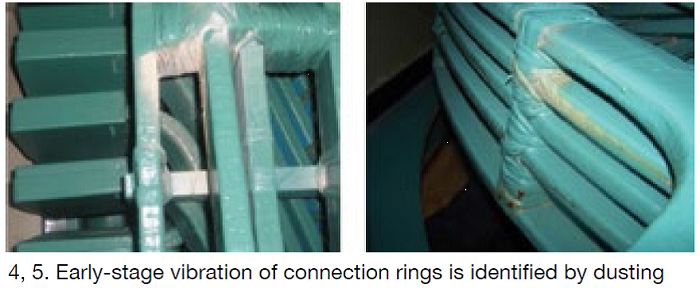

Stator-winding vibration, it seems, always has been a leading cause of generator problems. Historically, endwindings were tied with cotton cord, then with glass cord, and then with resin-impregnated materials. This evolution occurred as EMF increased in the endwindings and connection rings.
The resin-impregnated tape commonly used on today’s generators is a dry-tie material. Important variables enter into the tie process when using this material, including these:

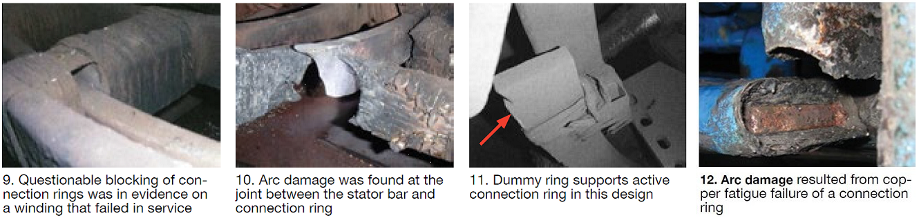

Gallery. Figs 1, 2, and 3 show dusting as evidence of early-stage vibration in an endwinding; Figs 4 and 5 reflect vibration of connection rings. Early-stage dry-tie vibration illustrated in these five photos is relatively simple to repair—that is, to remove the dry ties and replace them with wet ties as recommended by the OEM. Even where insulation wear is significant (Figs 6 and 7), depending on depth and location, it may be possible to repair and retie. An alternative is a stator rewind.
Fig 8 shows a failure location on connection rings. It illustrates the amount of physical damage that can be caused by a failure arc, which persists for several seconds after the breaker trips as field current decays. The photo also shows the relatively weak integration of the tie between ring and support: The ring is connected to the support only at an edge of the ring rather than on a wide face. If the tie and bond are not exceptionally strong, the bond will fail and vibrations and wear can begin.
For the support in Fig 9, note that the ring is contained on the faces but it does not fill the opening provided. Thus the ring is retained only by bonding of the faces and if that bond is broken by differential-expansion forces of cyclic loading, the ring will be free to vibrate.
Some configurations of connection-ring blocking can leave the blocks poorly integrated with the ties and rings. In such cases, the blocks themselves may disbond from the rings and ties. The loose block, or blocks, then can vibrate in a contained space and wear completely through the insulation of both adjacent connection rings. Since adjacent rings likely will be in different electrical phases, this condition is an invitation to electrical flashover and massive arc damage.
The damage in Fig 10 probably resulted from the arc of a phase-to-phase short circuit between two locations of bared conductor caused by vibration. In the event of a line-to-line failure, the minimum repair likely would involve full stator and field rewinds and extensive core, frame, and cooler cleaning. In a worst case, stator replacement could be required.
A few designs include a dummy ring in parallel to the active connection rings (Fig 11). These generators appear particularly vulnerable to vibration and wear. As shown, the ties are not doing a good job of joining the dummy ring to the support. Keep in mind that the dummy ring is made of a composite material having a significantly different expansion coefficient than copper. During cool-down from bake, and with cyclic loading, the dummy ring tends to disbond and become free to vibrate, shift position, wear the ties, and contact and damage connection-ring insulation. Early failure of the winding may result.
Typically, when dry-tied windings experience severe damage or failure, the cause is from insulation wear as seen in Figs 1-7. However, there is also the possibility that debonding of ties and blocking can result in increased levels of component mobility and/or vibration natural frequencies drifting into resonant situations. These changes can result in much faster insulation wear, but they may also result in high-cycle fatigue and fracture of the copper conductor (Fig 12). Each of these conditions, insulation wear and copper fatigue, is extremely dangerous to winding integrity.
