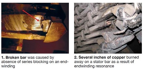

Stator endwinding vibration has been an ongoing issue for large generators. Problems have been exacerbated as engineers designed to accommodate higher vibration driving forces while simplifying support systems. A case in point is the elimination of series blocking on the endwinding in Fig 1, which caused the broken bar in the photo. Local endwinding resonance resulted in the failure shown in Fig 2.
Protection against such failures probably is best obtained by being sure a thorough bump test is performed on new and reworked windings. Resonant values should be outside the 115-140-Hz range (for 60-Hz generators).

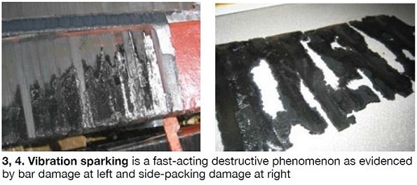

Stator-bar slot vibration. Large, indirectly cooled generators typically have many stator slots and tall, narrow bars. This design approach maximizes the area for transferring heat through the groundwall insulation. But it also may allow the tall, narrow bar to vibrate sideways in the slot, probably driven by core vibration. Such vibration causes vibration sparking, a fast-acting destructive phenomenon (Figs 3, 4).
Designers believed side filler would prevent side vibration. However, packing of incremental thickness cannot fully fill a continuously varying space, and vibration can occur. If deterioration is significant, corrective action probably requires a rewind to remove the fatally degraded bars and allow installation of side pressure springs.

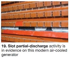

Global vacuum pressure impregnation. VPI of individual stator bars with asphalt began a century ago. Stator-bar VPI with thermoset resins started in about 1949 and has been used successfully to make high-quality stator windings since.
In the 1960s, global VPI was identified as a fast and inexpensive method of making a stator. The process involves putting the entire stator, wound with “dry” coil insulation, in a large VPI tank, where it is impregnated in a single operation. GVPI was first used on motors and small generators. In the mid-1970s it became popular with some OEMs for making large generators—even ones rated more than 400 MVA. But these windings have been subject to some maintenance issues, including the following:
- Slot partial discharge and possibly vibration sparking, which seem to be related to a slip plane between bars and core.
 - Difficulties in performing a rewind, which are related to the VPI process bonding stator bars into the slots. It is difficult-to-impossible, and time-consuming, to remove the winding to allow a rewind. Where a rewind is performed, the process is slow and the core is vulnerable to damage. On a GVPI generator, for quality and outage time considerations, stator replacement may be preferable to the rewind option.
Notwithstanding these limitations, because of the major advantages to GVPI, this process will remain popular for large generators.

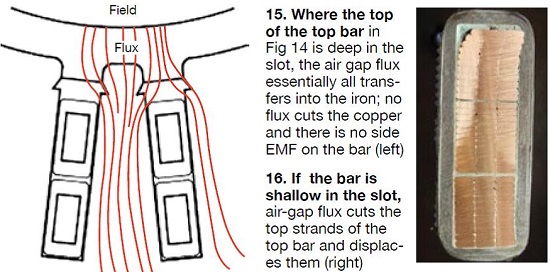

Step-down at end of co
re. High design uprate of modern generators involves greater step-down of the iron at the ends of the core. Because this puts the top of the top bar above the core iron, there is high air-gap flux cutting the copper strands at the top of the top bar and a significant sideways electromagnetic force (EMF) on the top bar.
Apparently, this causes sideways vibration of the bars at the end of the core (Fig 14); however, this condition may be relatively benign, and placing side pressure springs on the side of the bar to apply force in the same direction as the EMF may stop the vibration.
But there is another, perhaps more important, concern. Back into the slot a foot or so from the core end, the top of the top bar is deep in the slot. At that depth, the air gap flux has essentially all transferred into the iron (Fig 15). No air gap flux is cutting the copper and thus there is no side EMF on the bar.
But in these new designs, the top of the top bar is above the core tooth iron (refer back to Fig 14). If the bar is shallow in the slot, as it is in hydro generators, there is air-gap flux cutting the top strands of the top bar and you can get the condition shown in Fig 16.
Thus there becomes the worry that this strand-movement phenomenon may occur on modern 2-pole stators—perhaps a greater worry because the top of the bar is completely out of the top of the slot and exposed to full (reduced) air gap flux and corresponding EMF. End-of-slot concerns are relatively new, and assistance of the OEM should be obtained for assessing the scope of possible problems and corrective options.

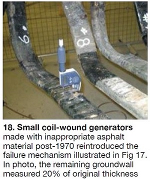

Tape migration on stator bars. This was a highly destructive deterioration mechanism on asphalt windings for pre-1960 generators rated more than about 40 MW (Fig 17). This condition was eliminated by use of thermoset windings. But the problem has recurred on post-1970 small (less than 20 MW) coil-wound generators that were made with an inappropriate asphalt material (Fig 18). The generator shown had been in service 20 years. The winding failed during a power factor test at line-to-neutral voltage. Repair of such a failure likely would involve a stator rewind.

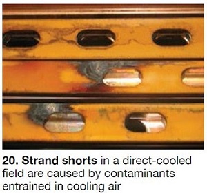

The design temperature of fields fortunately has been slow to evolve upward. High-temperature insulation materials are available, but copper has poor mechanical properties, even at room temperature—properties that degrade rapidly above about 265F.

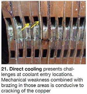

Direct cooling has been the best uprate tool for fields: It reduces the average copper temperature, as well as hot-spot temperatures. However, direct cooling can bring problems when contaminated
 atmospheres are allowed to foul generator internals. Turn shorts sometimes are associated with cleanliness issues (Fig 20).
Complex and mechanically weak gas-entry locations are another challenge presented by direct cooling. Brazing in those areas can make turns vulnerable to cracking of the copper (Fig 21) and winding failure.

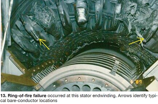

Misdiagnosis of the root cause of a generator failure can be exceptionally costly (tens of millions of dollars and perhaps in the 100s with loss of generation costs included), while leaving the machine vulnerable to a repeat of the same failure. Here are some recent experiences:
- A ring-of-fire stator winding failure on a 900-MW water-cooled winding was incorrectly attributed to the internal piping arrangement. Had the correct design error not been identified by further consultation, repeat of the massive stator winding failure would have been inevitable (refer back to Fig 13).

 - An asphalt stator winding was incorrectly diagnosed as having “destructive migration of the groundwall” (refer back to Fig 17). An inexperienced OEM engineer and an inexperienced independent consultant each recommended immediate stator rewind to avoid “catastrophic service failure.” Their recommendations were vacated by a more experienced engineer, and this stator winding continues to operate safely many years later.
