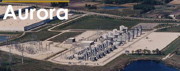

Aurora Generating Station
NRG Energy Inc
946-MW, gas-fired, 10-unit, simple-cycle peaking facility located in Aurora, Ill
Plant manager: Jim Brown
