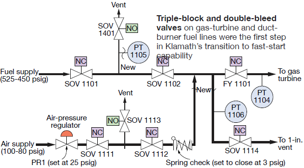

In 2011, NFPA 85 was modified to allow gas turbine operators to avoid the purge requirement if it can be proven that no gas has entered the exhaust ductwork. Specifically, NFPA 85 (2011), paragraph 8.8.4.6 mandates triple-block and double-vent valves on gas-turbine and duct-burner fuel lines. Also the following: (1) Valve positions shall be continuously monitored. (2) Pressures in the block-valve sections shall be continuously monitored. (3) Valves must be validated for leak-tightness prior to each startup and following each shutdown.
This idea proved both affordable and one that plant staff could develop in-house, avoiding expensive third-party engineering. The management-of-change process engaged all departments to ensure proper valves were purchased, installation locations were identified, and all parties agreed on the extensive logic.
The existing double-block and bleed system was utilized for two of the three block valves. The third block valve incorporated the existing flow control valve. To ensure this control valve was a positive shut off, air is introduced between the second block valve and the flow control valve. Air supply is regulated at 25 psig and monitored for consistency. If at any time, the pressure drops below 15 psig the fast start permissive is disabled as the system assumes an air leak.
Many other qualifications are made to validate the system and prove that no gas could possibly get into the engine. All valves are monitored via feedback with any deviation requiring a full purge prior to start. Pressure transmitters (PT) 1105 and 1106 are compared to fuel supply pressure while running in order to validate their accuracy (schematic).
During shutdown, PT 1105 must not rise above 5 psig. If the indication rises above this value, a problem exists within the first double-block-and-bleed piping. PT 1106 must not drop below 25 psig and not rise above 45 psig. A high pressure would indicate a gas leak into our second double-block arrangement.
Various timers and sequencers have been developed to ensure the second double-block piping is purged and that the ductwork is purged during shutdown. Ductwork purge credit is given while the unit is coasting down and the fuel piping purged out of the solenoid-operated valve (SOV) 1114 vent.
Once the unit has coasted to a speed just below standard purge speed, the starter is engaged to complete the full purge time. This is not required, but plant staff believes it a more conservative approach and had no impact on the ability of the facility to meet market demands.
The operator has indication of the demand and feedback of all valves. In the event of a system failure, the fast-start logic is disabled and an alarm is displayed. Upon repair of the failed component, the operator can manually purge the unit.
Once a full purge is complete and the permissives met, fast start then is enabled automatically. The operator also has a permissive graphic to allow for rapid troubleshooting and repair to get the system into a normal configuration.
