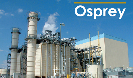

Osprey Energy Center
Calpine Corp
600-MW, gas-fired, 2 × 1 combined cycle located in Auburndale, Fla
