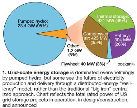

Electric utilities have relied on large-scale pumped hydroelectric storage (PHS) for decades (Fig 1). A representative from one of the largest US utilities once said, at a briefing for Congressional staffers, that its pumped-storage plant is like duct tape, it responds within minutes to manage or avoid a variety of grid-related operating problems, many falling in the category of ancillary services. More than 20,000 MW of PHS is operating nationwide.

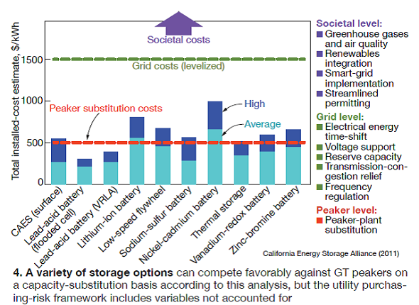

The California Energy Storage Alliance (CESA), found in a 2011 white paper, that a 50-MW lead-acid battery facility (4-hr discharge, 84% round-trip efficiency) was more economical than a 50-MW simple-cycle gas turbine/generator, based on both capital and levelized cost of generation alone, and that there were other economic advantages when grid level benefits and societal costs are monetized.
Emissions also were evaluated to be lower because storage devices would presumably be charged from base-load generating units (Fig 3). However, the lead-acid battery configurations are the lowest cost of the options analyzed (Fig 4).
The 2010 report, “Energy Storage—A Cheaper and Cleaner Alternative to Natural-Gas-Fired Peaker Plants,” further noted that the principal barrier is “current accounting of disaggregated benefits in a regulated utility industry and lack of clear policy direction to utilities that energy storage is a superior alternative” to gas-fired peakers.

On paper, storage can compete against peaking turbines. However, in the real world of utility economics, even when all the value can be monetized, a power system is “commercial” when deep-pockets system suppliers compete against each to meet the utility’s design specification and offer warranties, guarantees, and lifecycle service; when the regulator will likely approve the costs; when the system can be insured for loss; when all reliability impacts on the grid are known and understood; and generally when the technical risk has either been minimized or transferred to another party.
