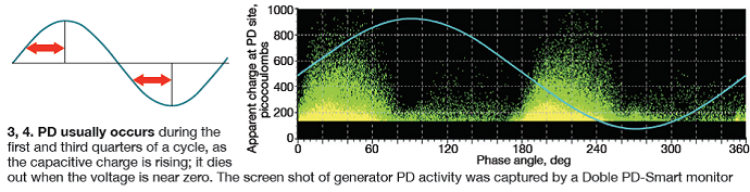

Since most electrical systems run on alternating current, the insulation experiences changes in electrical stresses throughout the sinusoidal cycle. This typically causes PD to peak during the first and third quarters of the cycle—when the capacitive charge across the flaw is increasing in the positive direction (first quarter) and when the charge is increasing in the negative direction (third quarter). PD typically dies down when the voltage is close to zero. This creates distinctive PD activity (Figs 3, 4).
The fact PDIV usually is higher than PDEV has a direct influence on testing procedures. PD tests typically are performed at above rated voltage, to make sure that the PDEV in an insulation system is above rated voltage. Imagine that a switching transient raises the voltage across the insulation to a level above the inception voltage for a brief moment. If the extinction voltage is below rated voltage, the PD, which started because of the transient, will not become extinct after the transient has passed, leaving the system with continuous PD activity.
