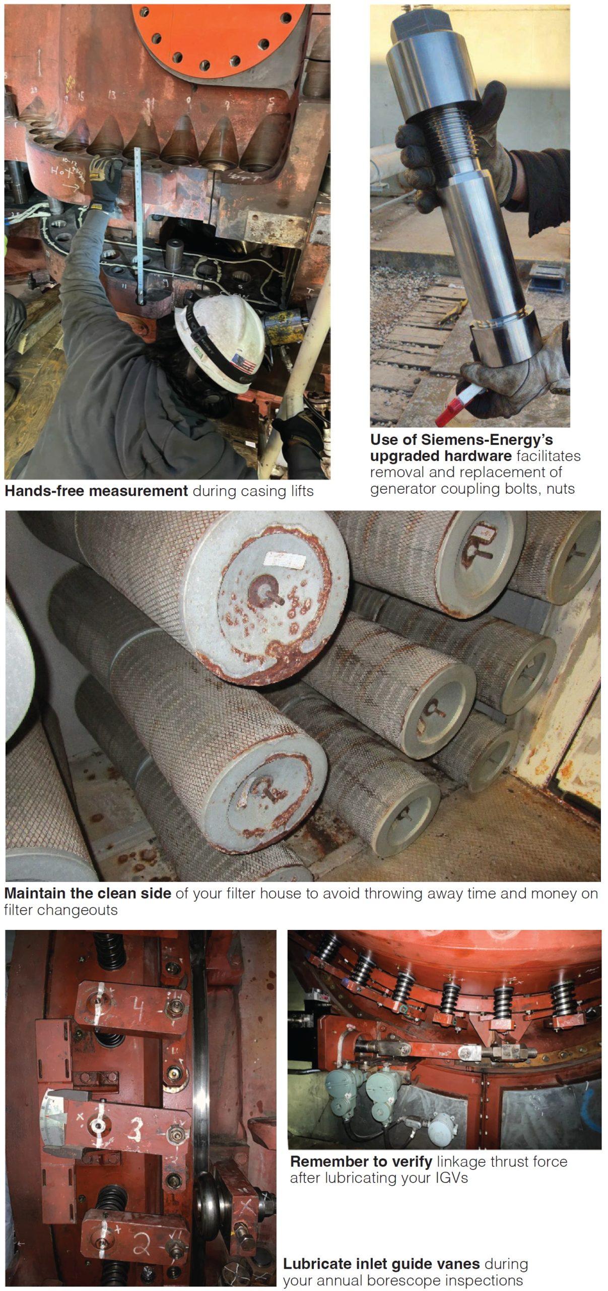

Magnetic case measuring sticks
Simple to make in the plant shop with self-adhesive measuring tape, aluminum bar stock (0.125 × 0.750 × 48 in. recommended), and 18-lb rubber-coated magnets. How: Cut aluminum to 24 in. and chamfer sharp edges; bend offset so measurement section remains flush against the case; install measuring tape with zero at the start of the flush section. Benefit: Hands-free measurement during turbine case removal and install, thereby protecting personnel.

Inlet/bellmouth/IGV maintenance considerations and a quick dive into compressor coatings
Good filtration, plus the condition of your filter house, inlet, bellmouth, and inlet guide vanes, are important to the overall health and performance of your gas turbine. Virtually all experienced operations personnel know this, but some technicians are prone to taking shortcuts and some supervisors are not as hard-nosed as they might be.
Presentation offers best practices and guidelines to review over lunch in the break room. What to look for on rounds, for example. Service Bulletin SB4-13-0037-GT-EN-01, and Service Bulletin 51004-R2 on inlet guide vane maintenance, are highly recommended. The latter was billed by the speaker as “20 pages of goodness” that could provide 15-20 PMs on its own.
Airfoil smoothness and erosion/corrosion avoidance was a major part of the discussion. Coatings often are the key here and that is covered in the slides with mention of base, intermediate, and top coats, surface roughness goals, and applicable ASTM standards.
M501F IGV maintenance and troubleshooting
This maintenance and troubleshooting guide for M501F inlet guide vanes includes a few slides pertaining to the W501, so it’s representative of the 501F fleet. The editors rate the presentation “valuable” for its detail, recommending it be included in the plant O&M library.
The speaker’s notes based on experience at his plant include the following points:
  • Lubricate the IGVs annually, during the borescope inspection.
  • Linkage thrust force has been a problem.
  • Unison rings/rollers have shown clear signs of skidding.
The IGVs are grease-lubricated with Mobil EP 0—typically two or three gun pumps per vane; vane tip clearance is checked shortly after lubrication. Topics include target clearance, “burping” of the IGVs, linkage thrust-force verification, roller issues, IGV component enhancement, and IGV roller bushing upgrade.
Point stressed: A robust maintenance plan is critical for reliable operation of the IGV system, regardless of the OEM.

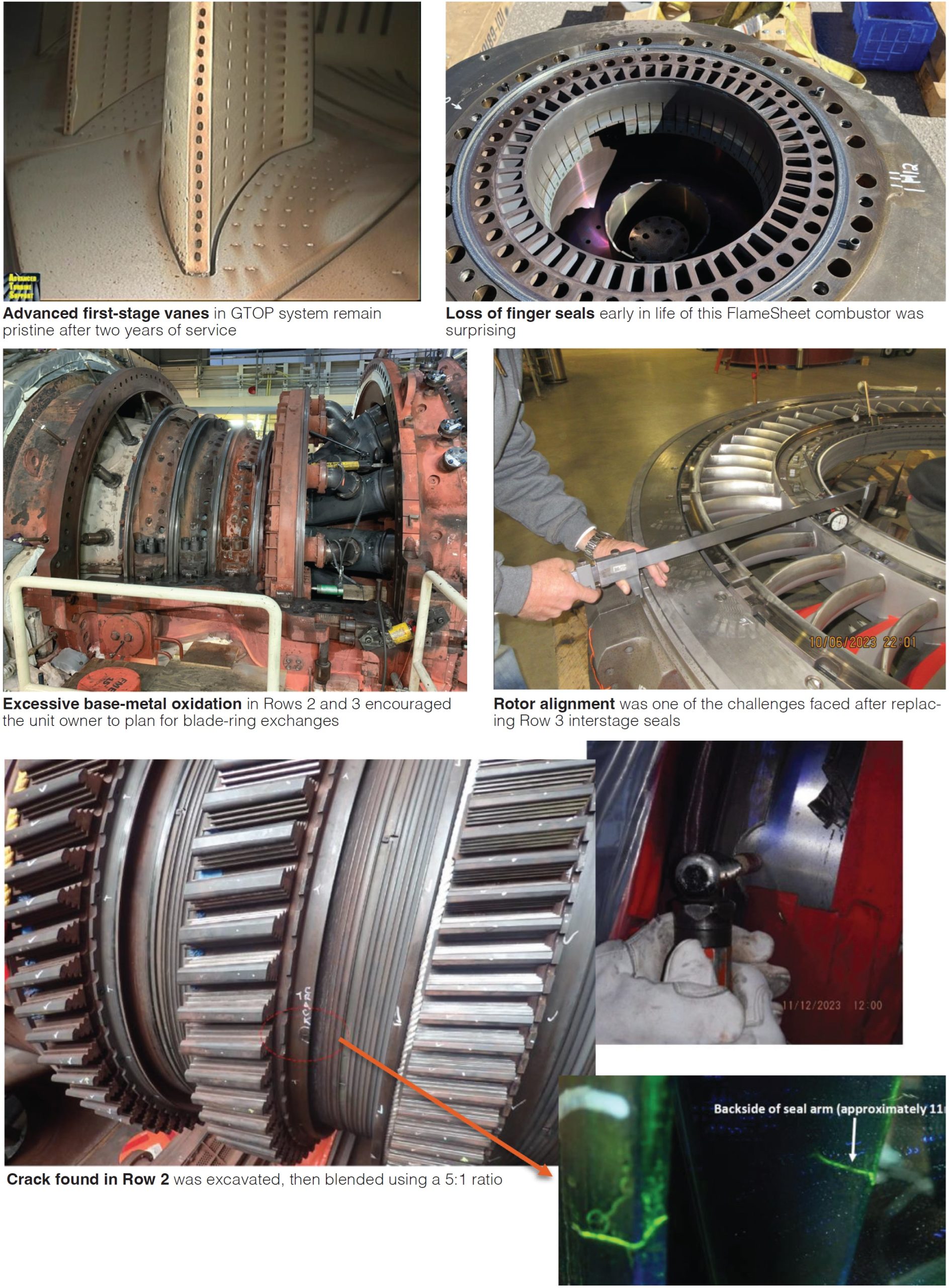

A rapidly evolving balancing area encouraged the retrofit of PSM’s FlameSheet™ combustors on two W501FD2 engines. Owner needed more power to support residential and industrial growth attributed to immigration, and better turndown to accommodate massive solar adoption.
In addition to the new combustors, PSM’s GTOP 7.1 system was installed to help boost output and extend maintenance intervals. It featured new 16th-stage compressor blades as well as first-, second-, and third-stage HGP components. Regarding controls upgrades, PSM’s AutoTune 3.0 was retrofitted.
Mods were made to the first gas turbine in November 2020, recording 12,631 hours and 363 starts through 2023. The second GT was upgraded in April 2022, recording 8217 operating hours and 239 starts by year-end 2023.
Photographs shared confirm generally excellent condition of HGP parts on both engines at the end of 2023, except for some rubs and platform coating issues on first-stage blades and minor rubs on R2 blades.
The owner/operator reported no trips concerning loss of flame, disc cavity, or any other mod-
related issues.

M501F3 turbine-blade ring exchange challenges and lessons learned
Would be a leading contender for a “best-paper” award, if there was one. Owner/operator planning the major inspection of the second unit (No. 8) in the 2 × 1 combined cycle profiled relied on past experience for guiding critical hot-gas-path (HGP) decisions. Operating data: 58,500 fired hours, 1628 fired starts, 54,800 turning-gear hours.
Row 2 turbine blade ring for No. 8 was exchanged during the unit’s 2019 HGP because of excessive base-metal oxidation and circumferential deformation. R3 had significant oxidation throughout the entire blade ring but was only weld-repaired. On the sister unit’s (No. 7) major in 2020, R2 was exchanged because of severe base-metal oxidation and material loss while R3 distortion was corrected in the OEM’s shop. Based on this experience, the utility planned to replace the R2 and R3 blade rings during the Unit 8 major.
Outage-planning highlights and notes and photos of the as-found condition of R2 and R3 for Unit 8 are provided in the slides, along with blade-ring assembly challenges important to users with similar issues.
Interferences between the geometry of the ring-segment retaining lugs and blade rings were found as well and are discussed, in addition to issues with the blade-ring horizontal ledge keys that prevented horizontal joints from closing properly. R3 interstage seal alignment was another problem encountered. It made rotor alignment difficult and was resolved by sacrificing side-to-side spindle clearances.

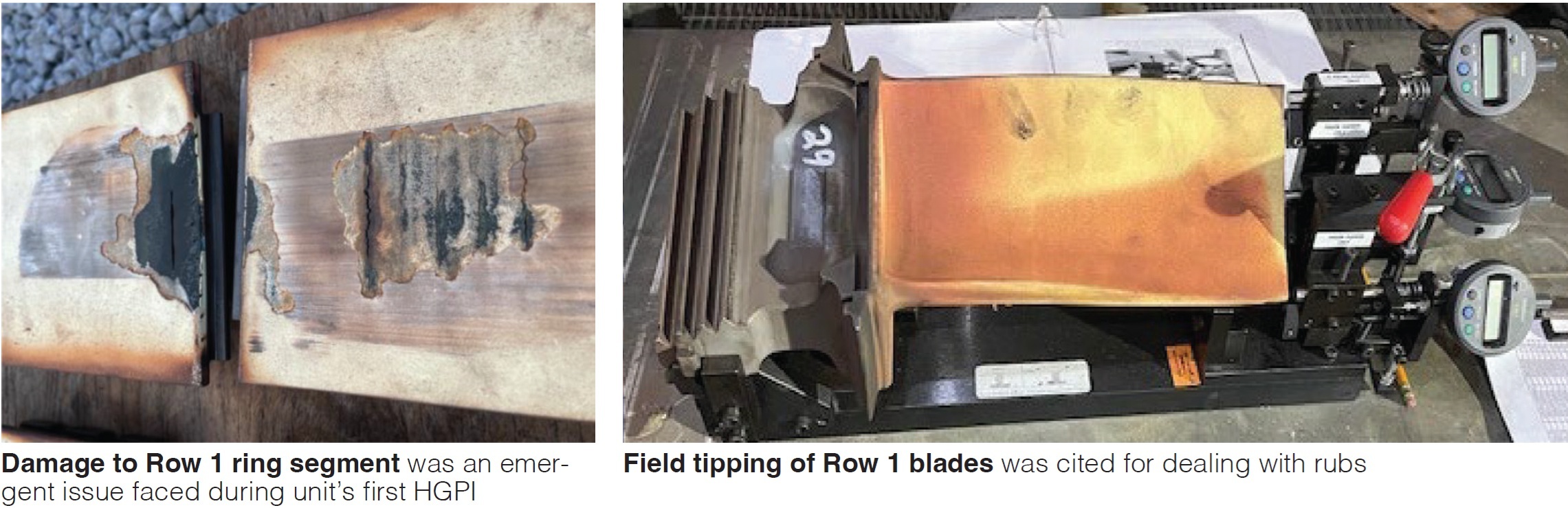

M501F return-to-service issues post HGPI
Emergent issues encountered during HGP and generator robotic inspections for two F4 units, and the thought processes used to resolve them, are covered in this presentation with input from a plant operations manager and engineers from two engineering organizations. Borescope inspection results and vibration signature analysis are included in the slide deck. Ring-segment issues, combustion challenges, rubs in the turbine section, and spin cooling also received air time.
Field tipping R1 blades
Causes of rubs and ways to prevent them are discussed. Takeaways on how clearances are checked and calculated, plus the process and hygiene of tipping, are focal points of the presentation. Of greatest value to users, perhaps, is the list of references provided covering tipping, optimizing of clearances to mitigate ring-segment rubs, hot-restart guidelines, spin-cooling guidelines, and details on the design, upgrade, and O&M of the direct air injection system (DIAS).

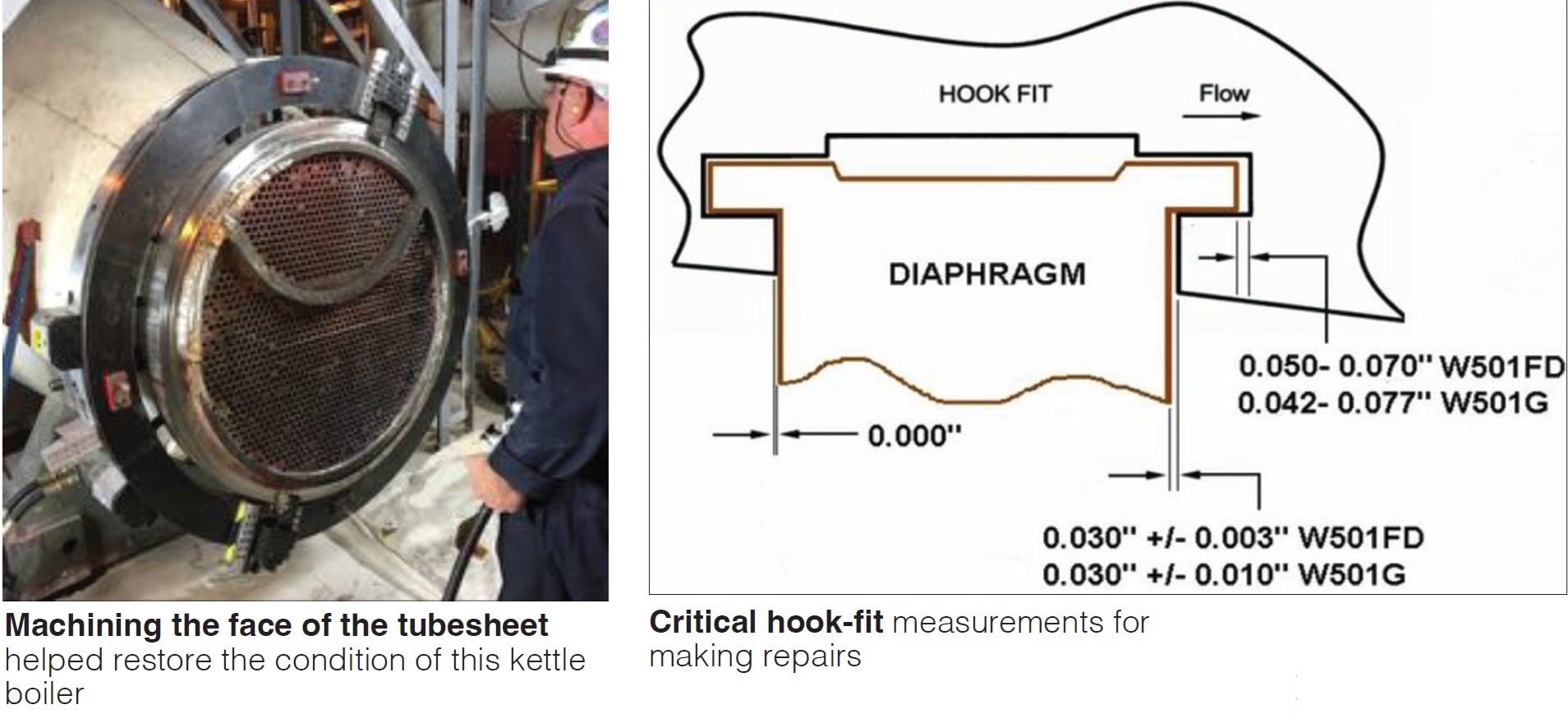

Increasing the service lives of kettle boilers
While Mark Dwileski, president, Northeast Precision Welding, is not a user, the steering committee chose to include his presentation in this portion of the 501F and 501G program, likely because he is well known to owner/operators and helps them solve difficult welding problems. Kettle-boiler and exhaust-system repairs are two of NPW’s specialties and Dwileski covers both in a presentation encompassing some 80 slides.

Siemens 501F, F, G, and D5A compressor case diaphragm hook-fit history and repair process
Compressor casings, diaphragms, and seal holders experience hook-fit wear. Over time, such wear can be excessive (most pronounced at the compressor horizontal split line) and, if not addressed, seal-holder migration in the forward direction can lead to contact with the rotor disc face. Result: Liberated material in the form of rotating airfoils and excessive foreign object damage.
Advisory: The hook-fit repair process requires different levels of skill from accurate measurement-taking, preparation, welding, and final machining. Not all welders and not all machinists have the skills to perform this repair properly.

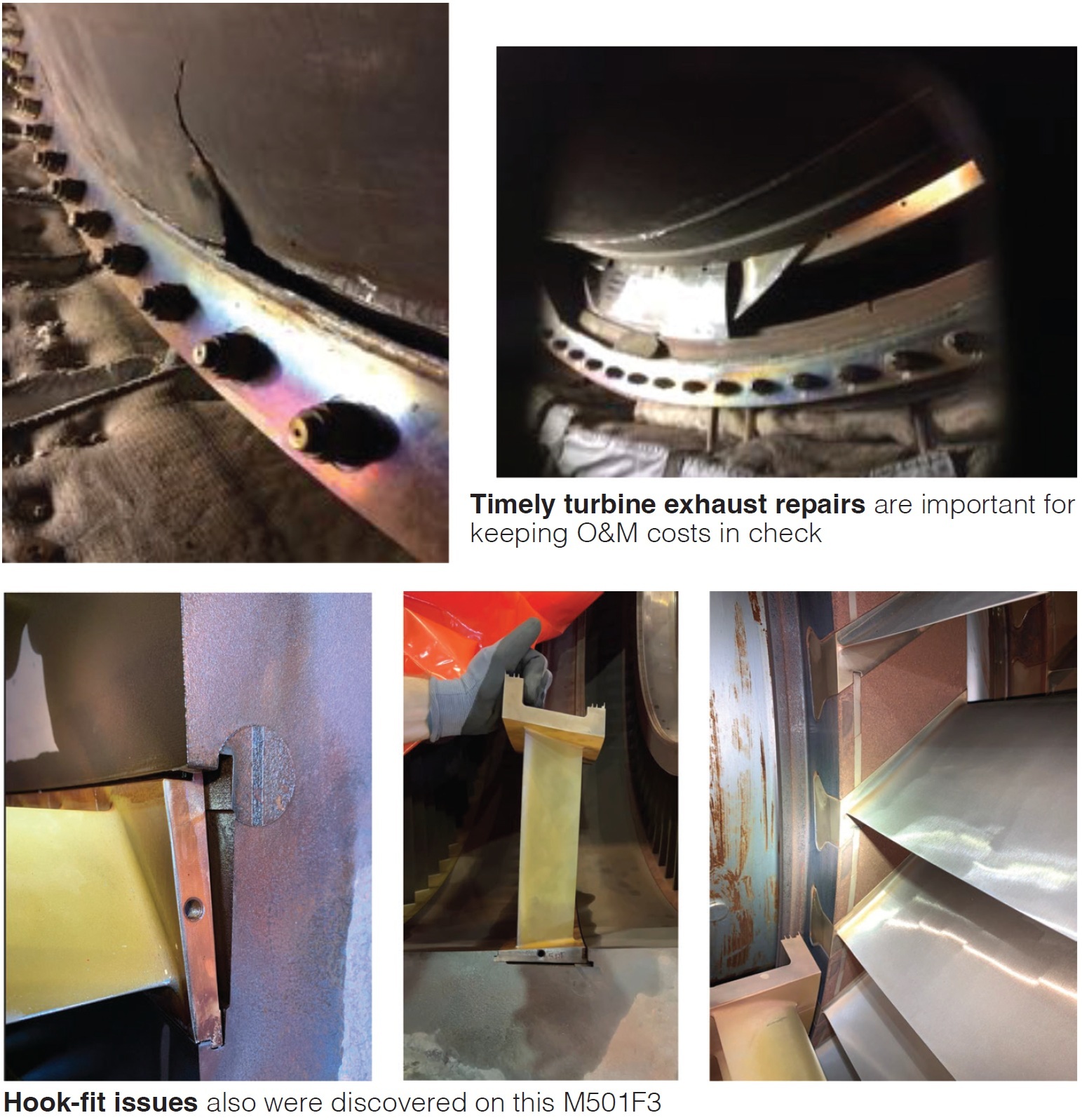

M501F3 compressor hook-fit wear found during a major inspection
Experience gained on hook-fit repairs during the major inspection for Unit 7 three years earlier was factored into the outage planning for sister Unit 8. A diagram shows where most wear occurred on U8, requiring 1061 linear inches of repairs. Photos illustrate the repairs made.
Additionally, compressor diaphragms for Rows 5 through 14 were recommended for repairs. Rows 5 through 8 were considered low risk and allowed to operate as is. Wear and tear in Rows 9 to 14 was judged to be of moderate risk and those diaphragms were replaced.

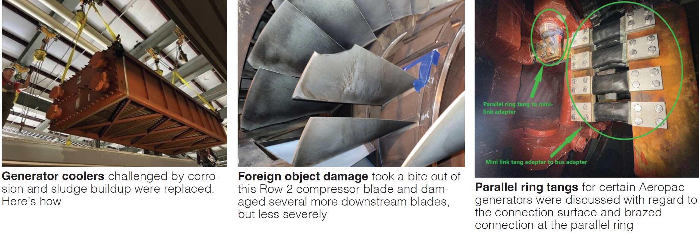

Generator through bolts, mini-link replacements, and parallel-ring tang inspections
Subsurface indications in through bolts for four identical generators installed at two facilities were addressed by the speaker. All four have had sleeves and spacers installed and have the bolt capture device. Bolt replacements are planned during next majors.
Mini-link replacements and parallel-ring tang inspections also were discussed.
Aeropac cooler replacement
Coolers for the Aeropac generators serving the 501FD3 gas turbines at this 2 × 1 combined-cycle cogeneration plant suffered from a heavy sludge buildup in their 0.750-in. vent and drain lines, plus heavy corrosion of their 6-in. inlet and outlet pipes. Well-illustrated presentation records removal of the original Unifin coolers and their replacement with new Kelvion coolers.
Only minor modification of the vent and drain lines were required for fit-up. Plus, new two-piece P-seals were installed on both coolers. Pressure test was performed with water at 65 psig and held for 15 min to ensure no leaks were found at connection points.
Compressor foreign-object damage
Presentation describes the combustion inspection experience of a 501FC+ that powers a 1 × 1 combined cycle. The unit’s original rotor had operated for nearly 73,500 hours and 4800 starts at the time of outage profiled in spring 2023. Duty was intermediate peaking service.
There was no indication or suspicion of compressor damage prior to the 14-day outage. Vibration levels were normal. Yet the damage staff found when the machine was opened required the replacement of 19 blades and blending of 224 others in Rows 1 through 11. Additionally, blending was required on 50 diaphragms. Staff had no knowledge or indication of when the incident occurred.
One possible explanation (unofficial): Icing.
Eight photos of the damage are included in the slide deck.
