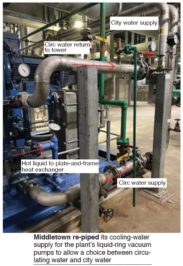

Challenge. Middletown Energy Center’s (MEC) liquid-ring vacuum pumps were experiencing cavitation and a significant decrease in capacity because of high liquid temperature. There was also a constant need for filter cleaning given the high level of suspended solids in the pump’s cooling water.
Staff responded by changing the cooling-water supply to the vacuum-pump skids—from circulating water to service (city) water. This modification did not increase water usage because the service water used on the vacuum skid was sent to the cooling tower as makeup.
Solution. To help alleviate the effects of pump cavitation and performance loss, and to minimize the need for personnel intervention, MEC piped service (city) water to the plate-and- frame heat exchangers on the vacuum skids. Using city water to cool the operating liquid stopped the cavitation and gained back some of the performance lost (photo). Circ-water temperature in summer is in the 90s; service (city) water is in the high 60s. Note that the circ-water line is still in place and can be used if needed.
Results. The plant estimates that an average of four man-hours per week is saved by using city water instead of circ water for pump cooling.
