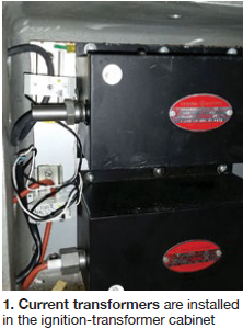

To measure spark-plug cable current flow in the installed system, the plant purchased small current transformers which provide a 4- to 20-mA current loop output proportional to current flowing in the cable. They were installed in the unit’s ignition-transformer cabinet with a spark-plug cable fed through them (Fig 1). Each transformer’s 4-20-mA output was wired to the respective GT’s Mark V control system and the input signal scale was configured thusly: 4 mA = 0%, 20 mA = 100%.
While the level remains above 8% for Ferndale’s healthy case (Fig 2), staff opted to use a low-level alarm point of 4% to allow for variations in spark intensities over time and avoid nuisance indications. The control system was configured to monitor spark-plug cable current during the ignition sequence and to generate an alarm when the current drops below the designated 4% alarm level for more than three seconds. This alarm remains uncleared until the operator performs a master reset on the respective GT’s Mark V.
