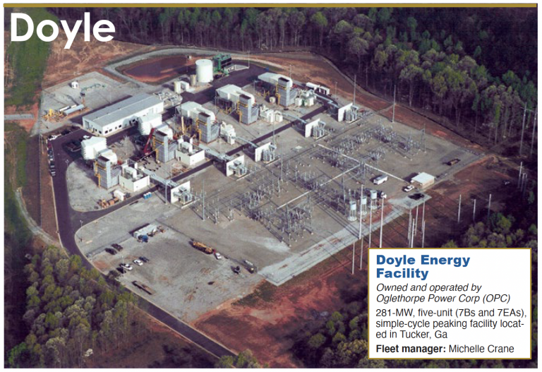

Background. Doyle Unit 1 is a 1968 GE 7B gas turbine with a 64-MVA/14.4-kV, 30-psig hydrogen-cooled generator. A thorough investigation of the engine by OPC engineers revealed degradation of its asphalt insulation and estimated remaining life at less than two years. Several equipment condition and operational performance gaps with the hydrogen cooling system also were identified during unit inspection and testing. Bringing the cooling system up to industry standards would require an estimated investment of $400,000 to $500,000.
