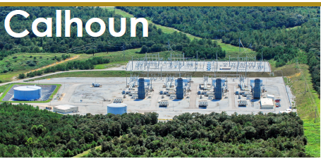

Calhoun Power, a 748-MW, dual fuel, four-unit simple-cycle plant in Eastaboga, Ala, is owned by East Alabama Generating LLC and operated by Consolidated Asset Management Services (CAMS). Plant manager is Mike Carter.
