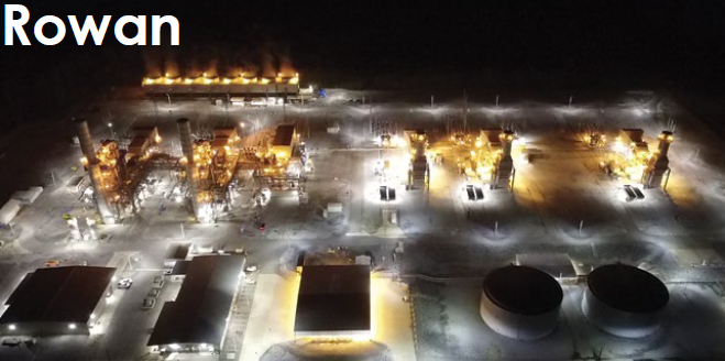

Plant Rowan
Owned by Southern Company
Operated by Southern Power
985-MW, gas-fired, 2 × 1 combined cycle plus three units in simple-cycle service, located in Salisbury, NC
