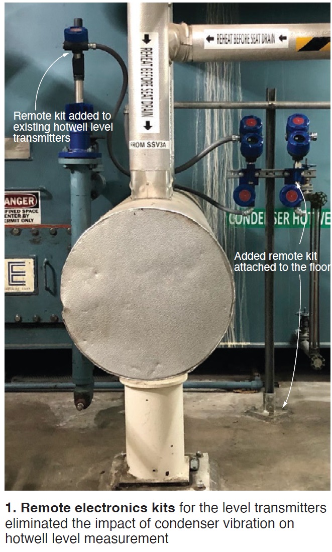

Remote electronics for hotwell level transmitters eliminate erroneous readings
Background. Two level transmitters are used for calculating the hotwell level at River Road to determine if control valves should open or close to maintain the level setpoint (typically 18 in.). The calculated hotwell level also is used as a starting permissive and to trip the condensate pump on low level.
Challenge. The plant’s two original condenser-hotwell level transmitters were integrally mounted on stilling-well taps connected to the hotwell. This position exposed the transmitter electronics to high vibrations that ultimately caused them to vibrate apart and send erroneous level readings to the DCS.
When the difference between the readings from the two transmitters is greater than 3.2 in., a manual reject alarm changes the level control loop to manual until the deviation alarm is corrected. This caused control-room operators to devote more attention than advisable to that control loop while running the plant.
At times, the difference between the levels from the two transmitters—type Magnetrol E3 Modulevel—was greater than 4 in.
Solution. Install remote electronics kits on the E3 level transmitters and move the electronics away from the vibration prone area (Fig 1).
Results. Following installation of the two remote electronic transmitter kits, the level transmitters have been consistently reading within 0.25 in. of each other. With remote transmitters attached to the floor, the erroneous signals caused by condenser vibration have been eliminated. Plus, the risk of a false condensate-pump low-level trip is reduced.
