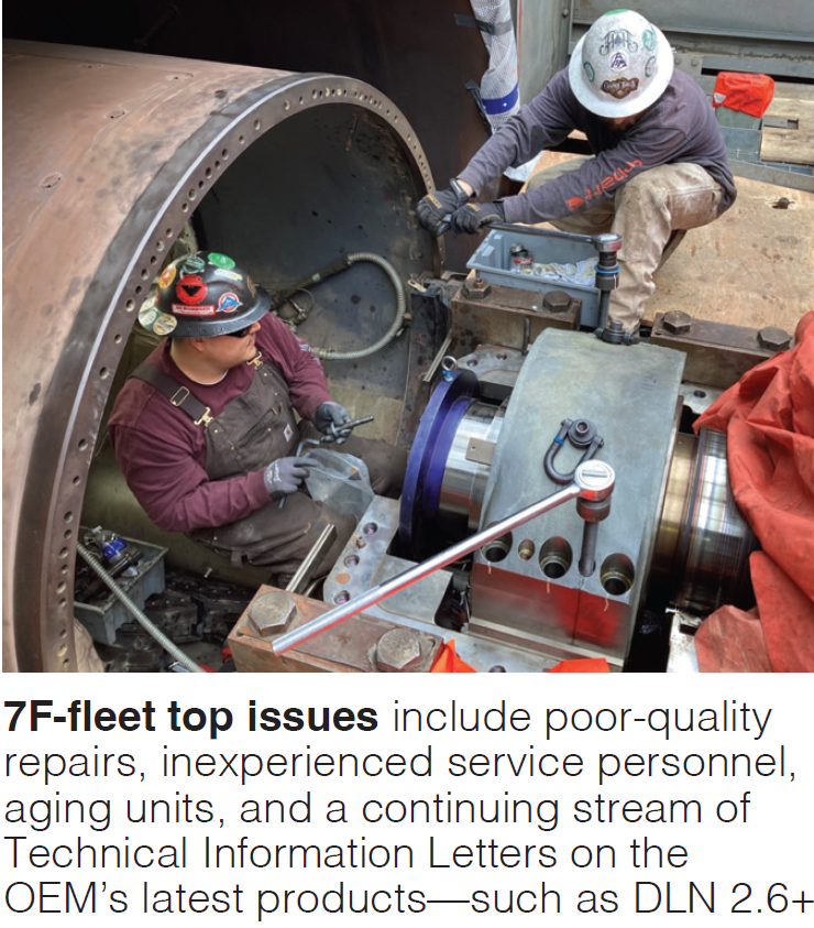

Relative to what was presented at previous meetings, the matrix of issues facing users expanded and the sentiments about the OEM didn’t get any kinder at the 2024 7F Users Group Conference, held in St. Louis, MO, May 20-24. Those wishing a refresh on earlier conference summaries can refer to CCJ, No. 78 (2023) and CCJ No. 74 (2022) or using search function above. Those wishing to participate can attend the upcoming meeting in Birmingham, May 19-23, 2025.
Emblematic of the frustrations are the following near-verbatim quotes from users during the various sessions. Note: More than one user noted that OOEMs and major GT service industry players are facing similar challenges:
  • We’re going to have idle units because of supply chain issues
  • Our recent ST/G outage highlighted the importance of improved collaboration and execution alignment with the OEM because of numerous avoidable issues
  • There appears to be an opportunity to strengthen communication between OEM executive leadership and field operations teams to promote better outcomes
  • Site engineers from the OEM would benefit from additional field experience to better support complex site activities
  • Post-outage, we’ve observed recurring tube leaks, underscoring the need for enhanced quality assurance during OEM departures
  • It takes too long to publish a TIL (technical information letter) after it has been initiated
  • Lead time for critical spares is up to six months
  • In-shop work is a black box when it comes to communication
  • We’re seeing opportunities to improve accuracy in parts fulfillment and ensure alignment with site specifications
  • QA/QC sign-offs on some hardware, such as bolts, could be more thorough to ensure installation integrity
  • Our last outage extended from 70 to 140 days due to stator bar issues, pointing to the need for tighter process controls
  • We’ve noticed consistent resistance when addressing certain issues with the OEM, and see potential in fostering more collaborative problem-solving
  • After replacing a bearing twice annually, we recently discovered through the 7FUG that a long-term OEM solution already exists
  • There’s a lack of clarity on the operational history (starts and hours) of R4P parts, and greater transparency here would enhance confidence and planning

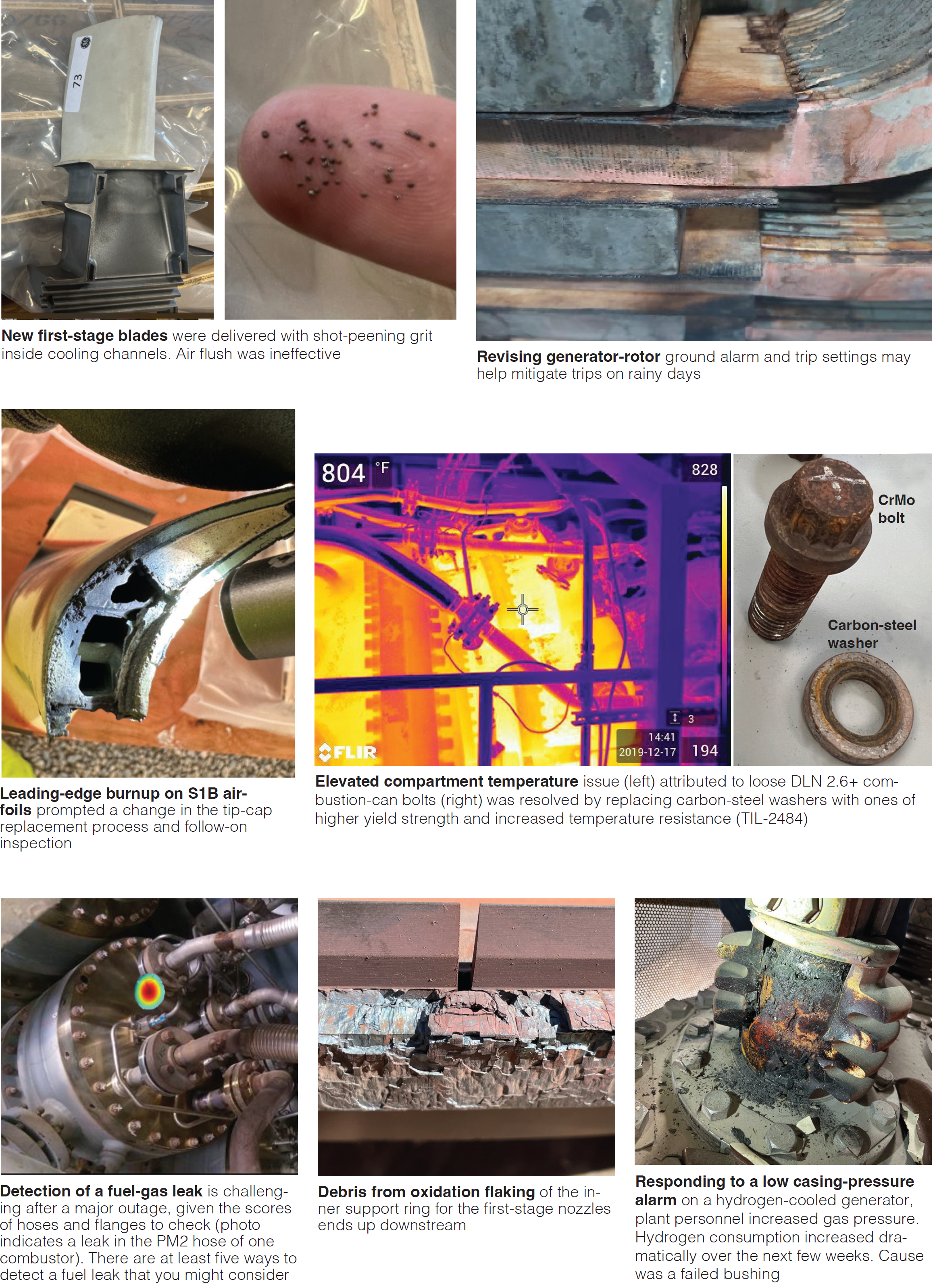

Combustor casing bolt washers. Washers seem so “elementary” until they are not. A large fleet owner/operator (O/O) reported on loose combustor casing bolts in 7F units with DLN 2.6+, initially observed in one unit after only three years operation. Some bolts had “spinning” washers, others were “backed out.”
Loose bolts create leakage pathways and elevated compartment temperatures. Subsequent evaluation showed that the design material was inadequate – it softens over time – and the washers were not properly torqued.
The O/O worked with the OEM to find a modification, resulting in TIL2484, which applies to several dozen machines in the fleet. At conference time, six units had new Inconel (ASTM A437 GRB4B) washers and the bolts’ torquing pattern and sequence was updated for all the units. The bolts are more expensive, and the revised install procedure adds a shift-man of work to an outage. Each unit has 910 of these bolt/washers.
Several in the audience noted that they have had forced outages or delayed operations as a result of this issue and others noted that they experienced elevated compartment temperatures, which were resolved after addressing this bolting issue. The TIL recommends replacing these bolts and washers at the next outage opportunity.
The presenter reminded the audience that the TIL applies to all 7F 2.6 and 2.6+ transition pieces in your inventory, including new and repaired versions. A slide in the deck details the new torquing procedure.

Stage 1 buckets. Presentation began with a review of S1B design changes from the 7FA through the 7FA.05/AGP. O/O Specialists now conduct post IA, precoat, and final inspections for all repaired S1Bs and final inspections for new S1Bs.
One recent finding was that broken reamers from the thermal barrier coating (TBC) process were discovered inside internal cooling channels of repaired S1Bs – the OEM apparently failed to do x-ray or borescope inspection of the final product before shipping. After returning the set, the OEM borescoped 92 blades and 22 had to be replaced with new.
Another finding was shot-peening grit inside the cooling channels of new S1Bs, which could not be removed by air flush. Masking during shot-peening apparently failed to prevent the grit from entering the holes. Again, the OEM did not perform x-ray or borescope inspections before shipping to the site. After they were returned, the OEM did x-ray inspection of 92 blades and 11 had to be replaced with new.

Defects in R4P S1Bs. Simple-cycle dual-fuel 7FA units with DLN 2.6+ and R4P parts, including modified .03 S1Bs, AGP-Tech S1N, AGP-Tech S1S, modified .03 S2B and S2N, began to experience leading edge damage after 300+ FFS and 3000+ FFHs. To pre-empt issues at the next outage, the O/O sent S1Bs in inventory out for x-ray inspection of the tip caps. Prior to late 2023, the OEM did not do x-ray inspection of tip caps.
Slides include photos from inspections but the list of findings include: internal cracks as long as 0.867 in., backwall strikes from foreign objects, push-through on internal walls from electrical discharge machining (EDM), and small cracks on trailing edges.
As a result of these inspections and RCA work, the OEM now performs x-ray inspection of all R4P S1B replacements and changed the tip-cap replacement process to (1) include new gages to ensure correct angle of weld prep and (2) more accurately locate the internal ribs to assure the correct cut of the tip cap over the ribs for welding.
Presenter stressed that they don’t yet know whether these changes will prevent leading edge damage caused by tip cap burnup. The first set of blades was installed in spring 2023 and were scheduled for BI in the fall of 2024. An audience member asked if there were any limitations on starts between BIs and the answer was no.
The presenter, in wrapping up, noted that the set of R4P S1Bs taken from a fall 2023 outage showed additional damage, including platform cracks on 12 pieces. RCA is on-going.

Leakage in water cooled generator. User recapped assessment of moisture, dust, and oil ingress and its impact on the insulation of the water-cooled generator rotor. During heavy rains and high humidity, the insulating capability drops to levels which can trip the unit on rotor ground fault. Site lost over $1-million in revenue in 2023 as a result of this issue.
A variety of actions were taken to prevent this situation, including beefing up frame-to-base sealing joints, adding external heaters, upgrading an undersized mist eliminator, relocating the generator bearing filter outside the “load tunnel,” adding steel strip overhangs to reduce moisture ingress, revising generator insulator trip settings, and running the unit on full spin no load for several hours to help restore the insulating levels. See slides for photos showing where the hardware modifications were made.
One audience member noted that they had a similar issue and to be careful with the changes to the insulator trip settings. Another referred to a 10-page document from the OEM addressing this issue.

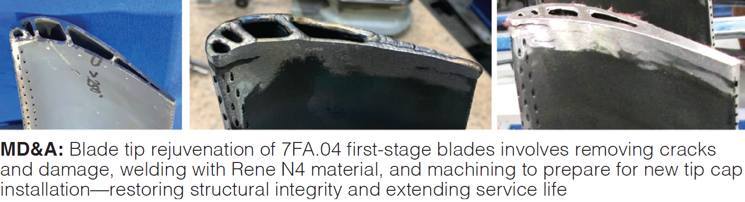

7F outage planning & solving issues. Highlights of this presentation by Richard Rucigay on developing a quality outage RFQ (request for quote), are NDE inspection requirements, especially TIL-related items; a very detailed bullet list of NDE inspection considerations categorized around the type of outage (BI, combustor/HGP, or major); description of a portable in-situ air flow test stand (PATS) which can replicate shop air flow bench testing in the field; and a compressor stator vane hook fit wear solution called vane pinning. PATS offers users additional data on fuel-nozzle assembly health.
Pinned vanes are said to avoid a compressor casing replacement and a longer outage and have shown negligible effect on resonant frequencies. No failures have occurred in 200 installations (at conference time) and the fleet leader exceeds 100k operating hours.

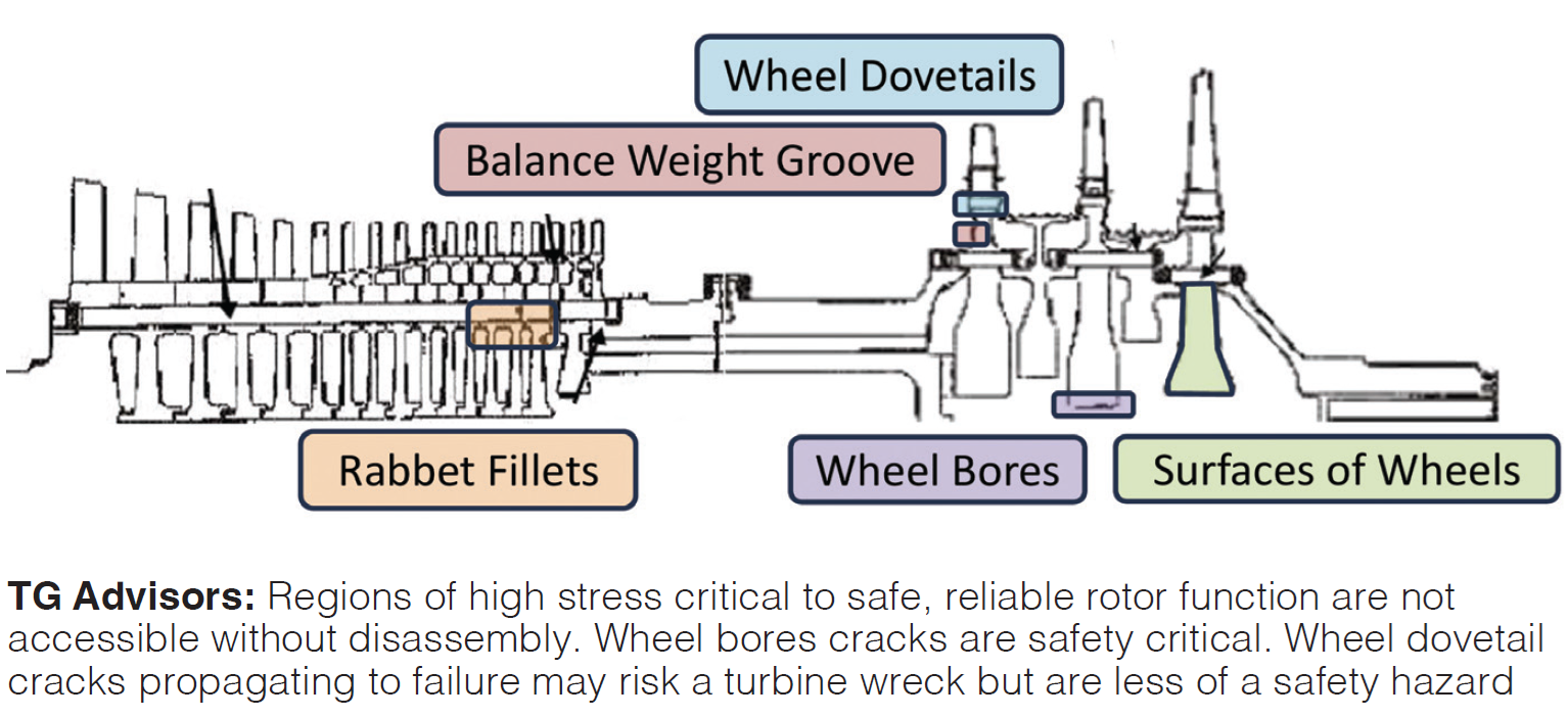

7F rotor life assessment and extension. Mark Passino says if your rotor is approaching the 5000 start/144,000 hour threshold (per GER3620), you’ll want to consider a complete rotor life assessment (RLA), which MD&A says can be accomplished in 12-16 weeks, as well as MD&A repairs, modifications, and enhancements. The RLA covers known 7FA rotor issues, including these major ones covered in the slides: compressor blade dovetail cracking in rows 12-17, turbine disc cracking, and design enhancement for the 1-2 spacer, labeled a particularly high-risk component.
7FA RLE standard plan and supporting parts. It takes up to two years to replace a rotor, as there are long lines for forgings, according to David Fernandez. In lieu of replacement, you can consider rotor life extension (RLE – reusing the rotor with added maintenance and inspection outages or reusing the rotor with modifications. MD&A maintains a strategic inventory of all critical forged components, including compressor blade spacers, bolting hardware, and R1-R17 components. At conference time, R0 parts were on order.

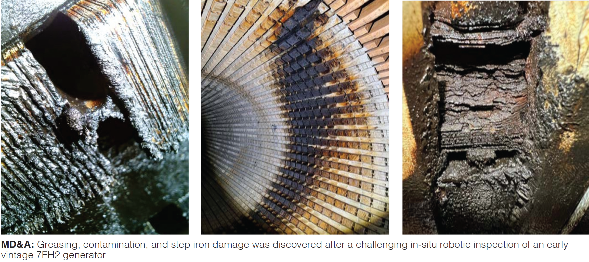

7FH2 step iron liberation. Early 7FH2 generators have an iron liberation defect acknowledged by the OEM (TIL2260) because the units were torqued to a lower threshold (2000 ft-lbs) than later units (3000 ft-lbs). Peaking duty leads to added thermal stresses and risk of liberation as units age.
This presentation by James Joyce covers the discovery of step iron liberation during a challenging in-situ robotic inspection of a 1996-vintage unit (204.5 kVA), an assessment of repair options, and the subsequent partial restacking and full stator rewind.
Specifically, MD&A:
  • Stripped existing windings and removed the core compression flange (CCF) and three full packs of core iron
  • Cleaned all stator components of ferrous material deposited during operation
  • Replaced core iron and compressed the CCF to the recommended threshold
  • Performed core loop test and thermally seasoned core to remove oil and ensure that the torque values were adhered to.
  • Applied low-weeping epoxy to the newly installed core iron laminations
  • Performed full stator rewind
MD&A recommends that lower serial number 7FH2 generators with high number of starts get a key bar torque test.

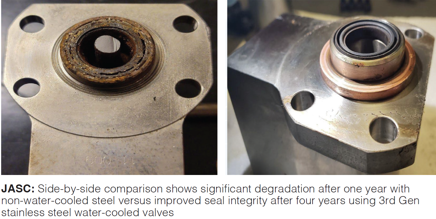

Understanding the impact of BOP equipment on liquid fuel system reliability
JASC
Schuyler McElrath (RIP)
The esteemed McElrath, who passed away early in the year, reviewed JASC’s 3rd generation fuel system improvements (Fig 2) which seek to maintain seal integrity and prevent leakage in the liquid fuel, purge air, and water injection piping and valves. Included in this iteration are heat sink clamps on fuel lines in the turbine compartment and stainless-steel valve housings.

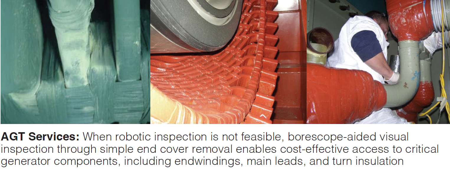

Generator robotic inspection – benefits, challenges and contingencies
AGT Services
Jamie Clark
Industry resources for major work on the 3000+ generators built since 1995 are constrained. Clark gives scheduling tips for planning major and minor outages and inspections, especially how far in advance to lock in resources since repair durations can take from one to seven weeks depending on scope. Clark reminds users that the catch phrase, “robotic inspection,” refers to many different robotic devices and generators with different core lengths, air gaps, wedge depths, etc.
