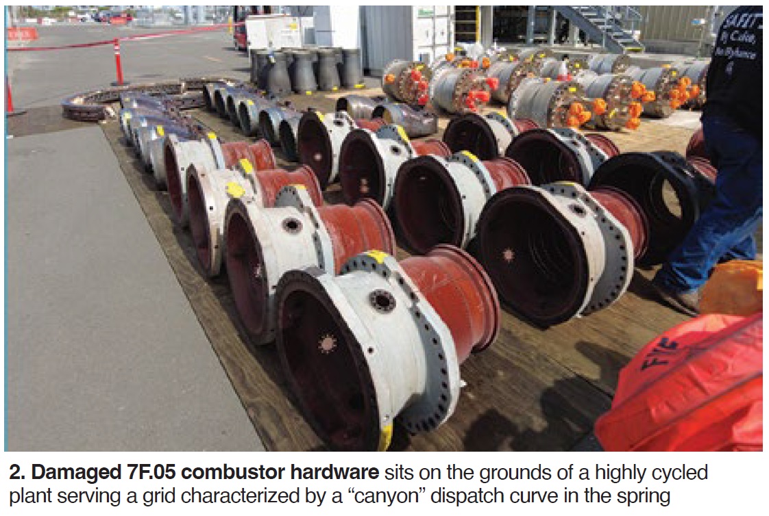

Several representatives of utility and non-utility power producers presented on their O&M experiences with advanced gas turbines on the second day of the meeting (Fig 2). The information shared with attendees was viewed as of considerable value to owner/operators, based on comments shared by attendees with the editors. Unfortunately, on-going investigations and pending litigation militated against CCJ’s coverage of this material both here and online.

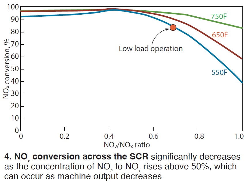

Toback reported on a case study of elevated NO₂ concentrations at an advanced GT plant (Fig 4). The plant was experiencing double the design ammonia flows at low loads, and temperature problems with the ammonia vaporizer at high flows. All of the catalyst samples tested showed excellent results so it wasn’t a question of catalyst quality.
Here’s a cause of non-performance which may not be as familiar as others: Exposed insulation upstream of the SCR affects performance because loose catalyst particles mask catalyst surfaces and plug ammonia injection grid (AIG) lances and ports.
Another common problem is that lower load operation, and lower temperature across the CO catalyst, induce more oxidation of NO into NO₂. Higher NO₂ levels, in turn, require more “work” from the downstream NOₓ catalyst. However, if you add catalyst to compensate for the higher NO₂, you increase the pressure drop. Catalyst performance drops when NO₂/NOₓ is greater than 50%.
In the case study, the additional catalyst needed to compensate for high NO₂ increased pressure drop by 0.6 in. H₂O. On the bright side, SCR performance improved considerably after the catalyst surfaces and the AIG nozzles were cleaned.

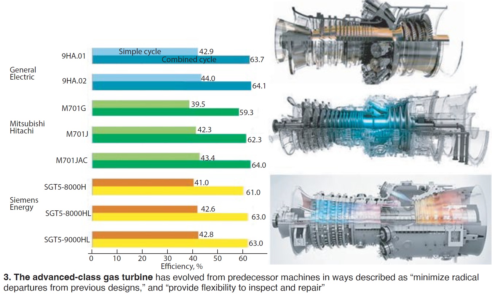

SI on rotor design evolution. Matthew Ferslew of Structural Integrity Associates (SI), covered the evolution of rotor design and the challenges imposed. Rotors have become lighter and lighter, even as megawatt output, efficiency, and the need for greater operating flexibility (that is, more starts and stops) have increased.
Lighter alloy steels have to operate at higher and higher temperatures which impose new creep, thermal-gradient, and fatigue regimes. Ferslew used the term “chaos of design” to describe how design objectives often conflict.
He emphasized the importance of lifecycle management, especially accurate condition monitoring and predictive analysis, to extend the life of these assets and prevent failures. He also suggested the intriguing concept that, in a high-starts world, perhaps the industry needs a rotor expressly designed to start three times daily and/or an effective thermal-gradient management methodology when 10-minute starts are required.

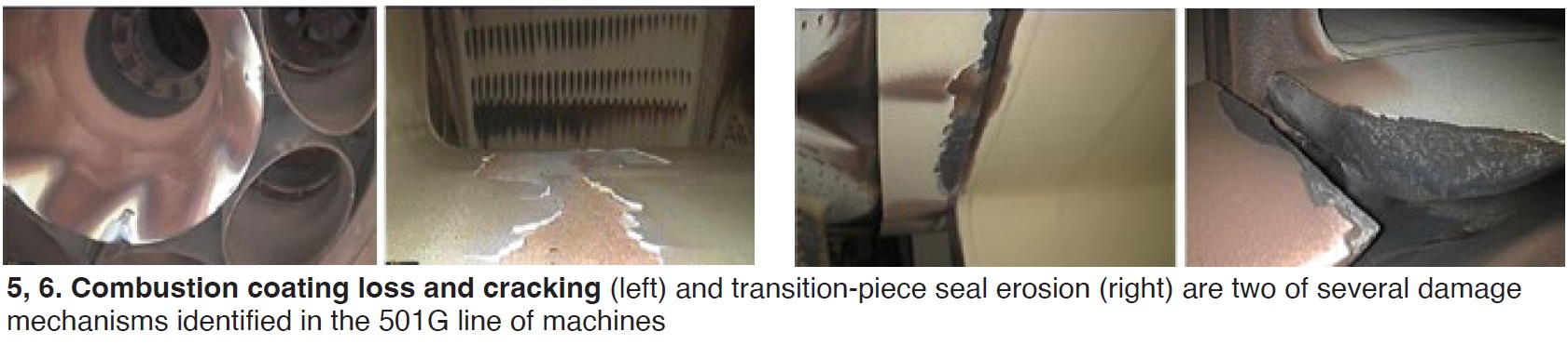

Advanced Turbine Support on M501G observations. Advanced Turbine Support LLC trained its prodigious inspection capabilities on the M501G, GAC, and GAC enhanced- response machines. The photo-rich slides illustrate compressor icing damage, combustor coating loss and cracking, TP seal erosion, turbine-vane platform erosion, and turbine-section coating loss and base-metal cracking (Figs 5 and 6).
Regarding the last item, one user commented that they have also seen this level of cracking and as a result did not make their scheduled outage interval. The parts have to be replaced with newer versions but they aren’t sure the OEM has determined the root cause or long-term solution. Clogging of cooling holes causes the problem. OEM is experimenting with filters to remove the debris.

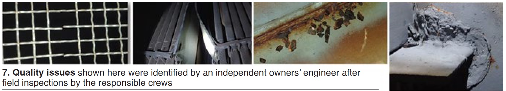

Gas Turbine Specialists on outage oversight. The cost of quality (or lack thereof) in the utility sector was said to be 15% of revenue. Foreign material left in the turbine after an outage can cost up to $100-million when implicated in a catastrophic loss. With these and other alarming stats, Joe Mitchell of Gulf Turbine Specialists, stressed the importance of, and role for, an independent owners/engineer (O/E) during outages (Fig 7).
He showed a photo of a water bottle left in the generator discovered after the OEM field inspection had taken place. In another case, the O/E identified a dislodged end-turn block in the generator after the generator specialist was released from the site and the OEM field inspection team had completed its rounds.
