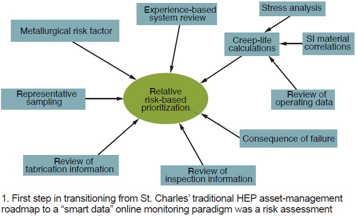

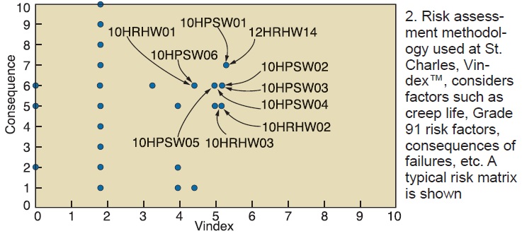

SI’s first step in making a timely transition from the facility’s traditional HEP asset-management roadmap to “smart data” monitoring was a risk assessment. The methodology used is known as Vindex™ (for vulnerability index). It considers factors such as creep life, Grade 91 risk factors, failure consequences, etc (Fig 1).
This approach incorporates inspection history and key component characteristics using structured and consistent methodologies that can be used across several piping systems. Each weld, or location of interest, was assessed according to component damage potential and consequence of failure.
The Vindex provided risk scores for each weld and for each pertinent system within SCEC’s PlantTrack database. Risk scores determined the HEP locations that would benefit from active online monitoring. The engineering study concluded t/cs should be installed at 10 locations (Fig 2) and active online pipe-hanger position monitors at nine. The latter provide real-time hanger-position data to the PlantTrack system to better understand and predict high-stress locations within the piping system.

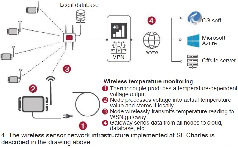

The wireless sensor network consists of two primary components: (1) sensor nodes that collect local sensor data and transmit it wirelessly to (2) a gateway that transfers the data to the PlantTrack database. Fig 3 illustrates SI’s data collection node, highlighting several of its features. Each node has multiple sensor channels and is capable of collecting data from a variety of sensor types. The single node can accommodate up to nine different standard t/cs.
The wireless data-acquisition node is installed in close proximity to the monitored component, and all thermocouples are hardwired to the node. Data from all nodes are transmitted via a 900-MHz wireless protocol to a locally installed Wi-Fi-enabled gateway, which stores the data in a local database until they are transmitted successfully to the PlantTrack cloud database. Once transmitted offsite, data can be accessed through SI’s PlantTrack web interface. Fig 4 summarizes the general wireless sensor network infrastructure implemented at SCEC.
