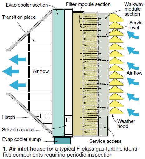

Evap coolers
Virtually all evaporative coolers for GT inlet service are of the recirculating type and located downstream of the filtration system. The required water inventory is maintained in a sump at the bottom of the air inlet house (refer back to Fig 1). Water is pumped from the sump to a distribution header at the top of the cooler and it falls by gravity down through the media and back to the sump.
Air flows approximately perpendicular to the falling water and its sensible heat is transferred to the water, becoming latent heat as water evaporates. Resulting water vapor mixes with the air stream, carrying the latent heat along with it.
The dry-bulb temperature of the air is reduced because it gives up sensible heat. Wet-bulb temperature is not affected by the absorption of latent heat because water vapor enters the air at the wet-bulb temperature.
System chemistry is maintained in much the same way as it is for a wet cooling tower. Water specifications provided by the evap cooler supplier, plant chemist, and/or an outside consultant have, at a minimum, limits on turbidity, pH, hardness as calcium carbonate, and the concentration of sodium plus potassium. Makeup water is added to replace evaporation and blowdown losses.
Makeup water specifications are important as well. It is important not to use straight demineralized water in evap coolers as you would in a fogging system. Such aggressive water softens the media and may damage the evap cooler framework, depending on the material used. Some plants use city water where available and of suitable quality, others might mix demineralized water with that from another source. Consult the media supplier to be sure you’re going down the right path.
Spend quality time evaluating media alternatives both for new and existing systems; product offerings are always changing, usually for the better. Regarding the evap cooler now serving at your plant, recall that suppliers recommend changing media after three to five years of service to maintain top performance.
Several types of media for GT service are offered by Munters Corp, Ft Myers, Fla, considered by most users as the industry leader (www.munters.us).
The company promotes a special product for gas turbine applications, citing high efficiency, low pressure drop, low drift, and other attributes. It reportedly can be used in applications with average face velocities of up to 750 ft/min.
Finally, don’t forget the drift eliminator. While water carryover from a properly designed, installed, operated, and maintained evap cooler should be negligible, critical parameters change over time and a drift eliminator immediately downstream of the media is necessary to protect the health of both the air inlet system and the compressor.

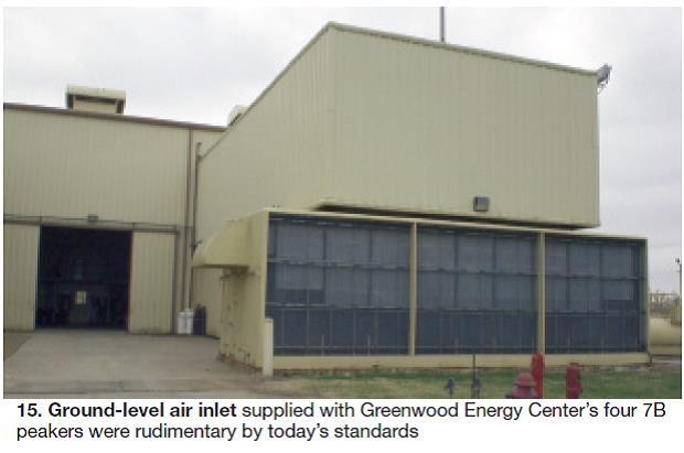

When Greenwood Energy Center (GEC) was built in the mid 1970s, long-distance road running was just coming into its own and there were more than just a few people participating in their basketball sneakers (Nike was incorporated in 1972). Today, you’d probably be hard pressed to find anyone in canvas tops running a marathon. The reason is obvious: High-tech shoes are critical for success.
The same is true in the generation business, which seems to grow more competitive by the day. Unless your facility has a great grandfathered grid deal, you’re just not going to dispatch ahead of GTs with modern “front ends” capable of wringing the last few Btus out of their fuel.
The first of GEC’s four simple-cycle, distillate-fired GE 7Bs began commercial operation in 1974, equipped with a rudimentary (by today’s standards) ground-level evap cooler familiar to many readers (Fig 15). In 1996, the units were converted to dual-fuel.

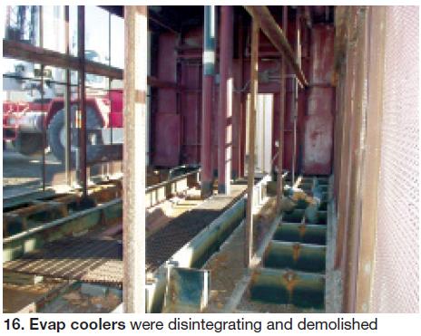

Problems attributed to age and continued use of old technology included the following:Corrosion of the internal perforated galvanized-steel wrappers for the air inlet houses was virtually impossible to arrest and metal flakes and chunks were being ingested by the compressor. Maintenance procedure was to scrape off loose metal during the annual spring outage, sweep it up, and run another year. Tom Miller, who manages the Combustion Turbine Dept for Missouri-based owner Kansas City Power & Light Co (KCPL), said Greenwood personnel were filling a 55-gal drum with debris annually (sidebar).
- Reduced peak output.
- Reduced efficiency.
- Compressor FOD (foreign object damage), requiring replacement of R1 blades.
- Snow blinding of barrier air filters during blizzards.
Bill Grace and his colleagues at Tulsa-based Braden Manufacturing LLC got their first glimpse at GEC’s air inlet challenges in 2005. He recalled that the owner, Aquila at the time, was leaning towards taking the inlet air house’s internal surfaces down to bare metal and coating with epoxy – a fast and inexpensive way to keep foreign material out of the compressor.

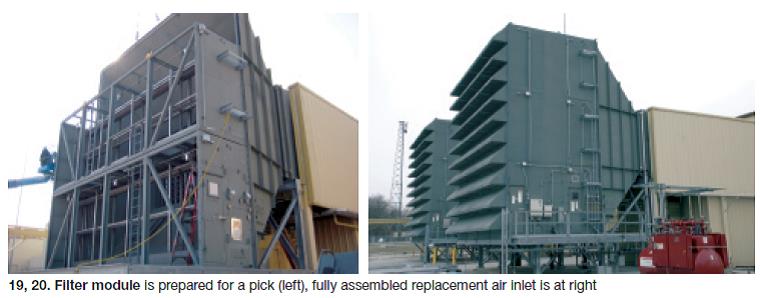

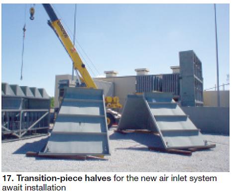

But a thorough engineering assessment revealed that the evap cooler and the inlet house had, practically speaking, reached end-of-life. The project then evolved from a repair job to a new intake system. Braden proposed replacing the ground level air inlet with an elevated system having Type 304 stainless steel internals. The company also suggested switching from barrier filters to a pulse-type filter house – this to prevent a unit trip on high delta p during a blizzard.
Braden was awarded a turnkey contract to install new filter houses on the four Greenwood engines – one at a time. The upgrades were completed between 2006 and 2008 (Fig 17).

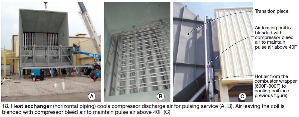

The proverbial “fly in the ointment” for this project: There was no compressed air available for pulsing the filters. Aquila didn’t want the cost of a compressed air system added to the budget so engineers came up with the idea of tapping into the combustion wrapper. Certainly a viable idea, but that air was at about 750F and far too hot for cleaning filters.
Miller said payback on the retrofit was faster than expected because the turbines produced an additional 3 to 4 MW each with the new evap cooler; the units get capacity payments (Figs 19, 20). Taking air from the combustor case for pulse cleaning has virtually no economic impact. The ability to run through the horizontal snowstorms that often occur in this part of the country is very important.The solution: A heat exchanger, installed in the filter house, to cool pulse air to 95F (Fig 18a and 18b). That worked fine until winter, when the plant experienced freeze-up of the pulse-air system. The fix was to blend some compressor bleed air with the air leaving the heat-transfer coil to maintain the temperature of pulse air above 40F (Fig 18c).
