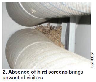

A weather hood is provided at the entrance to the air inlet struc­ture for most gas turbines today. Its purpose is to protect filter elements from direct impingment by rain, snow, flying birds and insects, dirt, etc. Some are equipped with screens to prevent birds and large airborne debris (such as leaves, plastic bags, etc) from entering (Fig 2), moisture separators to remove large water droplets from the incoming air, and coalescing filters or drift eliminators to remove small moisture particles (such as fog).
Inspection goals are obvious: Check the condition of the rain hood and screens, moisture separators, etc, required for trouble-free opera­tion. Also, the inlet heating system, if installed, to protect against icing and filter blinding in winter.

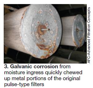

While you’re checking the filter media, inspect hold­ing frames and grid plates, evaluate retaining hardware (Fig 3) and assure proper torque, check the quality of the seal between the fil­ters and the hold­ing frame (caulking might be necessary), and for pulse filters, verify that the filter tripods (yokes) are straight and in the right position (12, 4, and 8 o’clock). Note that yokes often are bent by installers who stand on them; continuous supervi­sion of ongoing work is important.
Readers with self-cleaning fil­ters may recall that the cylindrical and conical filter sections have neoprene gas­kets to help prevent air bypass. In par­ticular, ensure that the gasket between the final filter and tubesheet is airtight. Also important: Verify that solenoid valves, pulse clean­ing controls, com­pressed air, and elec­trical systems are functioning properly.
If you find rusted frames, you have two options: replace (Fig 4) or remove offending rust and apply a suitable coating. Regarding the latter, the method used to remove rust anywhere in the air inlet house is very important (Fig 5). Knowl­edgeable plant maintenance personnel warn against a grit blast because it is virtually impossible to remove all the foreign material before restarting the engine. Use a needle scaler instead.

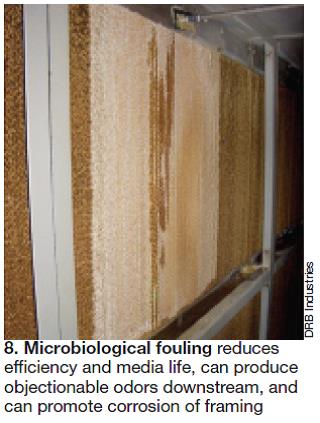

Evap cooler. Inspection of the air side of an evaporative cooler is simi­lar in some ways to that described earlier for air filters. For example, you want to verify there are no gaps between media segments that would allow air and water droplets to bypass the cooler. But here you also want to verify there is no water bypassing the media because that would reduce efficiency. Also, care­fully check water flow rates and dis­tribution. Dry streaks on the media are indicative of poor distribution.
Look at the walls of the air inlet house downstream of the drift elimi­nator. If you see streaking, some­thing’s not right. Cause could be high air velocity, water bypassing the evap cooler, and/or a defective drift eliminator. Important to locate the source of the problem and correct it.
One expert quantified the impact of severe scaling this way: Blocks forming the top row of the media weighed in at 150 lb, or 30 times their original weight. Air velocity below the scaled media was in excess of 900 ft/min.Evap media should last three to five years (depending on conditions), according to the experts at Munters. It’s pretty difficult to miss scaling of the media (note the white scale at the top of the media in Fig 7) and fouling, such as that evident in Fig 8. When you see problems such as these, both of which adversely impact efficiency and reduce the effective lifetime of media, call the plant chemist. Tight­er water chemistry should prevent further scaling; use of a proper bio­cide will eliminate microbiological activity. Sample water regularly—perhaps weekly—to assure system chemistry is within guidelines.
Other signs of media deterioration that demand your prompt attention include a “mushy” rating on the “feel” test and a delta p across the media that is double the as-installed pres­sure drop.

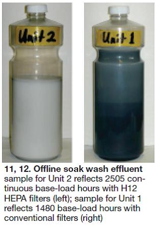

HEPA: an alternative to compressor washing
Relatively few US gas-turbine owner/operators were familiar with the use of HEPA filters for GT air-inlet appli­cations before the V Users Group’s 2007 meeting in Glen Cove, NY. It was there that RWE npower’s John Macdonald explained to the industry how high-efficiency filters could elim­inate the need for online and offline compressor washing. That sounded important to several owners of GE F-class turbines in the room who had been told washing could be an under­lying cause of R0 blade failures.
One concern of attendees was the potential for high pressure drop across the filter bank and its associated cost. But the expe­rienced Macdonald, who is based in the power producer’s UK cen­tral engineering offices, assured the group that the delta-p impact is not as great as most might think—at least based on his rigor­ous analyses.
While an H12 filter could increase the pressure drop across an existing inlet filtration system by 50%, he said, the degradation in power production is relatively con­stant over time and the plant would not get the “big hit” caused by foul­ing.
At the time, he and his colleagues were evaluating the addition of a HEPA stage to the filtration systems for Didcot B’s gas turbines. They were encouraged by the favorable experi­ence with HEPAs at ScottishPower’s Damhead Creek Power Station in southern England, and International Power’s Saltend Power Station, near Hull in the northeastern part of the country. Neither plant was washing online or offline.
Macdonald described the arrangement of air filters for RWE npower’s Didcot B, which consists of two 2 × 1 combined cycles capa­ble of producing up to 1360 MW. The facil­ity is located alongside Didcot A, a 2000-MW coal-fired station. The inlet air houses for the Didcot B GTs have rain hoods, followed by coalescers, and two filtration stages (pre­filter and F8 final fil­ter). Coalescers were washed periodically; life of the final filters was about two years. Using this filter lineup, compressors were online washed approximately weekly and offline washed periodically.
The alternative considered by RWE: Retain the coalescer, prefilter, and swap out the F8 filter with an H10. This project was completed only recently, Macdonald told the editors in mid August, so no operating data are available yet. If expectations are met, the H10s could be replaced with H11s or H12s when they reach end of life.
A similar retrofit project is being evaluated at Little Barford Station 2. That site has two GE 9Fs with two-stage static filters, one operat­ing with F9 final filters and the other with H10s. Despite the relatively short operating period for compari­son purposes, performance of the H10 has been measurably better.
Compelling evidence that RWE npower views HEPA filters favor­ably: Combined-cycle units under construction at Staythorpe in Not­tinghamshire and at Pembroke in West Wales are equipped with H12s. The first of four Alstom GT26B-pow­ered, 425-MW, 1 × 1 combined cycles at Staythorpe began acceptance tests in August. Plans are for the entire station, located on a compact brown­field site and former location of two coal-fired units, to be operational by year-end.
The five Alstom GT26-powered, 400-MW, 1 × 1 combined cycles at Pembroke are scheduled for opera­tion in 2012. This site previously supported an oil-fired station since decommissioned.
A little digging revealed that HEPA filters had been installed on several aero GTs—both onshore and offshore—years before they were adopted by the large frame engines. American Air Filter International, Louisville, told the editors about land-based GE aeros being equipped with their HEPA filters as far back as May 1992; an offshore Frame 5 was so equipped in 1981.
Mitsubishi experience. Inter­estingly, AAF is part of a Japanese consortium that considers itself the world’s leading provider of air fil­ters. This connection undoubtedly has facilitated a relationship with Mitsubishi Power Systems. Sev­eral M501F, M701F, and M501G machines have been installed in Ban­gladesh, Hong Kong, Spain, Taiwan, and Mexico with HEPA filters.
A top-level Mitsubishi manager told the editors, “We encourage our clients to use HEPA filters. We have impressive examples in Mexico where one client has them and another next door (exactly the same configuration) doesn’t. Comparisons of compressor fouling and performance deteriora­tion are simply amazing.”
HEPA filters reduce or eliminate the need for online and offline wash­ing, he continued; however, this is an economic decision for the customer to make.
Mitsubishi offers a three-stage system which makes use of the exist­ing prefilter and standard filter and adds a third HEPA stage. But con­siderable effort is required to do this. For example, the air inlet house has to be made larger and structural steel must be reinforced. To avoid major modifications, the company developed an upgraded HEPA filter that can be retrofitted into the filter housing designed for two-stage sys­tems. Typical replacement interval for both systems is one year. Both are designed to remove 99.97% of the particles 0.3 microns and larger.
Careful monitoring both of a tur­bine outfitted with the upgraded HEPA filter, and a sister unit at the site using conventional filters, revealed an average improvement in output of the HEPA-equipped com­bined cycle of 1.7% over the two-year study period; average plant efficiency improvement was 1%.
Translating this to dollars for a M501G-powered 1 × 1 combined cycle operating 6000 hr/yr, Mitsubishi engineers came up with an annual increase in net operating revenue of $1.6 million and a $250,000 annual penalty for the higher-cost HEPA filters. Net gain: $1.35 million. The OEM’s numbers assume HEPA fil­ters are four times as expensive as conventional filters.
