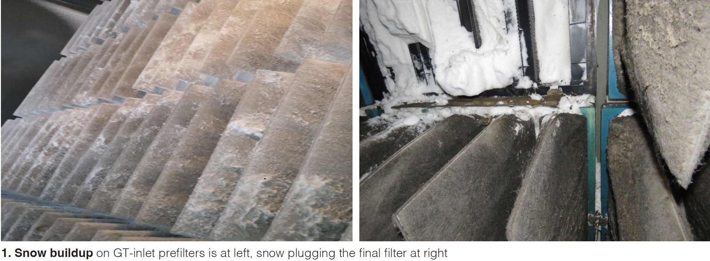

Challenge. Since commissioning, during winter weather events, the gas turbines would have to derate and/or take a forced outage because of snow clogging the compressor-inlet prefilters (Fig 1). The problem persisted with an upgraded filter design, replacing the flat, box-style filters with a reverse pocket design. Through experience, the site developed a winter-storm protocol to derate the plant when the inlet-filter differential pressure (DP) started to rise. A combination of plant staff and contractor personnel were made available to physically remove the snow from the filters during weather events. Even with the proactive measures in place, at least one of the GTs generally would be forced offline.

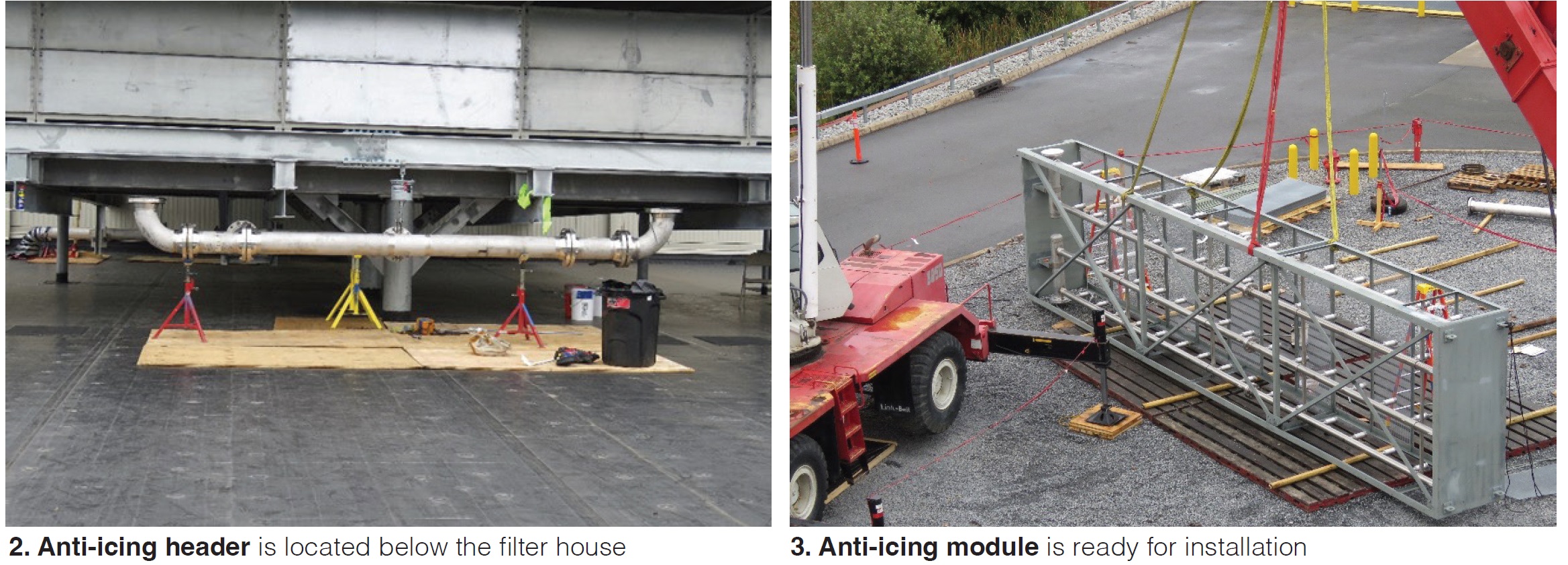

Solution. Valley Energy Center and Competitive Power Ventures personnel worked with PSM to engineer and implement an anti-icing system that would tee off the existing compressor inlet-bleed-heat (IBH) system. The system tees into the IBH piping upstream of the OEM’s block valve inside the gas-turbine package (Fig 2). The anti-icing system, when in service, directs air from the GT’s compressor to the front of its inlet prefilters via an array of patented stainless-steel nozzles.
The nozzles include silencing media and perforations to disperse the air, thereby creating a curtain of hot air that melts most of the snow ahead of the prefilters. The nozzles are threaded to stainless-steel piping inside carbon-steel modules bolted to the face of the existing inlet structure (Fig 3).

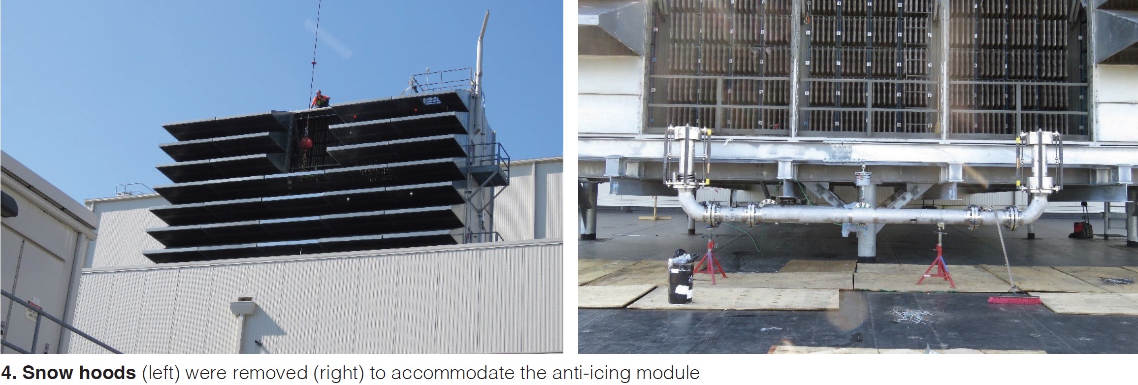

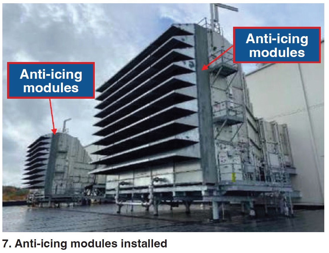

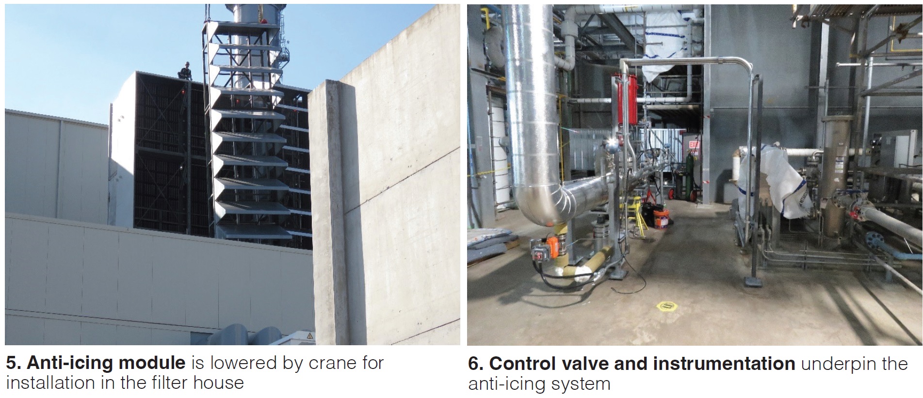

Structural steel was added to support addition of the modules. In total, five 9 × 45-ft modules were added to each inlet house (Fig 4). The modules were flown to the roof using a crane (Fig 5) and then bolted in place before removing the modules from the crane hook. The modules contained the stainless-steel piping that the nozzles were threaded into.

Additionally, during the outage, a PSM subcontractor installed all the instrumentation and ran all the control cables for the instrumentation and valves to the I/O cabinets (Fig 6). CPV Valley personnel made the final connections in the I/O cabinet. After all connections were made, loop checks were performed to verify all the wires were landed to the correct points.

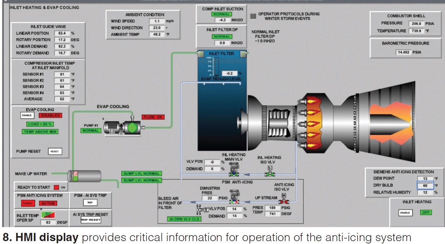

Before the first use of the anti-icing systems, a draft operating procedure was created and reviewed with operations personnel so that they were familiar with the permissives required to place the system in service and what parameters to monitor while the system is operating. During the winter, as site personnel became familiar with how the system operated, several revisions were made to the procedure, and parameters were adjusted in the logic.

Comparing GT performance to a snow event on Feb 27-28, 2023 that caused one unit to shut down, the plant was able to operate with greater availability during the first 2024 storm because of the anti-icing systems. Review of the DCS historian data (Fig 8) captured during the 2023 storm revealed that inlet-filter DP had climbed to more than 2 in. H2O on both units while limiting plant output to a low of approximately 200 MW.
During the first event in 2024, with the anti-icing systems in service, the DPs for both GT’s inlet filters stayed around 1.3 in. H2O (with the exception of a short spike to 1.8 in. on one unit). Plant output stayed above 520 MW for the duration.
