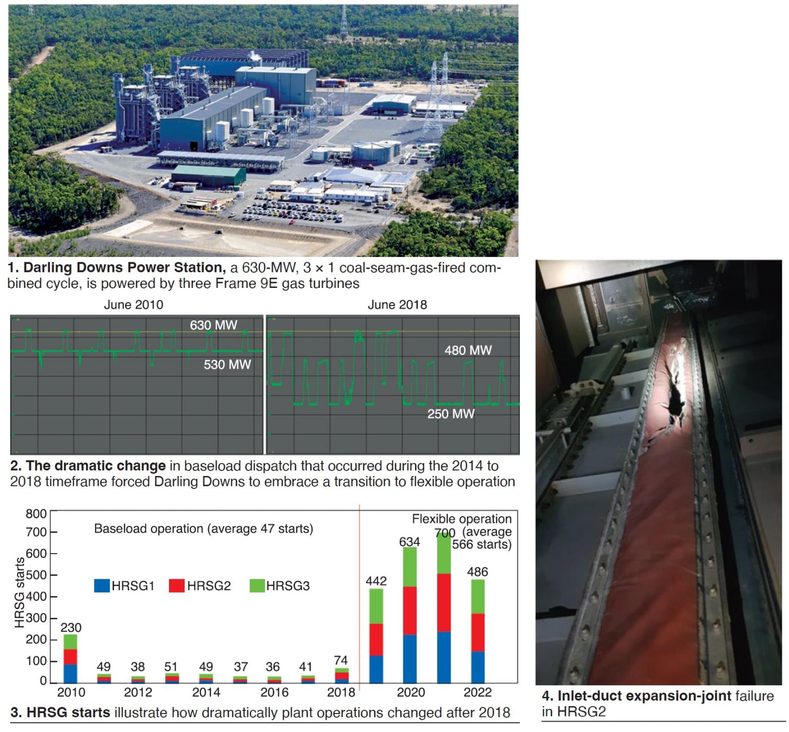

Darling Downs
The Darling Downs Power Station in Dalby, Queensland, is a 3 × 1 coal-seam-gas-fired 630-MW combined cycle with GE 9E gas turbines, a two-stage GE 270-MW steam turbine, and air-cooled condenser—all commissioned in 2010. Origin Energy’s Ashwin Shinde discussed the past four years of movement into flexible operations, specifically plant alterations and changes to both operations and maintenance.
The three horizontal-flow, dual-pressure HRSGs (Fig 1) were supplied by NEM, Netherlands. Water chemistry is ammonia-based AVT(O).
Darling Downs was originally designed for baseload operation. By 2018, it had to begin adjusting to flexible operation (Fig 2). Average annual starts have moved from 47 in early years to 566 since 2019. Annual total-plant running hours in baseload approached 20,000. In flexible operation, the annual average reduced significantly to 11,365 (Fig 3). Startups and downtime therefore became major operating and equipment concerns.
This led to some physical plant changes.
The main steam control valves were modified to avoid stop-valve stem erosion. HP and LP stop-valve actuation was added in 2020 to retain heat in the HRSGs following shutdowns. Also in 2020, the chemistry control room was upgraded to more accurately monitor cycle chemistry.
The next year, HP-bypass warming-valve actuation was added along with thermocouples to closely monitor main-steam pipework temperatures.
Controls and procedures also began to change.
Sky-vent valve operation was modified to improve pressure and temperature control, and to prevent cold steam from entering hot pipework. Startup drum control was used to avoid oscillations and swelling. Superheater drain and drip-leg valve opening times and durations were changed to improve condensate evacuation. Attemperator operating philosophy was modified to control steam-to-turbine temperature matching, and ramp rates were reduced and more carefully controlled.
Minimum warmup load was reduced from 20 to 10 MW to improve HRSG warmup control. For the steam turbine, the original (OEM) temperature matching program was replaced with a lower-inlet-pressure control setpoint and higher inlet-steam-temperature roll permissive.
A control-loop design change was needed to improve duct-burner response to the automatic generation-control setpoint.
The main-to-auxiliary steam supply setpoint was reduced to allow for continuous operation of the auxiliary boiler and maintain vacuum during shutdown.
Maintenance schedule changes also were implemented, and a detailed risk-based inspection (RBI) program was launched—including cycle chemistry reviews.
Shinde then reviewed component failures that have occurred during the past four years of flexible operation:
  • HRSG2 LP economizer drain leak.
  • HRSG1 LP economizer upper header leak.
  • HRSG2 inlet-duct expansion-joint failure (Fig 4).
  • HRSG1 and 2 LP economizer differential-pressure-gauge impulse line sheared.

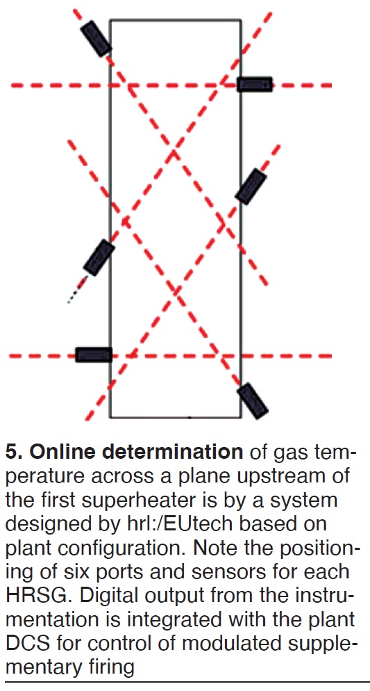

To do this, effective control of duct-firing rate and gas temperature is required for safe and effective operation, and to not overheat the final superheater tubes. Thus, advanced temperature measurements were required.
HRL joined with EUtech Scientific Engineering to integrate online monitoring of HRSG exit gas temperatures (Fig 5). The system at Diamantina is installed across a plane upstream of the first superheater.
This setup allows:
  • Optical measuring; thermal radiation of CO/CO2 is used to measure temperature.
  • Temperature measurement from 750F to 3630F.
  • Single-point and 2D/3D measurements using multiple sensors.
  • Digital output for integration with plant DCS.
  • Easy installation; robust service life.
Using six ports and sensors for each HRSG gives output with either one or two burners in operation.
A few benefits:
  • Allows operation near maximum temperature limits without exceeding maximum allowable gas temperatures (protecting superheater).
  • Allows maximum steam-turbine and plant load.
  • Allows operation of steam turbines at steady load with operating flexibility achievable through gas-turbine and steam-flow load modulation.
  • Allows control of modulated supplemental firing.
Clayton’s summary: “Integration of online monitoring along with a new control strategy has enabled full modulating control of the supplemental firing system. These improvements have led to enhanced flexibility to maximize output and meet network swings in electricity demand.”

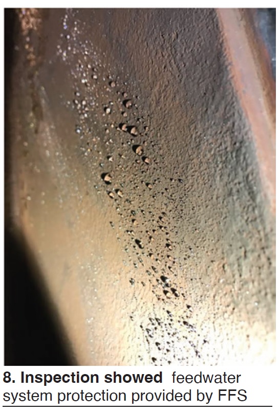

AGL Energy Ltd, Australia’s largest electricity generator, began a “film-forming journey” in 2019 at Torrens Island B. The four 200-MW gas-fired, natural-circulation drum boilers are constantly cycled and face possible “mothballing.” Torrens Island A is already mothballed.
The purpose is offline protection for short- and long-term standby.
AGL’s starting point was (and remains) Section 8 of IAPWS Technical Guidance Document 8-16 (2019), Application of film-forming substances in fossil, combined-cycle and biomass powerplants. Get your copy of this TGD gratis at www.iapws.org.
AGL’s Brad Soutar explained the overall dosing program at Torrens Island:
Station A (closed)
  • Dosing varied for 3-6 months prior to mothballing.
  • Dose rates calculated at 1 ppm in feedwater.
Station B1 (mothballed; closure by 2024)
  • Dosed for 3 months prior to mothballing.
  • Dose rates calculated at 1-2 ppm in feedwater.
Stations B2, 3, and 4 (available; recent decision to retain)
  • B2 setup installed.
  • B3 and 4 installations in FY23.
Product used is Nalco Powerfilm™ 10000 (filming corrosion inhibitor). Initial inspections showed adequate protection of the feedwater system (Fig 8) and negligible impact on water chemistry. There has also been a reduction in corrosion-product transport during startup. Upcoming plans include more inspections to monitor effectiveness, and possibly increased dosage rates and frequencies.
AGL’s Liddell power station houses four 500-MW forced-circulation drum boilers firing black coal. Units suffer significant challenges with tube failures, and frequent chemical cleaning. Dosing began in 2020.
The objective is to reduce boiler oxide growth by decreasing iron and copper corrosion-product transport. (Lindell has copper-based condensers and LP heaters.) Powerfilm 10000 is dosed after the condensate polishers with polishers in service. Dose rate is 1 ppm based on boiler full load.
Soutar discussed a few outcomes:
  • No condenser resin fouling has been detected. There has been improvement in feedwater iron transport, but feedwater copper transport results are inconclusive. Boiler-tube oxide thickness has stabilized, and future testing will include oxide density.
  • Future work also includes an increased dose rate to 2 ppm.
  • Two other plants, Loy Yang A and Bayswater, are in the early stages of dosing and examination. Soutar stressed the need to begin with a formal, detailed review process, including accurate baseline data. He stated: “Success is seen at the end, but stems from the start.”

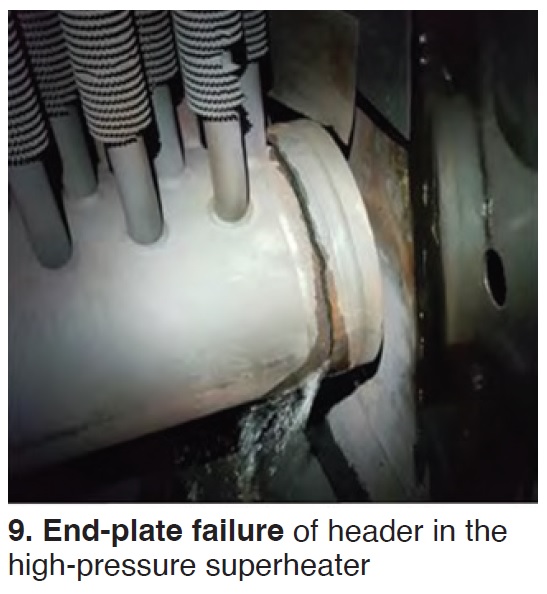

Aging high-pressure headers
HRST’s Brian Craig stressed the importance of careful assessment for aging high-pressure headers. He began with a key point for all: We are seeing an increase in failures because of the accumulation of cycles and operating hours on 20-year-old equipment. Specific to HP superheater and reheater headers, he added the factor of risk to plant personnel.
“Header geometries include tube hole penetrations, branch connections, hanger lug welds, and end cap welds, all of which can create failure risk areas,” Craig explained. “Some OEM header end caps are a serious concern, because of their weld joint design.”
“In general,” he said, “failure risk is elevated in units that are more than 15 years old or have more than 1000 starts.”
Craig walked everyone through specific examples recently seen by HRST and stressed that “some have been analyzed for root cause, and some have not.”
He offered an example where the end cap was correctly manufactured according to the ASME Code (and acceptable to AS1228/AS1210) but failed after more than 2000 cycles. The root cause was a lack of fusion that cannot be avoided in this design. This led to a stress concentration at the gap root where a fatigue crack was able to initiate and propagate to failure (Fig 9).
Other end plate failures occurred in the same HRSG, and some of these liberated, posing a significant risk to personnel.
While the HRSG presented had seen a significant number of cycles, many HRSGs in Australasia (and globally) will approach these cycling levels soon and those with this particular design should inspect for this type of cracking.
Craig also discussed improper test locations and alternatives.

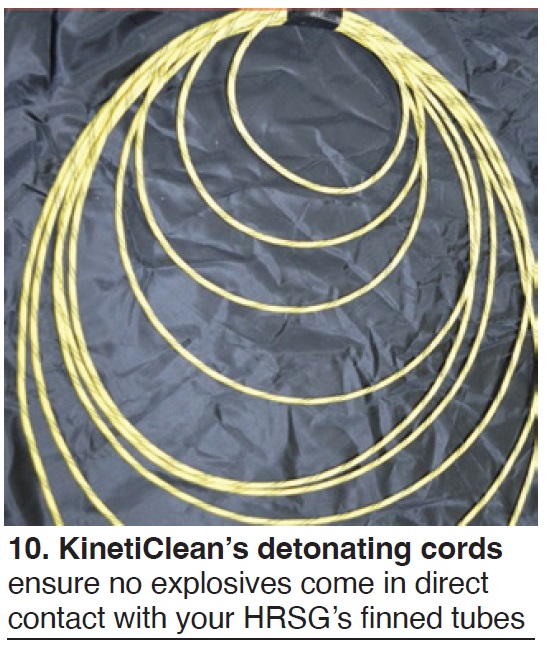

KinetiClean
Jeff Bause, president and CEO of Groome Industrial Service Group (US), was in Brisbane to introduce KinetiClean™, a new shockwave system for cleaning HRSG finned tubes.
KinetiClean uses a detonation-cord curtain (Fig 10) and automated high-pressure, high-volume air jet system to clean the tubes, followed by in-house debris removal and disposal services.
Benefits include reduced backpressure and increased heat rate, along with increased HRSG efficiency and flexibility. Bause presented specific case studies to support the use of this new cleaning system. He also explained Groome’s capabilities for SCR/CO catalyst cleaning, repacking and replacement; AIG retrofitting and cleaning; CO acid/water washing; ACC and cooling tower cleaning; and permanent sampling grid installation.
