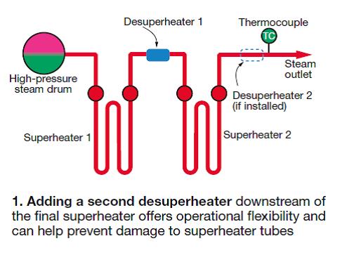

Another possible solution is to install a second desuperheater downstream of the final superheater section (Fig 1) to reduce the amount of spray injected by the primary desuperheater.

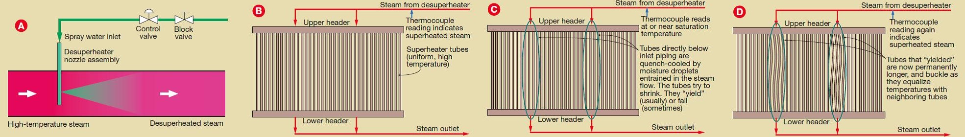

Understanding how a poorly designed, installed, and/or operated desuperheater can cause tube failures in the superheater or reheater of your heat-recovery steam generator (HRSG) is made simple by following—in sequence—the four sketches here.
The first illustration shows the key elements of a typical desuperheater used in combined-cycle service. Note the block valve, which should be installed to ensure tight shutoff when the desuperheater is not in service. The Class IV-shutoff control valves typically specified for HRSGs intended for base-load application often wear in the cycling service common today and may not close completely when the desuperheater is “off.”
A properly designed desuperheater has atomizer nozzles that (1) ensure against the formation of droplets too large for complete vaporization ahead of the superheater and/or reheater headers, and (2) produce a spray pattern that fills the pipe uniformly, as shown, to minimize the potential for thermal gradients. Important to remember is that your desuperheater should be installed in a straight section of pipe two to eight pipe diameters in length upstream of the nozzle assembly, 12 to 20 diameters downstream of it.
Sketch B illustrates normal operation. Steam flowing into the upper header of the superheater or reheater contains at least 50 deg F of superheat. (The optimum amount of superheat for your facility is recommended by the HRSG manufacturer.) Observe that the tubes are of the same length and that turbine exhaust-gas flow and temperature are uniform across the tube bank.
In the next illustration, steam flowing into the inlet header is at or near the saturation temperature. This operating condition can result in “wet” steam entering the downstream superheater or reheater and quench-cooling the inner surfaces. The tubes try to shrink, but tube-to-header joints at the top and bottom won’t allow them to do so. Result is that they “yield,” sometimes so severely that cracks occur in the joint area (see photo and sketch in “Root-cause analysis of HRSG tube failures key to confidence in operational reliability,”
Tubes that yield, but don’t fail, are permanently longer after quenching and take on the appearance of spaghetti (Sketch D) when the desuperheater transient is corrected and operation returns to normal.

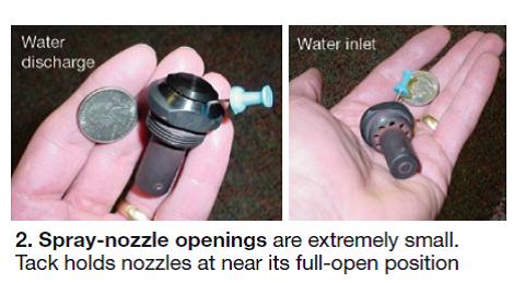

Plugged nozzles. Spray-nozzle openings are extremely small (Fig 2) to ensure effective atomization of the spray water. Tack in photo is holding the nozzle at near its full-open position. What this means to you is that spray nozzles are subject to plugging from even the smallest pieces of debris carried along with the spray water.

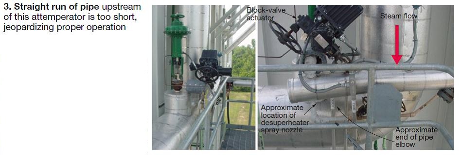

  • Proper installation. The desuperheater supplier typically specifies a straight run of pipe upstream of the attemperator equivalent to two to eight pipe diameters; 12-20 diameters downstream. Fig 3 illustrates a desuperheater installation with an insufficient run of straight pipe upstream of the spray nozzle.

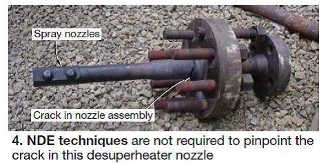

  • Remove the desuperheater nozzle assembly from the steam line. Inspect the nozzle assembly for cracking using visual and NDE (non-destructive examination) techniques (Fig 4). A thermal fatigue crack like the one photographed should not be a surprise in plants where the desuperheater cycles excessively. Realize that every time the valve opens, the nozzle assembly goes from about 950F (temperature of steam in the pipe) to 350F (spray water) virtually instantly.
