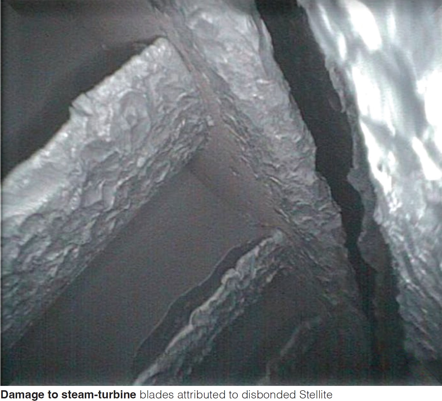

Widespread occurrences of failure in such cobalt-alloy hardfacings became evident after 2010. Valves manufactured from Grade 91 materials revealed subsurface cracking at the fusion line. Such interfacial cracking, also called “disbonding,” “liberation,” or “delamination,” can propagate where sections of the hardfacing detach (photo). Chunks of Alloy 6 hardfacing material have been found in the perforated screen of strainers in steam turbines.

After cobalt-alloy delamination became widespread, many power stations reported similar findings discovered in ultrasonic tests (UT), across valves in service for as little as 10,000 hours, but mostly approaching 80,000 operating hours.
Consequences became so severe that the Electric Power Research Institute (EPRI) established a program to investigate cobalt-alloy disbonding. Findings are presented in the table.

EPRI’s investigations focused on the metallurgical structure of the base metal and cobalt-alloy interface boundary layers. These boundary layers were found to contain a brittle intermetallic sigma phase, formed at the fusion line between the base metal and cobalt-alloy weld material.
This undesirable brittle phase forms over time during exposure to elevated temperature. Then during thermal cycling, cracks can initiate at these locations and propagate along the plane of the fusion line.
Keeping iron dilution below 10% and using a nickel-alloy 82 “butter” layer between the base metal and the cobalt-alloy hardfacing has been a big step forward. Time has shown this decelerates delamination but does not eliminate it completely.
